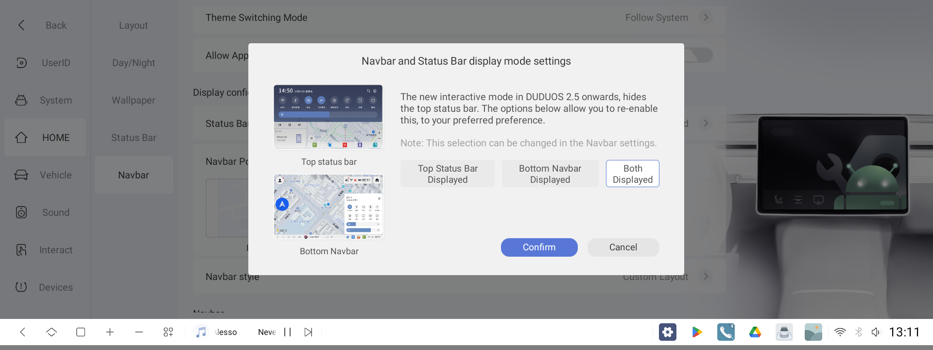

              Verema You can get notifications, but not in real time if you enable FYT Navbar (the upper one) in the settings. But this only on 7870.
