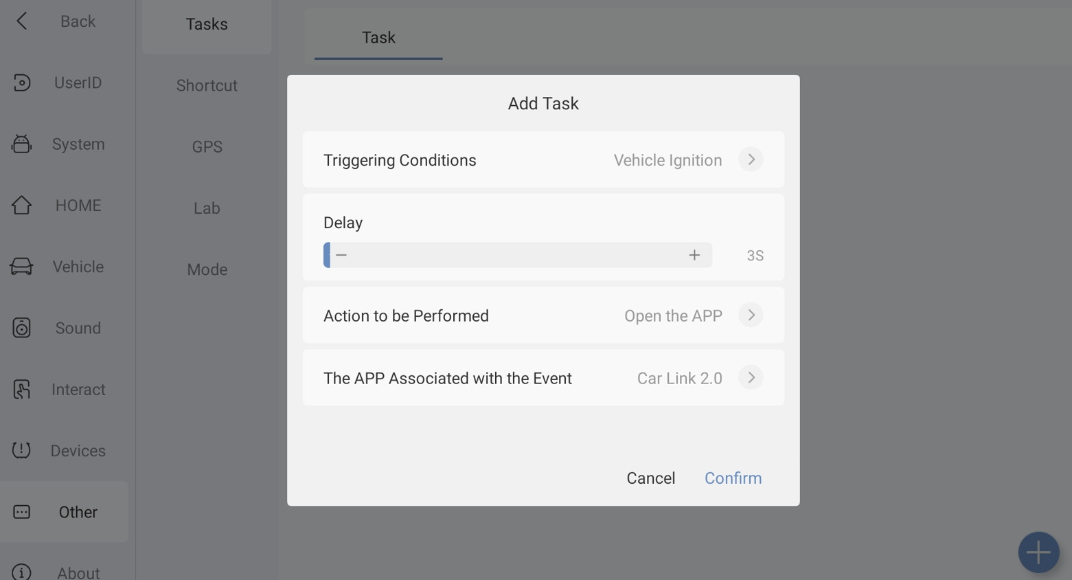

    Setup>Other>Tasks
    Some applications can also be set here Setup>Vehicle>Start Set>App Start Settings>Select App to Auto Start on Bootup.

        johnyfalco
        Setup>Other>Mode>Current Mode: Expert Mode
        Open this option first.

        caolz Yes, but unfortunately "CarLink" is not one of them.
        caolz Some applications can also be set here Setup>Vehicle>Start Set>App Start Settings>Select App to Auto Start on Bootup
        Yes, but unfortunately "CarLink" isn't one of them.
