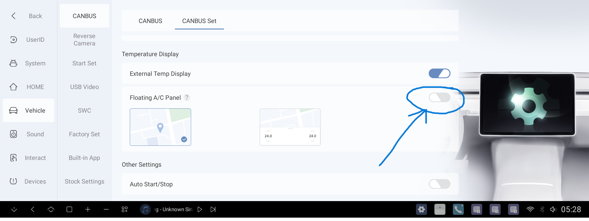

                  caolz is there a way to shut that feature off. I don't like it taking up half of my screen every time I need to change my ac
                    moaz3019 Yes there is. Settings-Vehicle-Canbus-Canbus set-Floating panel, uncheck the toggle in the photo.
                      MihaiFlorin got it. Thank you so much!
