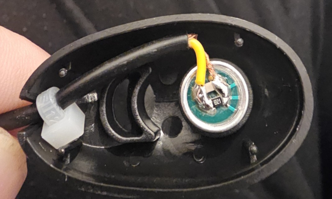

DUDU-Meng The active microphone I mentioned requires a 12V power supply. I previously encountered an issue where modifying the car's built-in microphone and connecting it to the DUDU7 caused a humming noise. Its microphone module requires a 12V power supply.
I've connected the OEM VW microphone and it works very well. Needed a separate phantom power feed as well though. While the VW microphone needs 5V, the Dudu7 only provides something between 2.5-3V. I have very clean call quality. The Dudu7 noise cancelling also works well. People can hear I'm hands free but cannot hear I'm in a car. Call quality doesn't suffer from road surface, speed, etc, it's all neutralised. So OEM microphones can work very well but need adaptation and in your case I think someone supplied dirty power.
