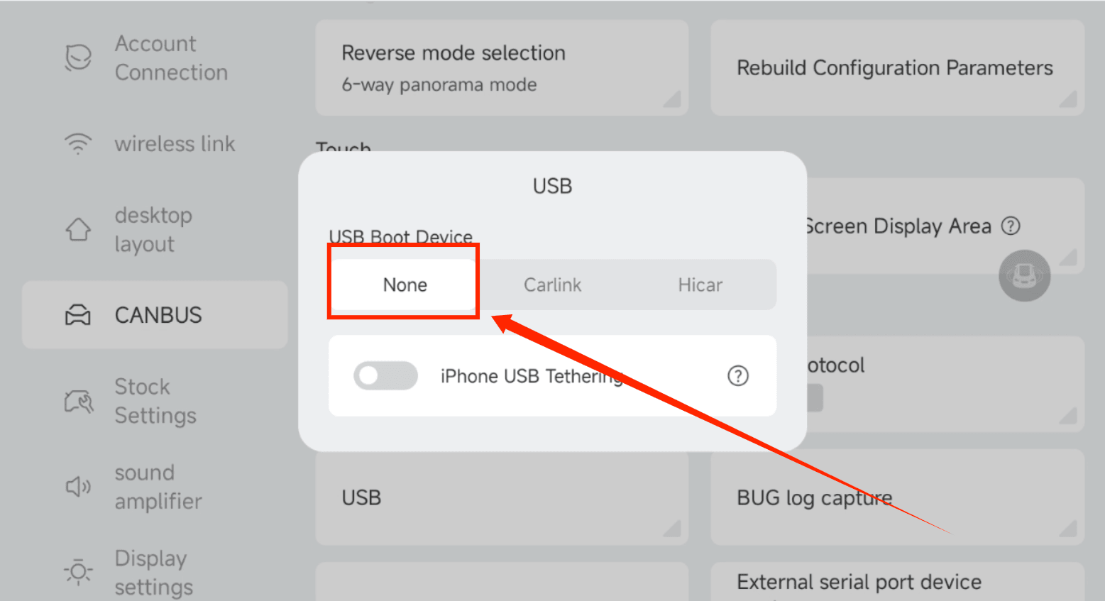

The line diagram is very clear. Is the problem that your USB does not read data in use or after upgrading the system? DUDU7 also has a type-c interface, which should be usable. You can test it. If available, you can upgrade MCU and software. I will send these files to you via private message.
In addition, you need to check whether the factory setting - password: 108- USB startup setting has checked the carlink. If you have selected it, please cancel it. The wired carplay will monopolize the USB and cause the USB interface to fail to read data.
