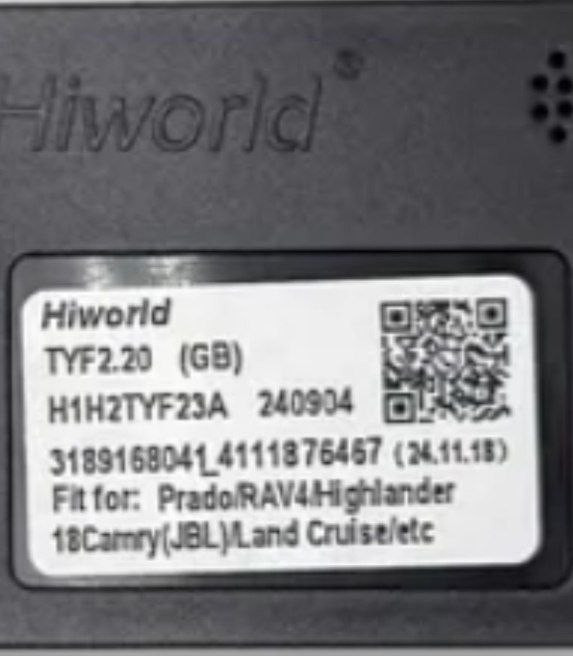

CAN decoder: HiWorld TYF 2.20 (GB), H1H2TYF23A-260317.

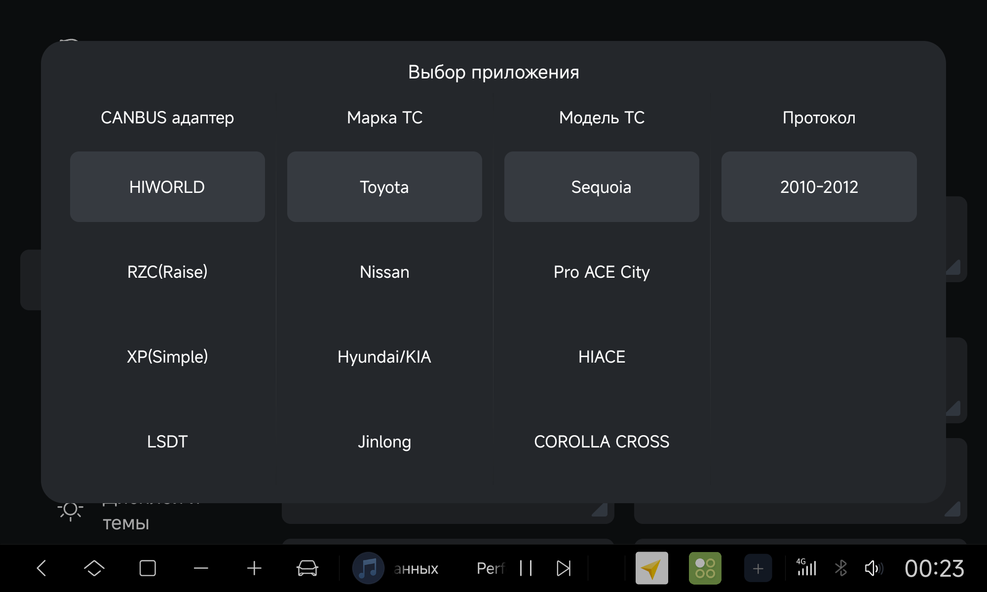

Selected profile: Hiworld → Toyota → Sequoia → 2010–2012, ID 7405862.

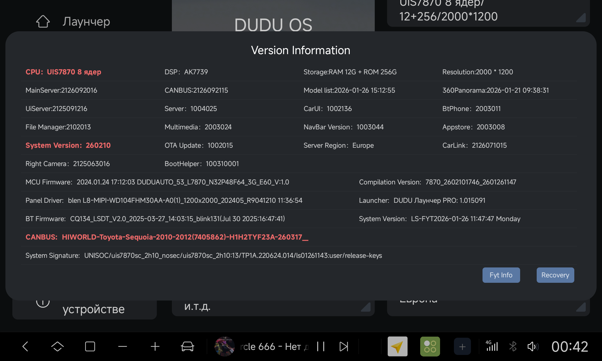

Installed software:
- OS version shown: 2026.02.10
- DuDuOS Base: 1.004025
- Dudu Launcher Pro7870: 1.015091
- com.syu.ms: 26.0920D, versionCode 2126092016
CANBUS is selected as the priority speed source, but I cannot obtain working CAN speed in DUDU.

Static analysis of my installed com.syu.ms indicates that profile 7405862 maps to protocol 294 / variant 113, using module.canbus.r. Its U2 handler processes packets 0x32 and 0x1A but does not extract these speed fields.
However, com.syu.ms also exposes raw packets through callback 1019, so DUDU Base may have a separate decoder. Please check both paths; I am not assuming the issue is exclusively in com.syu.ms.
Could you confirm whether this profile is supported for CAN speed and advise which compatible software update or fix is needed? My goal is to make vehicle speed available to navigation software, not just display GPS speed.
