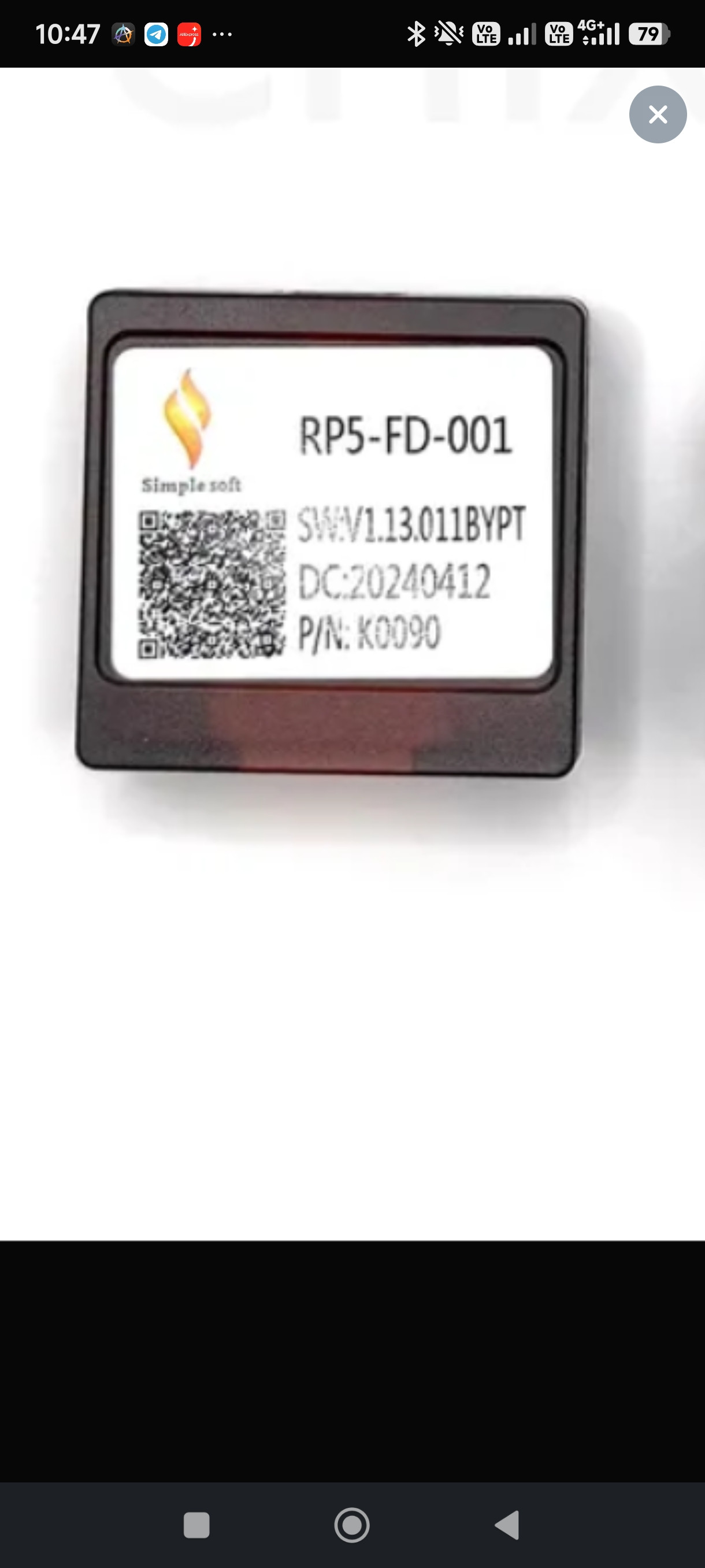

I need technical help or advice regarding a newly purchased CANBUS adapter for my car and DUDU7 head unit.
My Setup:
- Car: Ford Mondeo 4 (Pre-facelift / Pre-styling, Year 2008, Euro-spec, Built in Belgium).
- CANBUS Box: SimpleSoft FD-SS-01A / Profile in settings:
XP(Simple)-Ford-Mondeo-XP(174).
- Current Firmware: V1.13.011BYPT (Pre-installed from the factory, all new adapters ship with this version now).

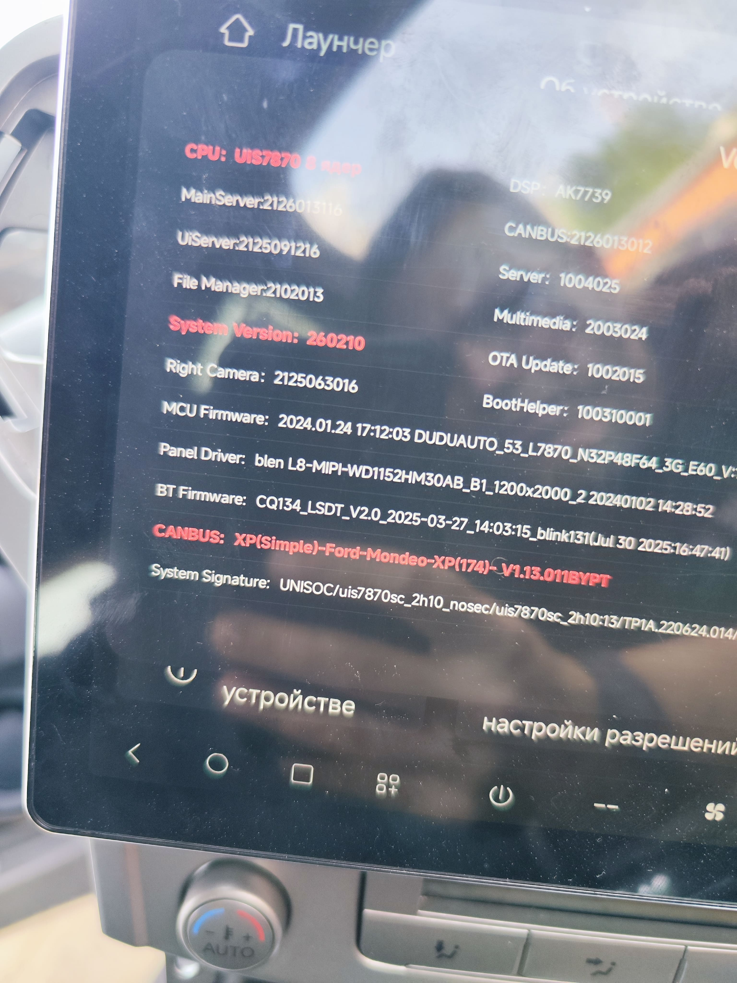

Right now, the adapter does not work properly with the Mondeo 4 profile. The steering wheel buttons do not detect automatically, and no vehicle data (like factory parking sensors or climate control) is displayed on the screen.
However, the CANBUS box is physically alive and the wiring is correct, because some features work under specific conditions:
- The reverse gear trigger works perfectly (the rear camera turns on automatically when I shift into reverse).
- The steering wheel buttons can be manually mapped through the head unit's button learning app.
- If I change the car profile in the factory settings from Mondeo to Ford Focus 2, the climate control data overlay actually shows up on the DUDU7 screen. However, I cannot control the climate from the screen, and the factory parking sensors (parking radar) are completely missing.

After doing some research on automotive forums, I read that this new V1.13 firmware completely breaks protocol compatibility with older pre-facelift Mondeo 4 models (2007–2010). The manufacturer modified the digital bus ID-codes to optimize it exclusively for the facelifted Mondeo 4 (2011–2014), which uses different BCM modules. According to other owners, the pre-facelift Mondeo strictly requires the previous V1.11 or V1.12 firmware version to function properly.
Since the DUDU online update server only offers V1.13, I cannot downgrade it through the standard menu.
- Does anyone have a backup or a download link for the older V1.11 or V1.12 firmware file (usually a
.bin file) so I can perform a local USB downgrade?
- Or is there any way the DUDU development team can adjust the CANBUS protocol parsing for Mondeo 4 pre-facelift in the next DUDU OS update?
