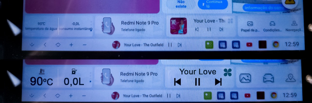

    One suggestion is to make better use of the widget area. An example is as shown in the image

      surfer63 The problem is that when you decrease the DPI, the widget enlarges its entire size, becoming very large. My suggestion is to only increase the text inside the widget, as there is a lot of space left inside it. Changing the font settings in Android settings does not bring any significant changes to my mind, as it only allows you to change the font type, but not its size.
