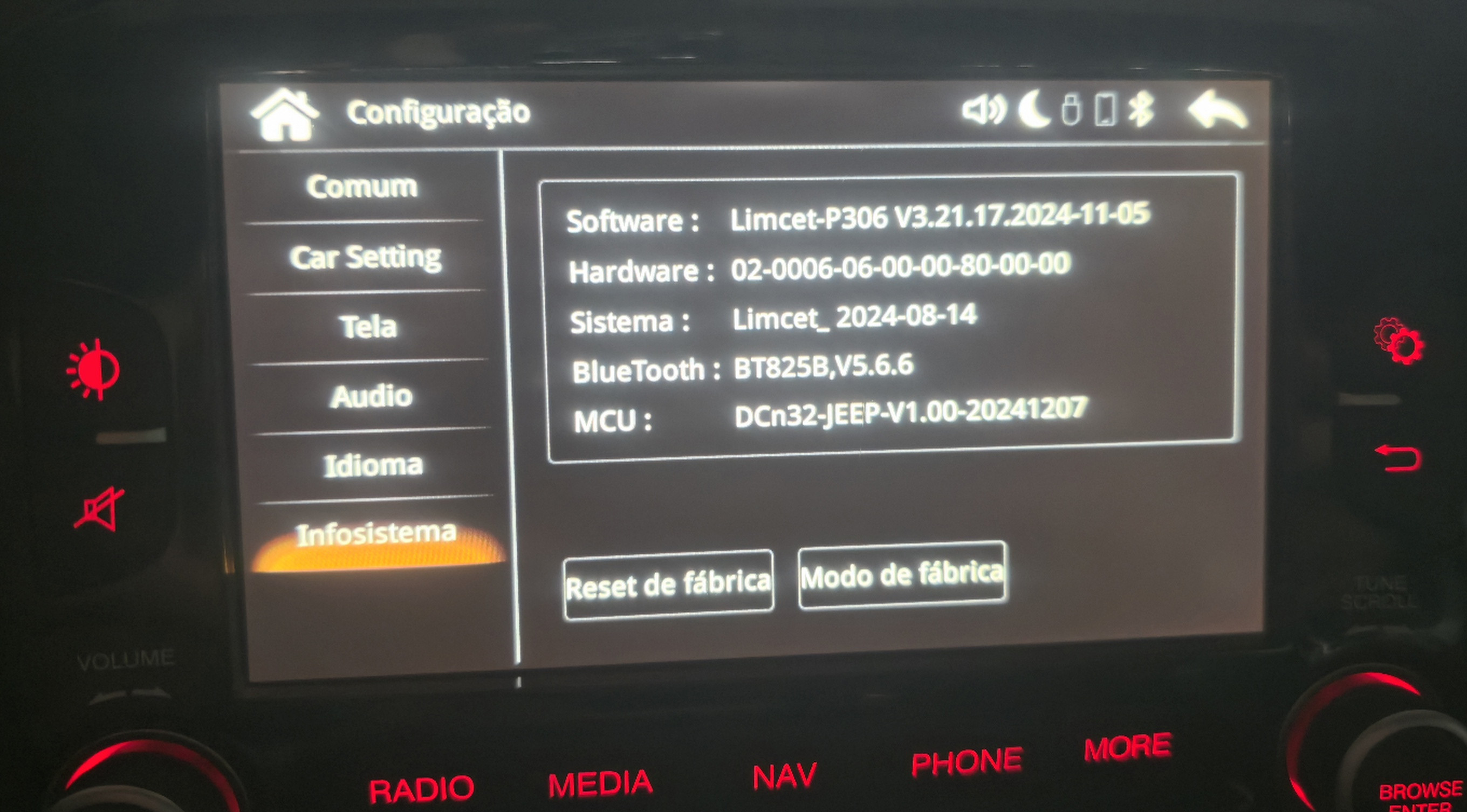

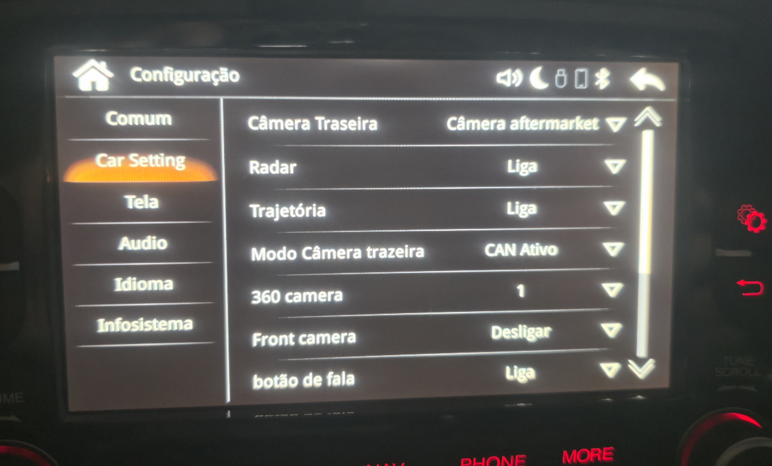

The system is CarPlay/Android Auto from Mekede and it was the factory that sent me the camera. In fact, I have another one just like it to mount on another of my Alfa Romeo Giulietta.

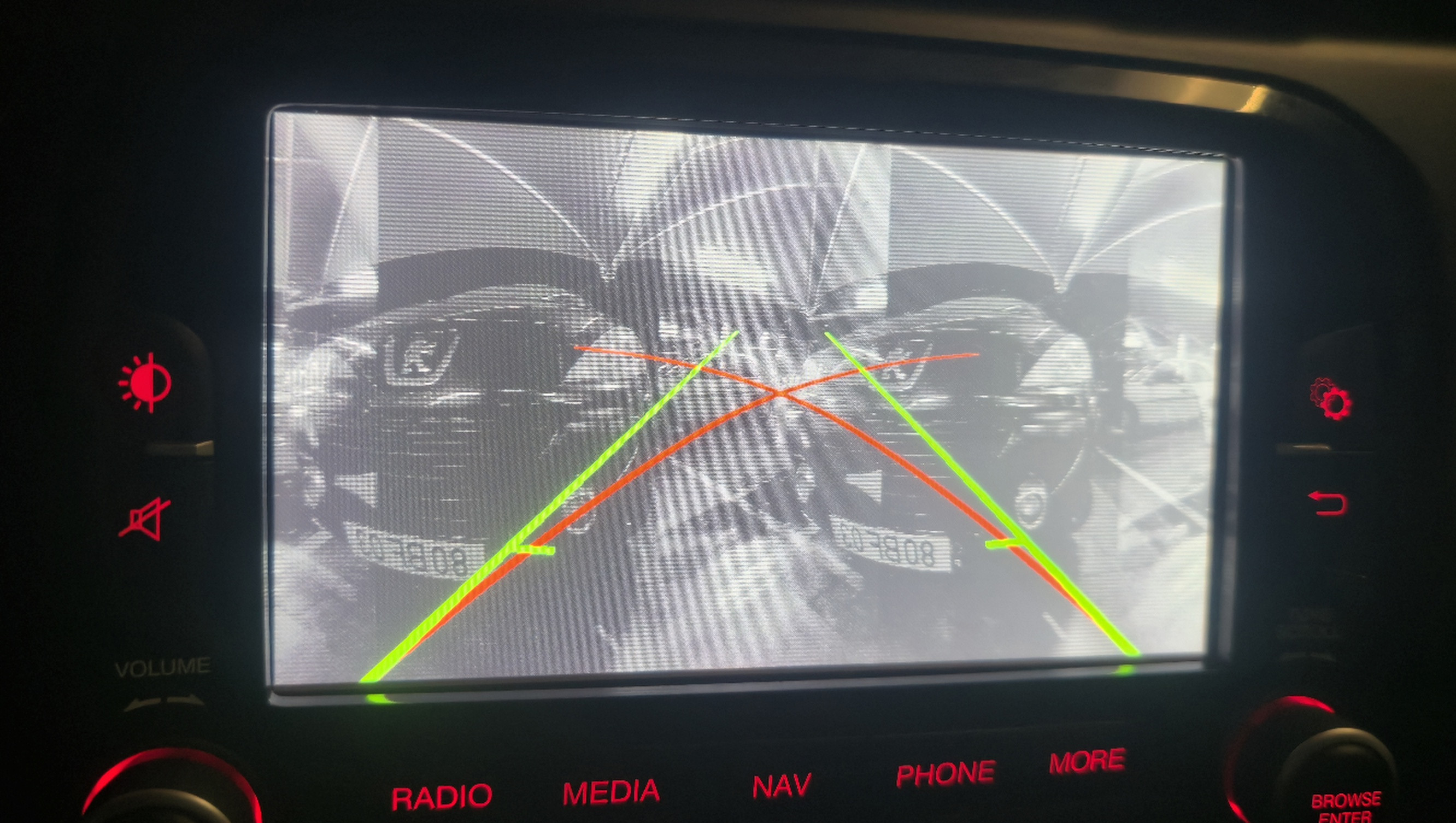

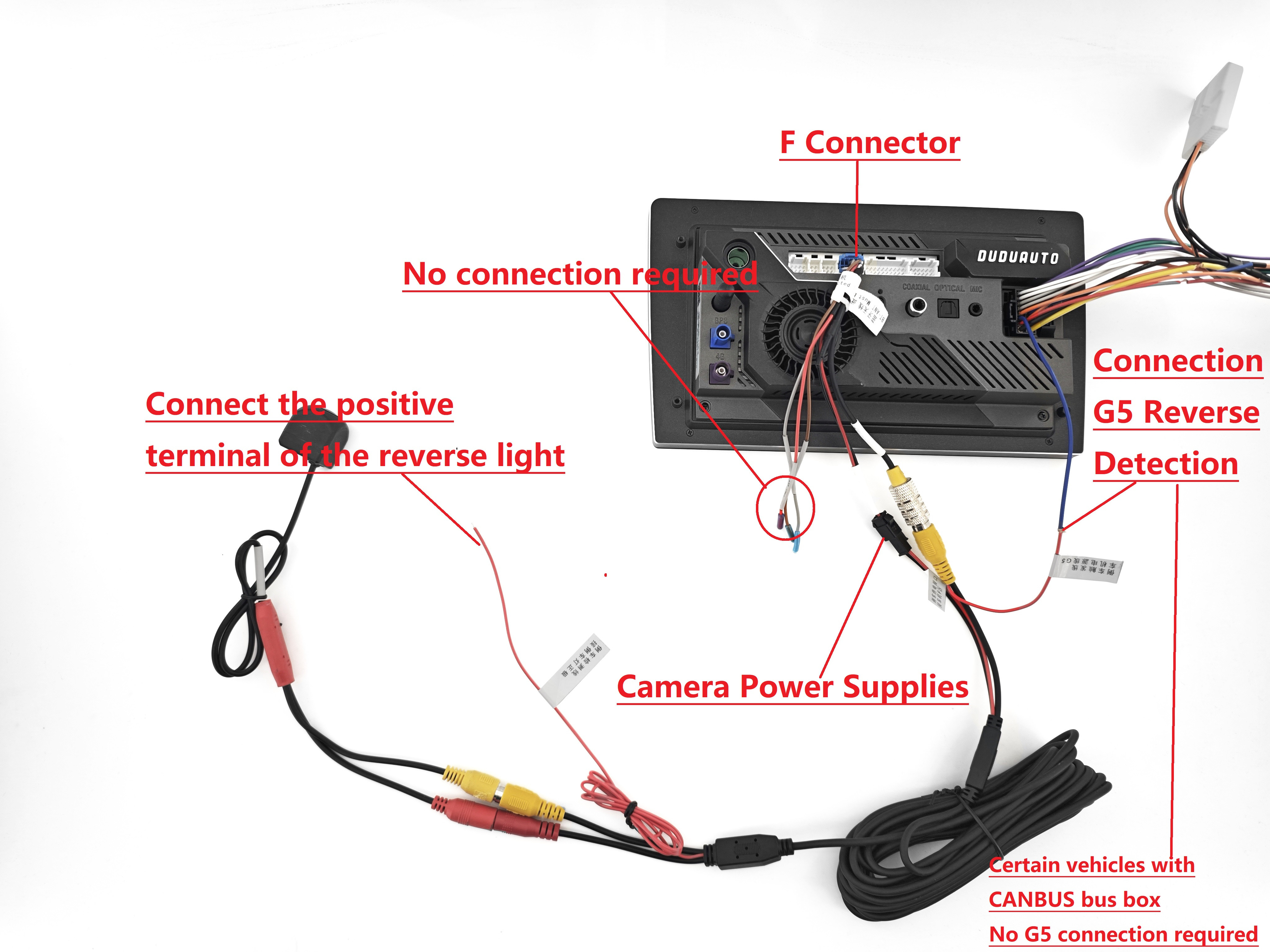

I made connections with G5 and black and red plug. The 12V power connection to the reverse gear, I noticed whether it is on or not, the camera works like this, I posted a photo.
