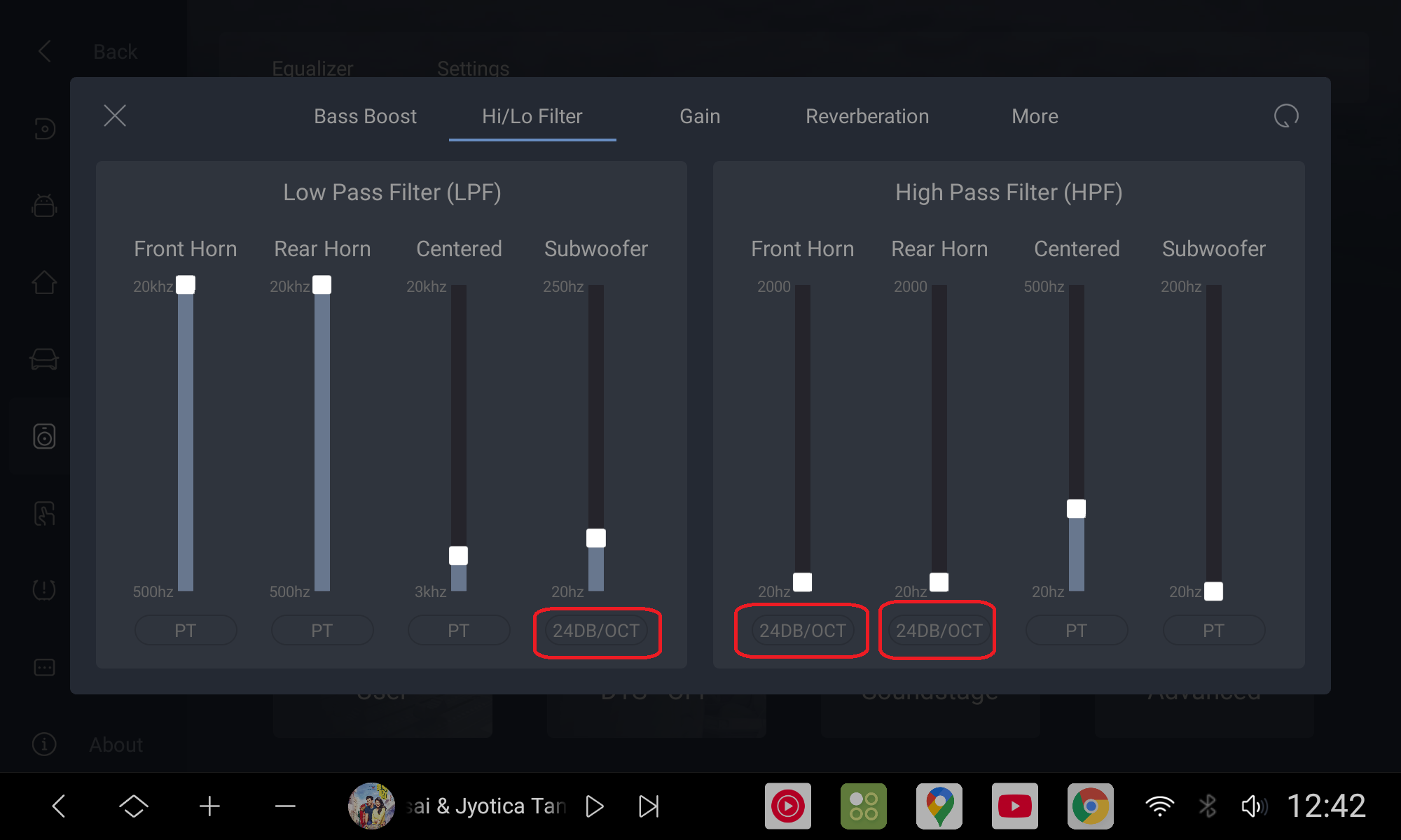

Domingos1 Is it possible to install an external amplifier and a subwoofer on DudoAuto 7? If so, how do I configure it? Thank you.

abidali Domingos1 it's straight forward as in any aftermarket radio. Install amplifier and connect it's RCA leads to the RCA output of the DUDU7. Configure High/Low pass filters and you are done. Make sure to turn off DTS in the sound settings.
Domingos1 abidali You mentioned setting up high-pass/low-pass filters; is that on the radio or the amplifier? Thank you very much for your help.
abidali Domingos1 if your amplifier has the option to set its output as Full or Filters to OFF, use crossovers on head unit only. Make sure to select crossover as marked in the picture below.
