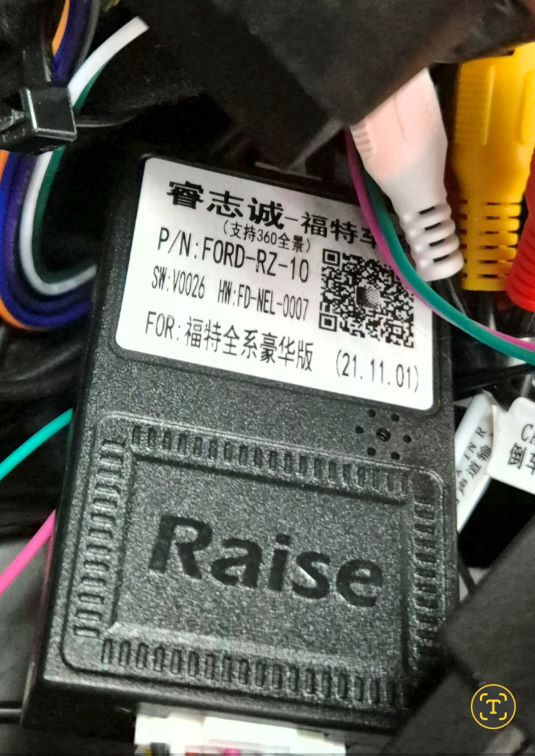

Canbus adapter:
- Raise Ford-RZ-10
- Version printed on the module: 21.11.01

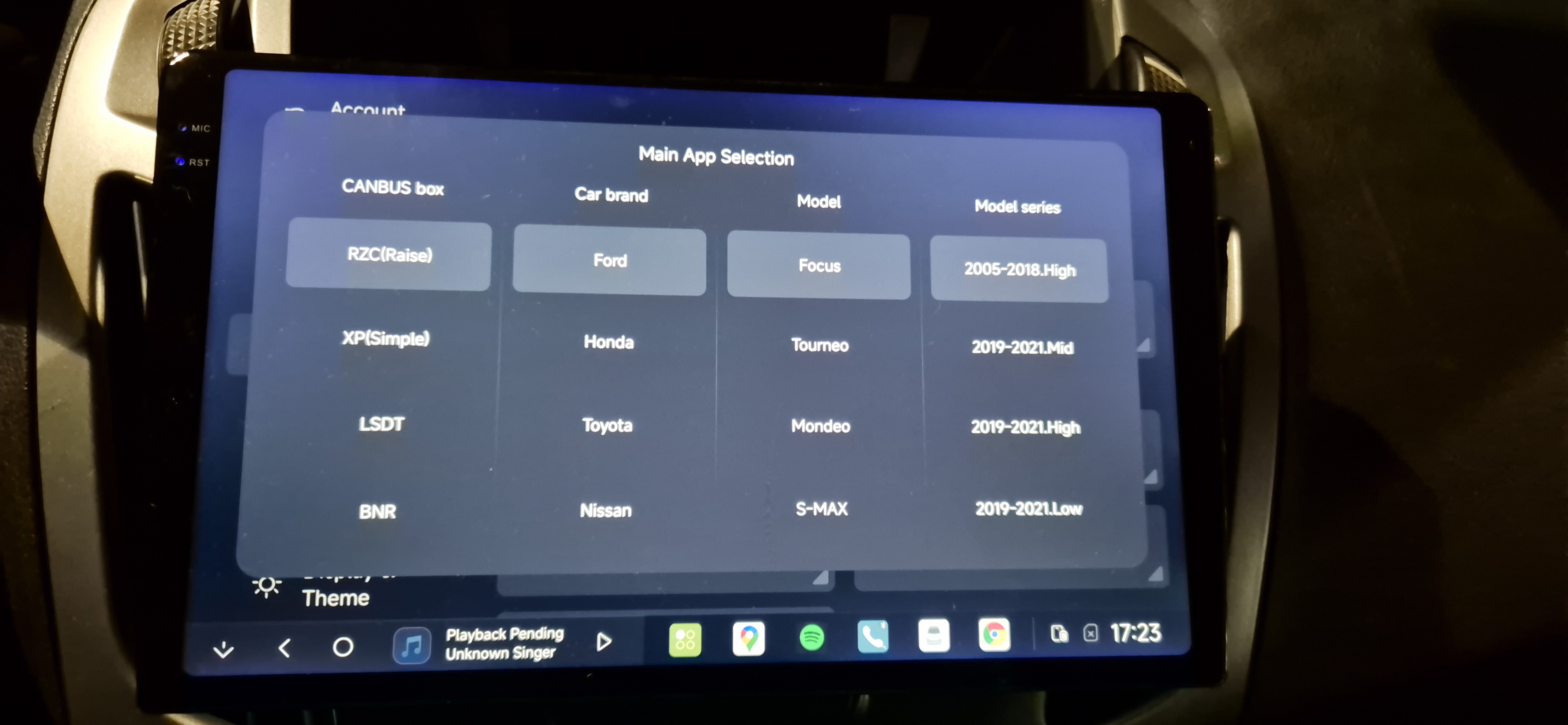

I have also tried different vehicle models in the head unit CANBUS settings. It looks like most Ford mid / high configuration profiles behave similarly — SWC and door opening are working, but the signals listed above still do not appear.
When selecting Ford "Low" model in CANBUS settings, even doors and SWC stop working, so I am currently using a mid/high profile because it gives partial functionality.

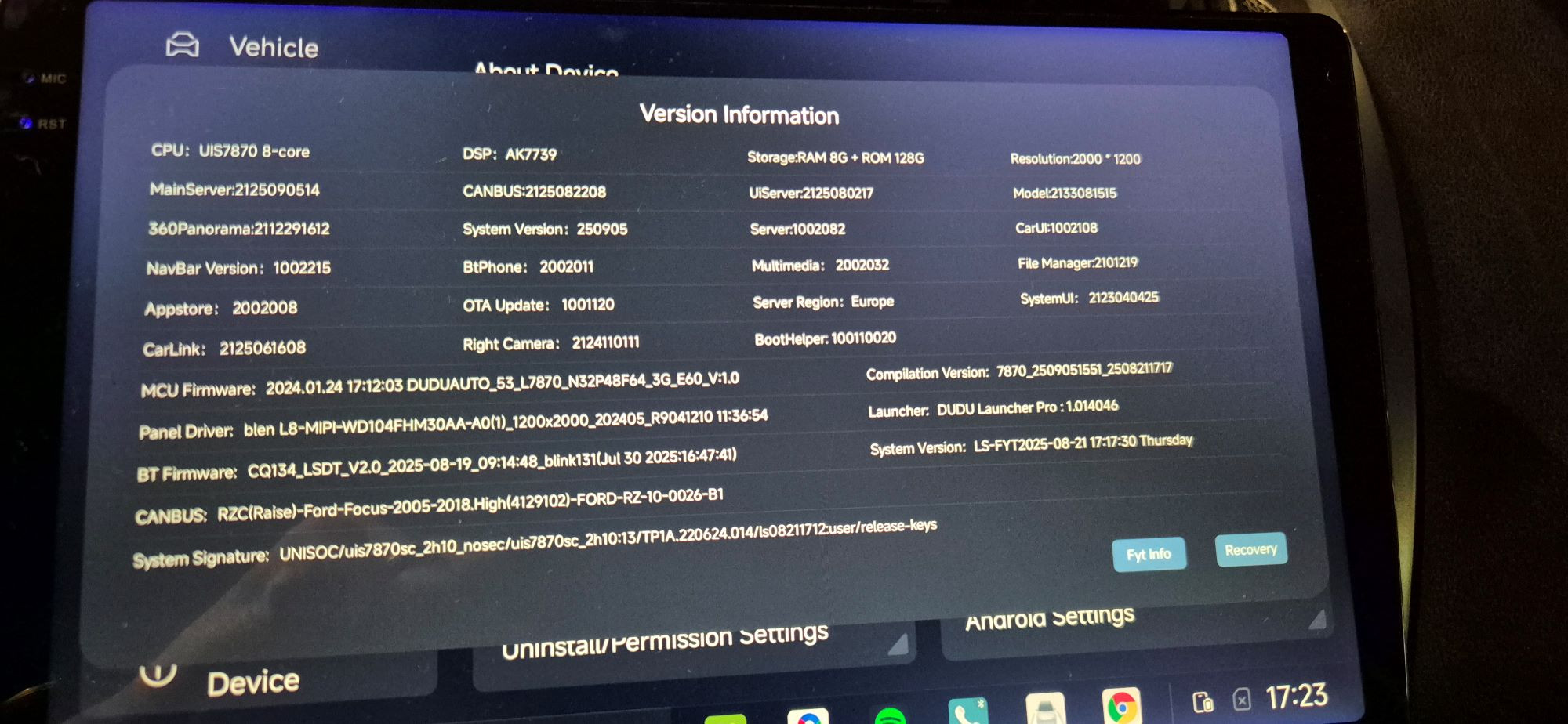

Android head unit version information
CANBUS encoder version:
Current CANBUS settings used on the device

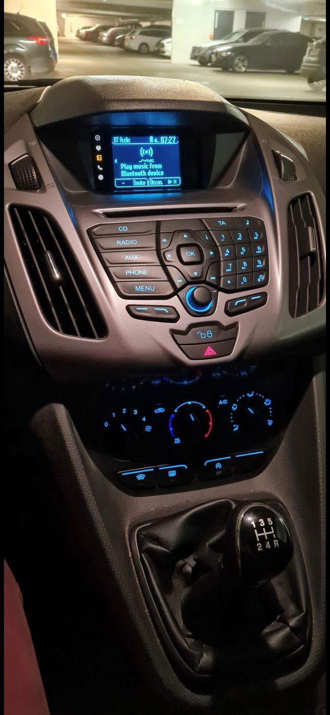

Car center console
I first contacted Raise support via WhatsApp. They mentioned that my CANBUS adapter version might be too old and that it may not be upgradable to the latest firmware. They suggested replacing the CANBUS module with a newer version.
After that, I contacted Mekede sales on AliExpress to ask if they could sell me a newer CANBUS adapter. They requested more details about the problem and said they needed help from DuduAuto engineers to confirm compatibility. Because of this, we agreed that I should create this support post on this forum for further technical assistance and confirmation.
