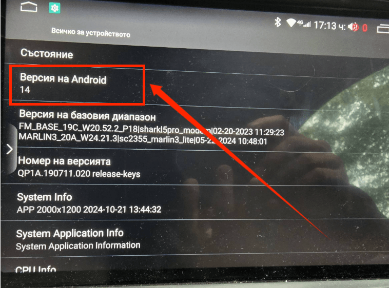

DUDU-Meng Hello,

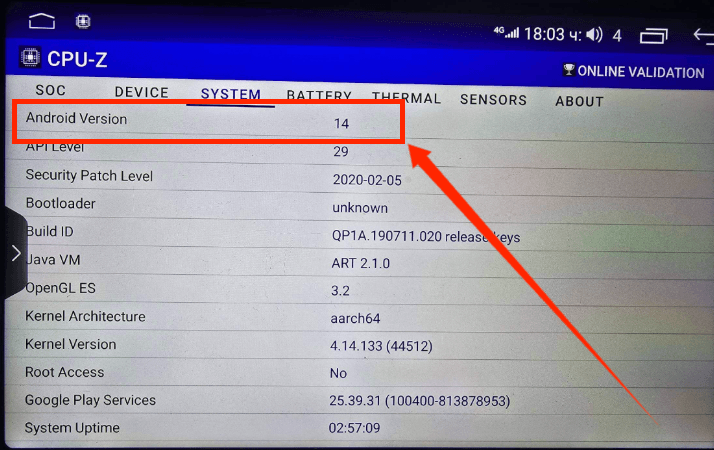

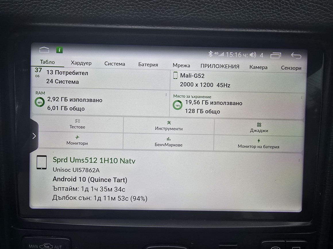

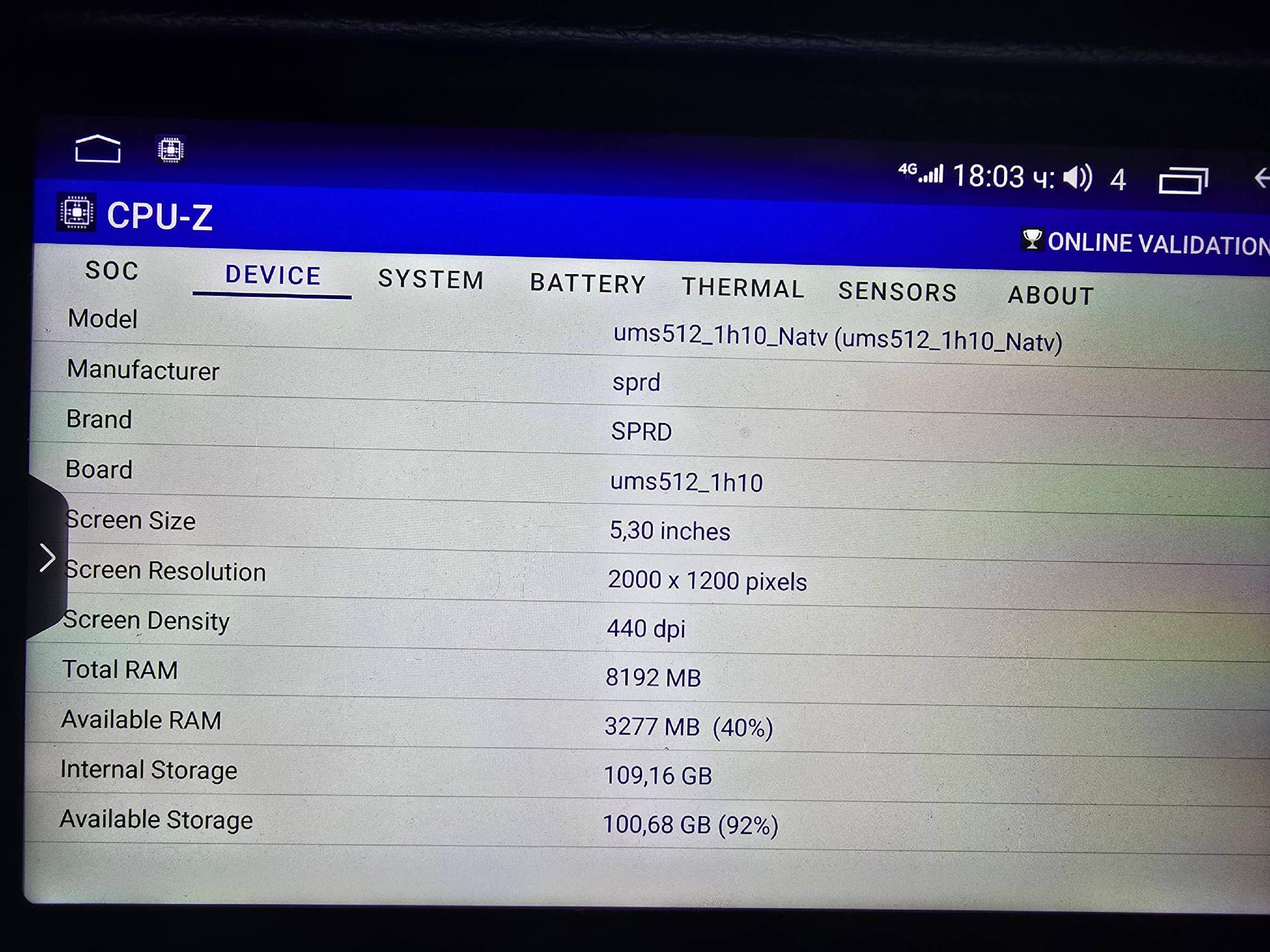

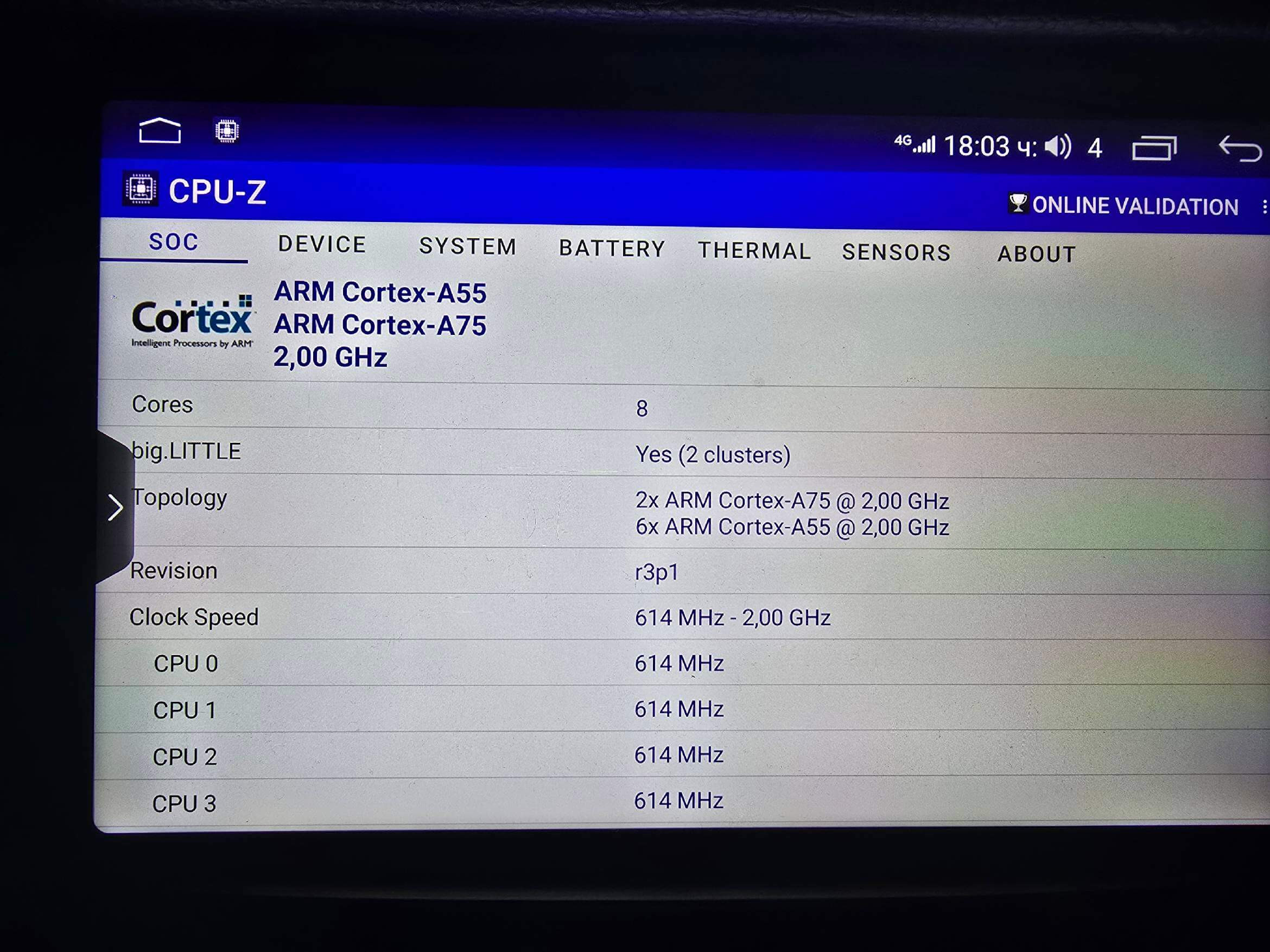

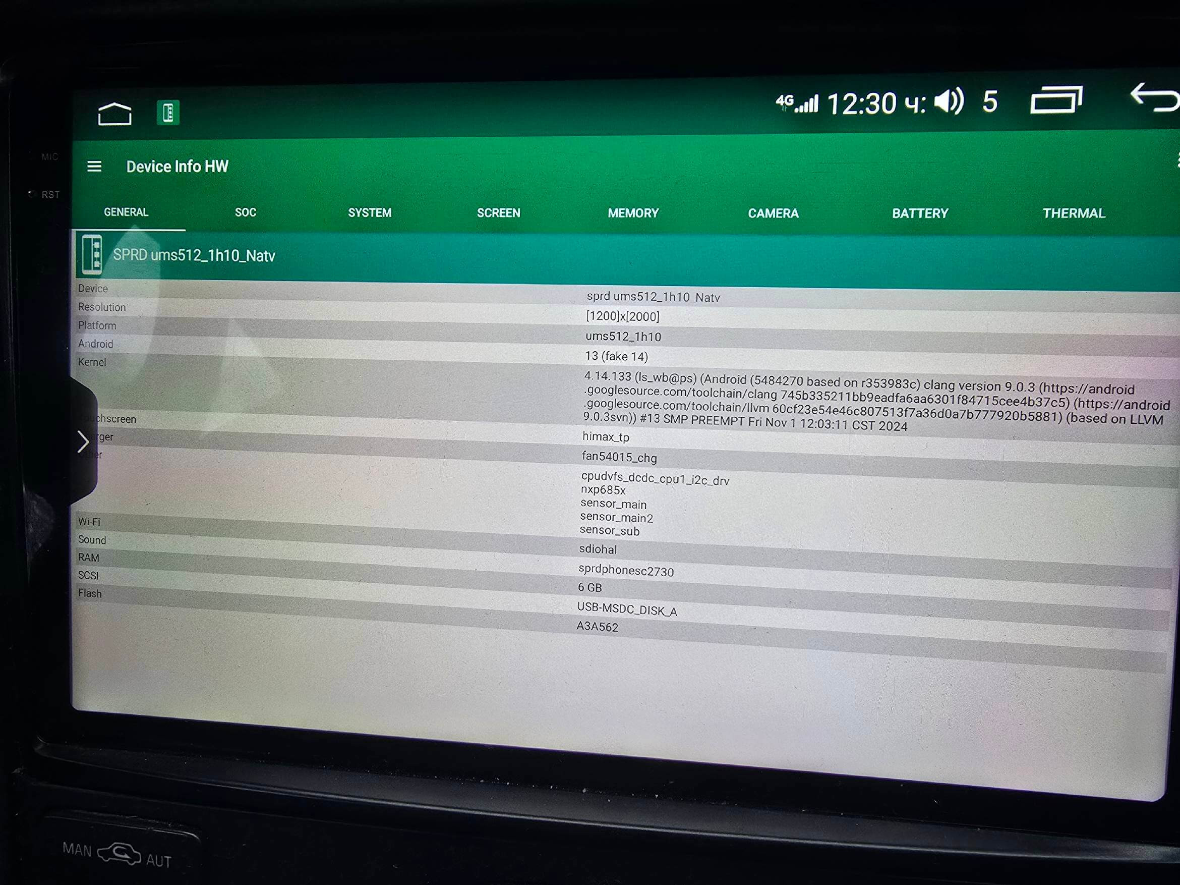

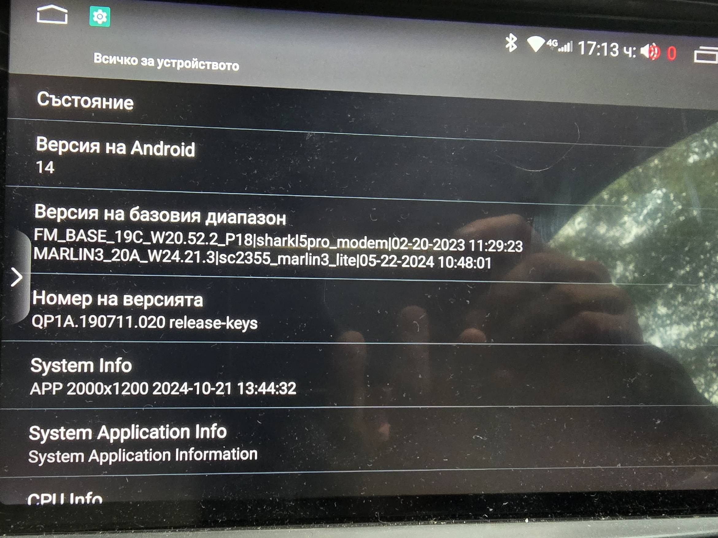

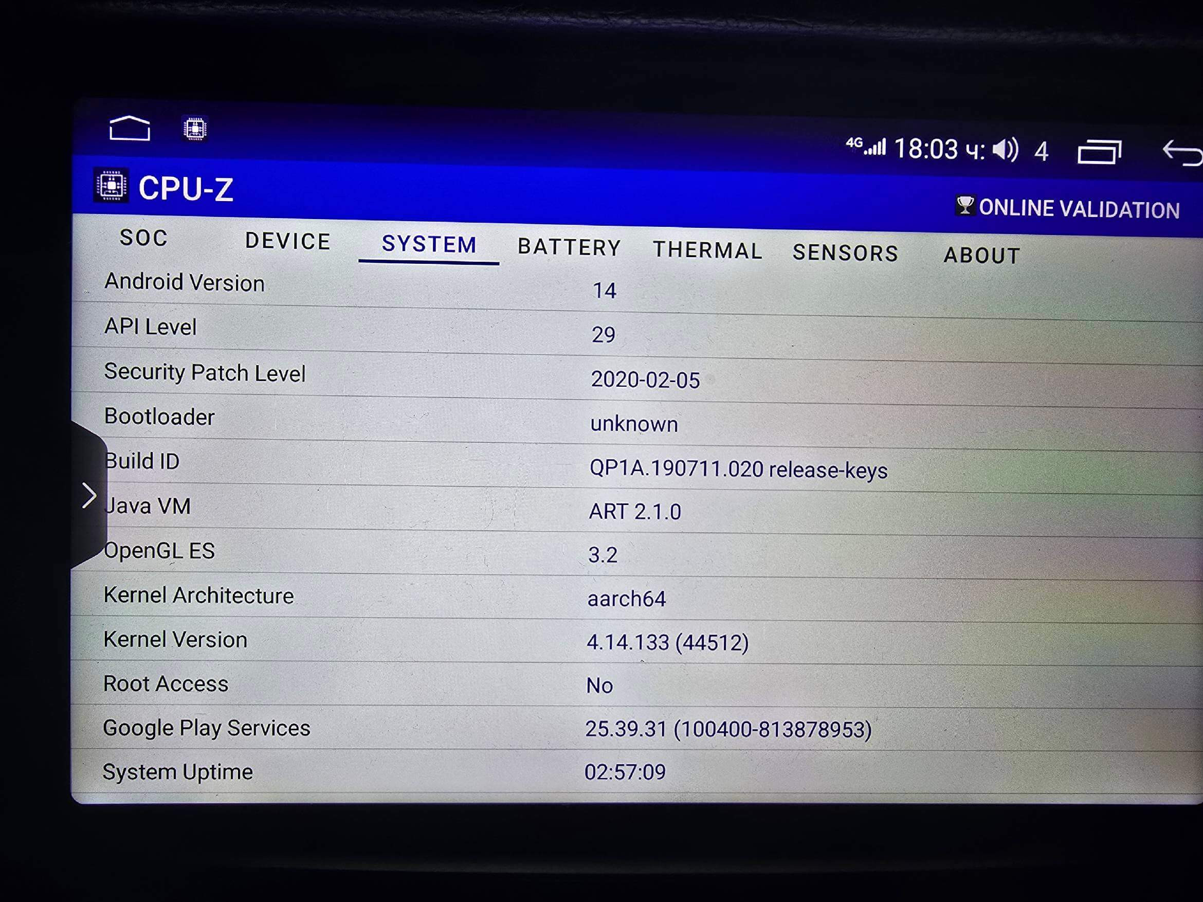

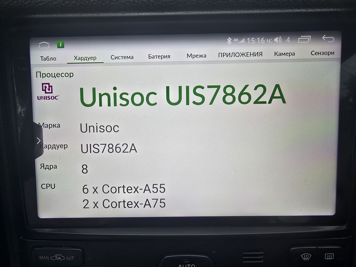

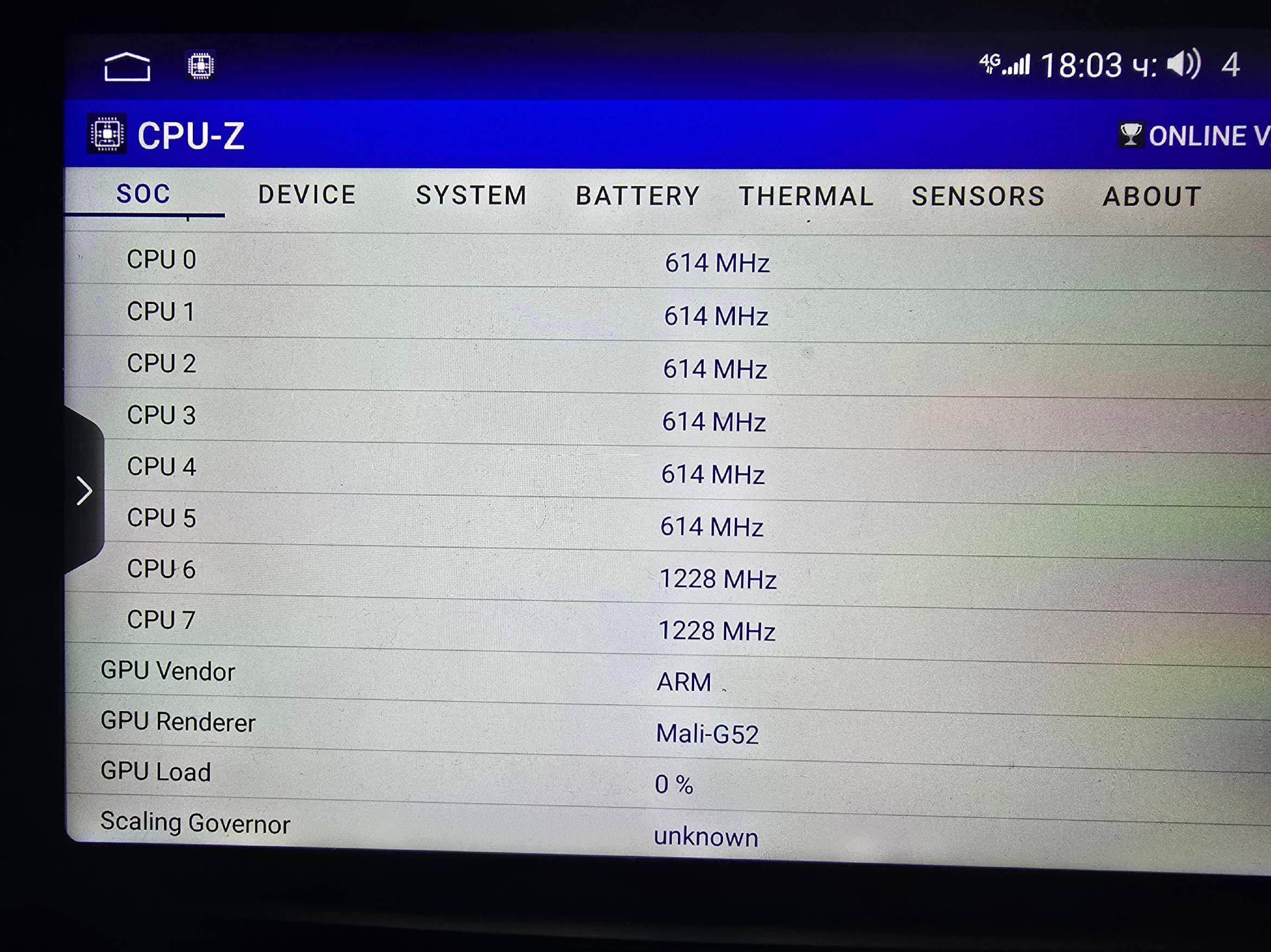

I have checked my device information both from the system settings and using the CPU-Z app.

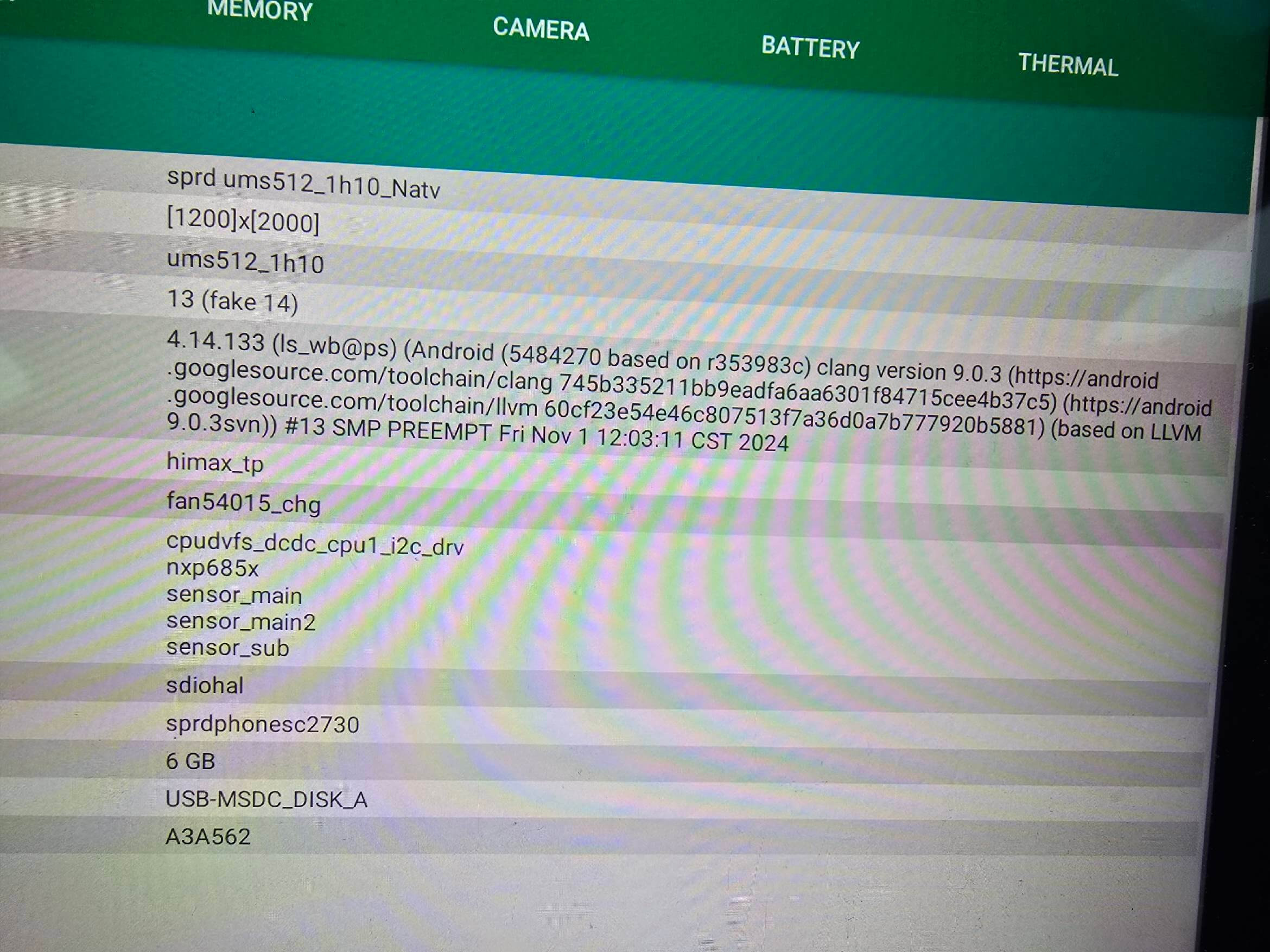

While the system menu shows “Android version: 14”, CPU-Z clearly reports the following details:
API Level: 29
Build ID: QP1A.190711.020 (release-keys)
Security Patch Level: 2020-02-05
Kernel Version: 4.14.133
All these parameters correspond to Android 10 (Q), not Android 14.
Therefore, it seems that the Android 14 label displayed in the system settings is fake or modified, and the real Android version of the unit is Android 10.
Could you please confirm if this is correct?

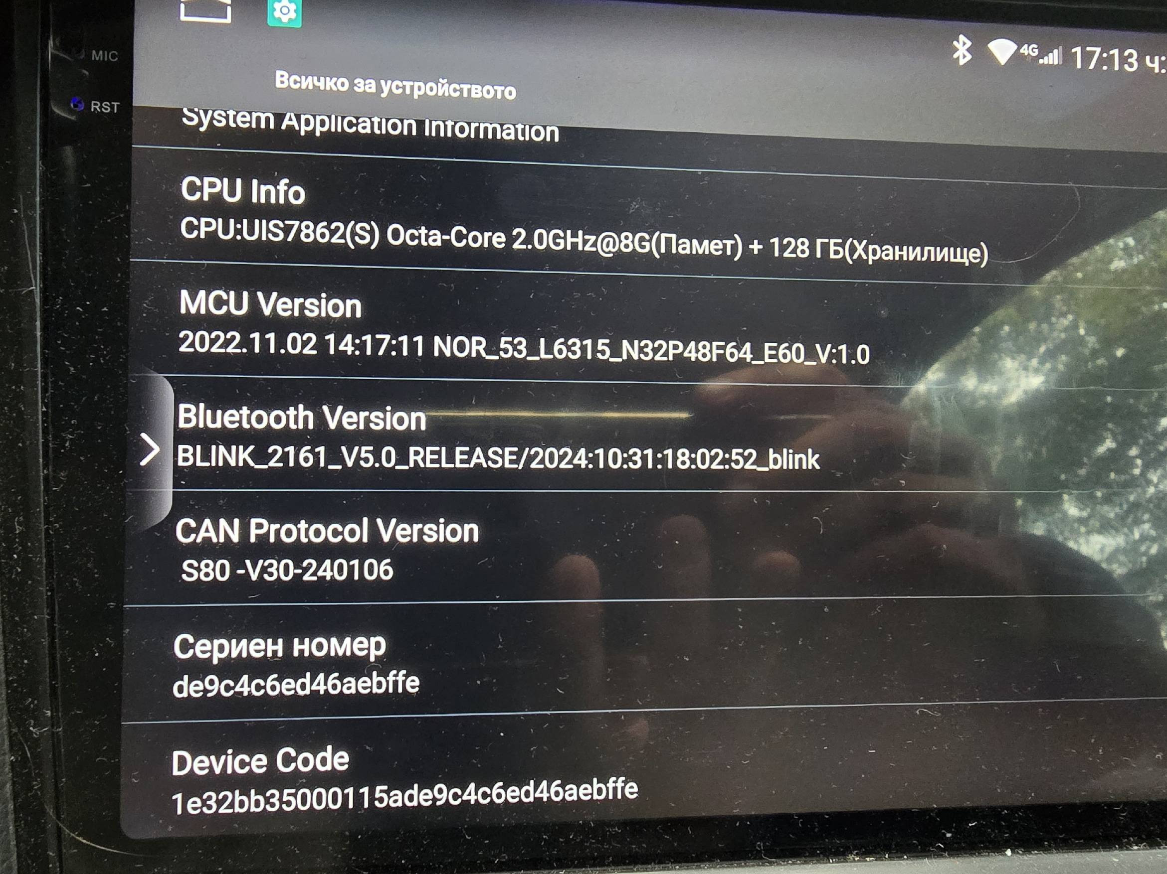

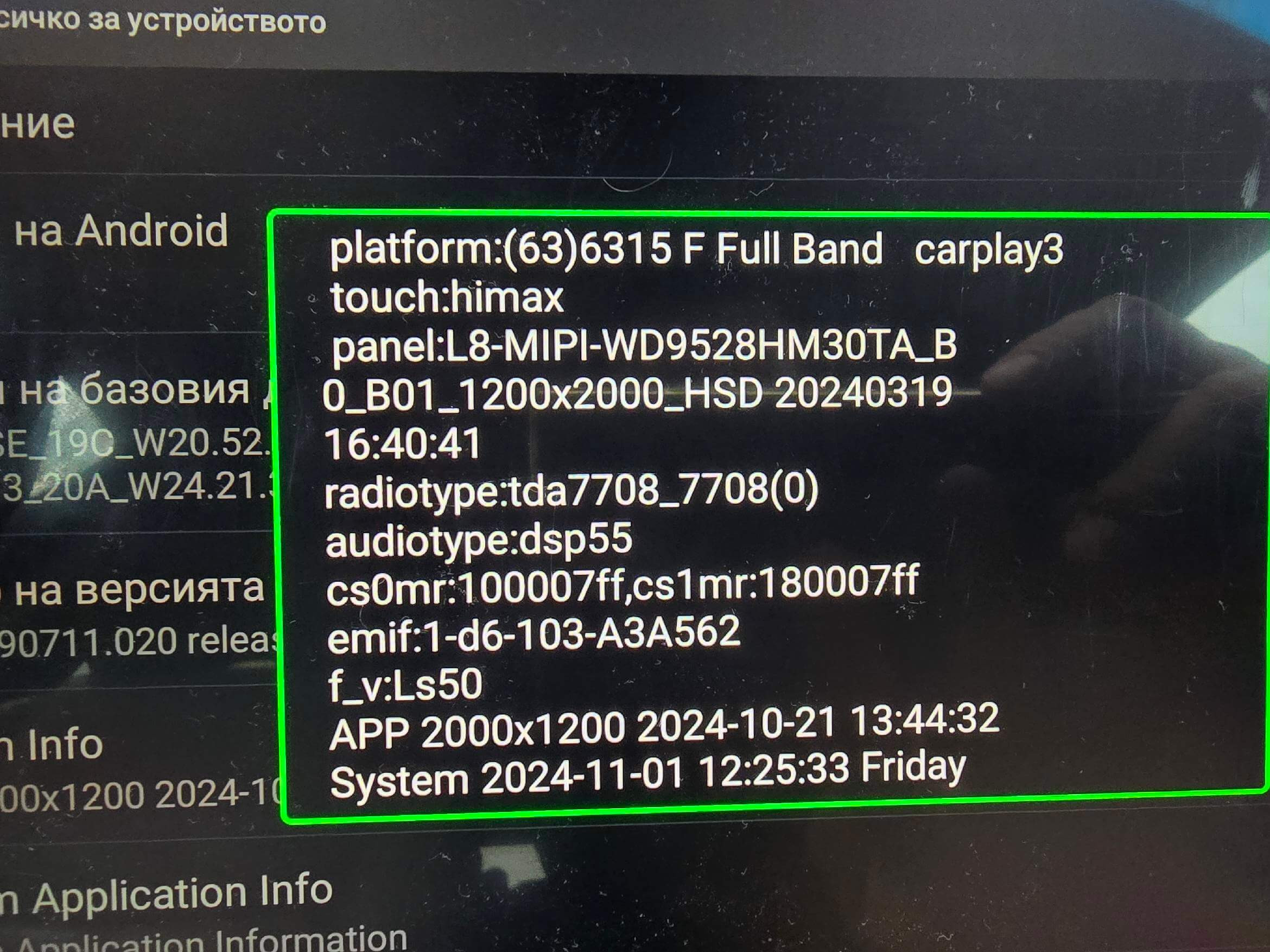

And about the MCU. I noticed the MCU code lacks the "_FYT" suffix (i.e., it is NOR_53_L6315, not NOR_53_L6315_FYT).
Does the absence of the "_FYT" suffix in the MCU code definitively prevent Dudu OS from working, even though the core processor (UIS7862) is compatible?
Thank you for your clarification!
