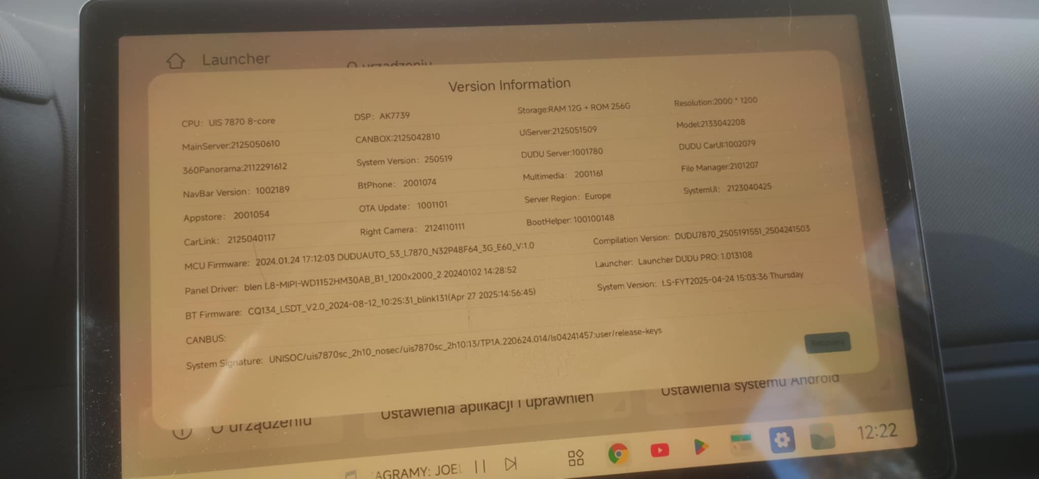

DUDU-Meng AdamS Please upload a screenshot of your system information when describing the issue. Thank you. https://forum.dudu-auto.com/d/1674-important-notice-feedback-on-bugs-must-be-prepared-system-information
AdamS I am adding screenshot but today i went to the car to take the picture and volume bar came to life, yesterday whole day it was missing. I tried to restart the device and do standby switch off and it did not come back. Today i was sure it is still missing and i was surprised it is back again.

DUDU-Meng AdamS Are you still using system version 250519? Please update to the latest version and try again. Thank you.
