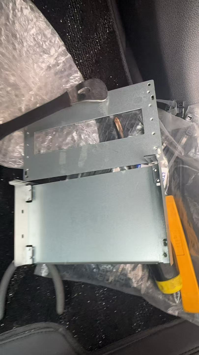

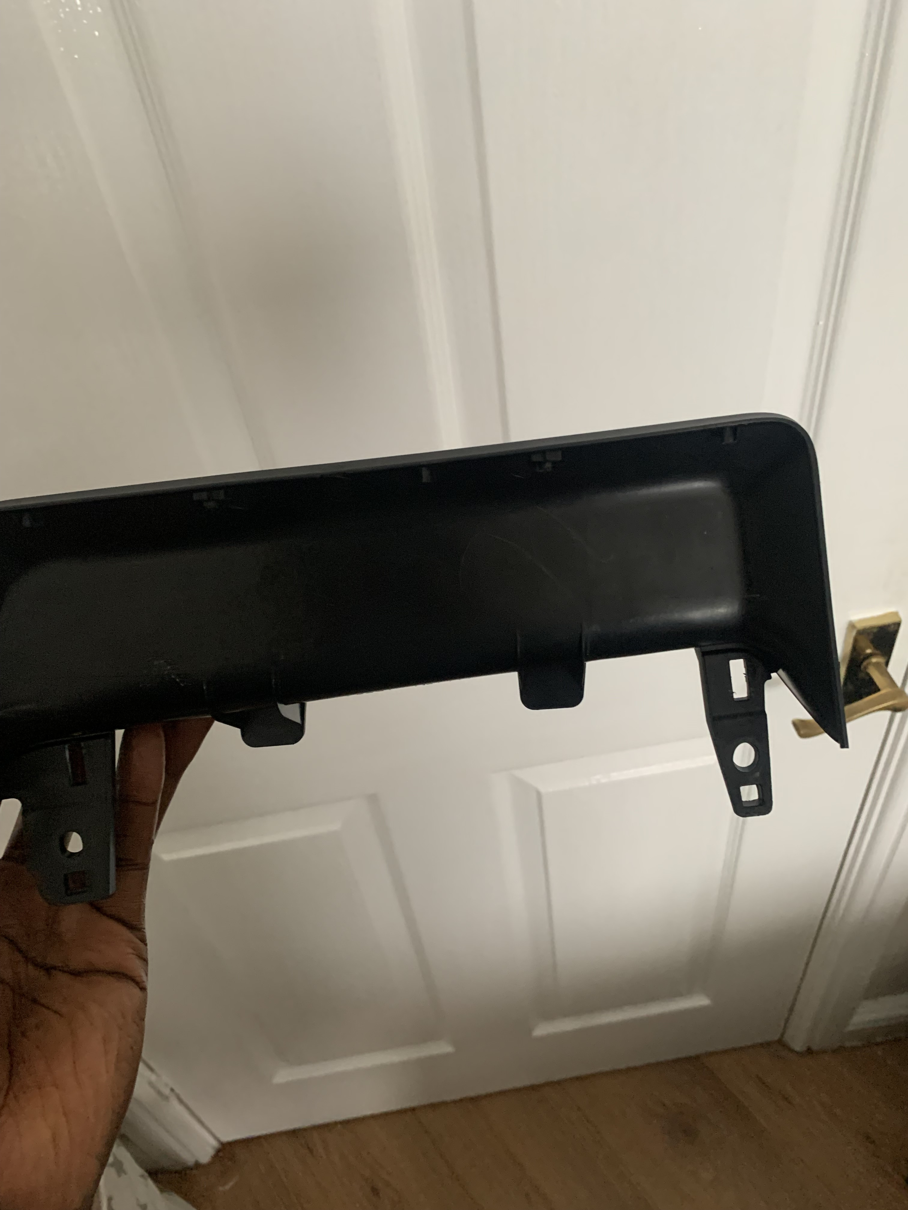

Oyetunde I’m trying to install the Dudu 7 headunit, but I noticed that I can’t install it on my dashboard as the cover panel design can’t accommodate the dudu7 headunit, do you have a modified Toyota c-hr back cover panel that can accommodate the headunit?
benzol I had this problem with my Volvo too, I had to cut the frame to fit the media https://www.youtube.com/watch?v=Vuh7EU0Fh8o
dudu-lai Oyetunde The device needs to be changed to a single DIN style so that it will not be blocked by the trim. You need a bracket. Please consult DUDU sales.
