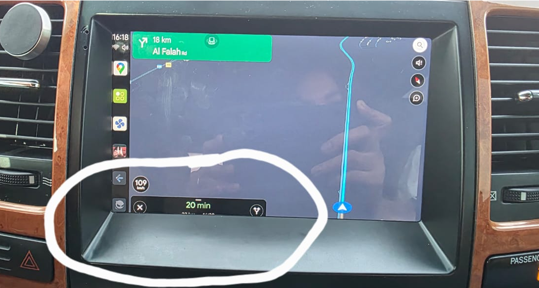

Pauldudu7 Is it posible to adjust the borders under setting in the DUDU7 as you can see from the picture that the frame is too small and missing information from the display.
kataraman Open Setup-->Vehicle-->Factory Settings(108 password)-->Adjust Screen Display Area You can adjust the borders you want from there.
