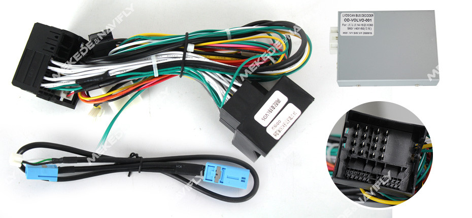

Alex83 Have LVDS/CAN BUS DECODER OD-OLO-001 For:14-18 XC60 V40/V60(带屏) 14-19S60 HW:GV1 SW:V8 250928.. now i got a other problem my pip dosent work in unit it says "dual pip conflict dual pip is disabled by default"
dudu-lai Alex83 The CANBUS box has a yellow RCA video plug, connect it to the video input 1 of the device A interface. Then click AUX to view the OEM system

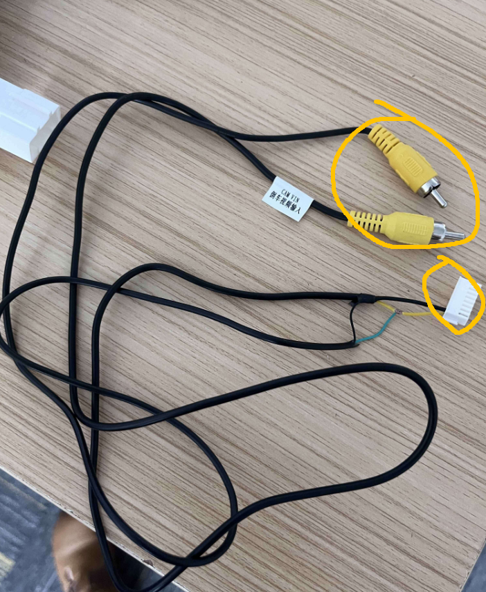

Alex83 I have done that the main harness have 2 yellow sockets i connected canbus cvbs ut to main harness cvbs out where do i find me aux?
