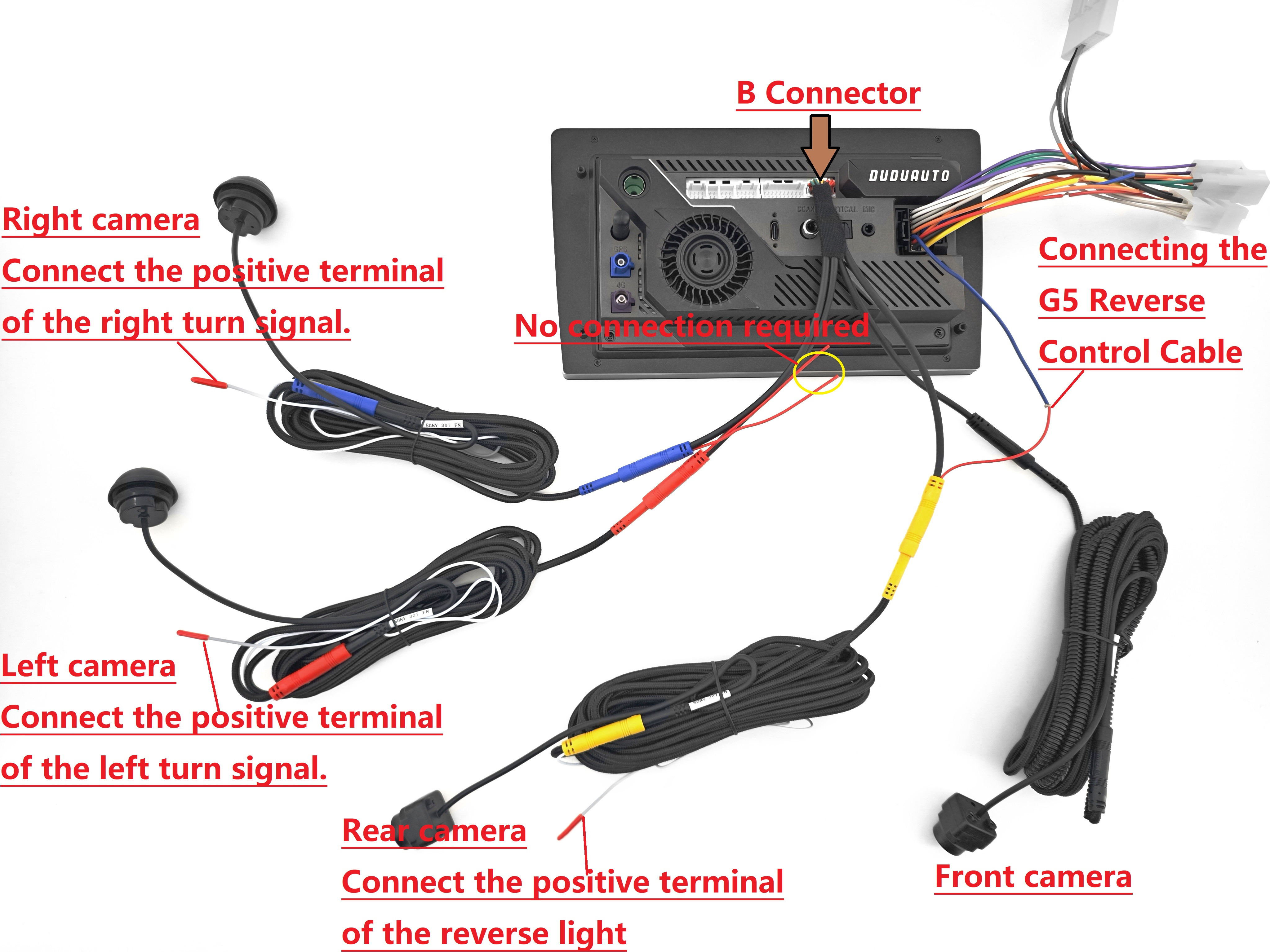

Lovemysaab Whether or not the three trigger lines are connected will not affect the camera's operation, as the camera is powered by the device. The trigger line is only for when you operate the turn signal or R gear, the 360 will automatically switch to the corresponding viewing angle
