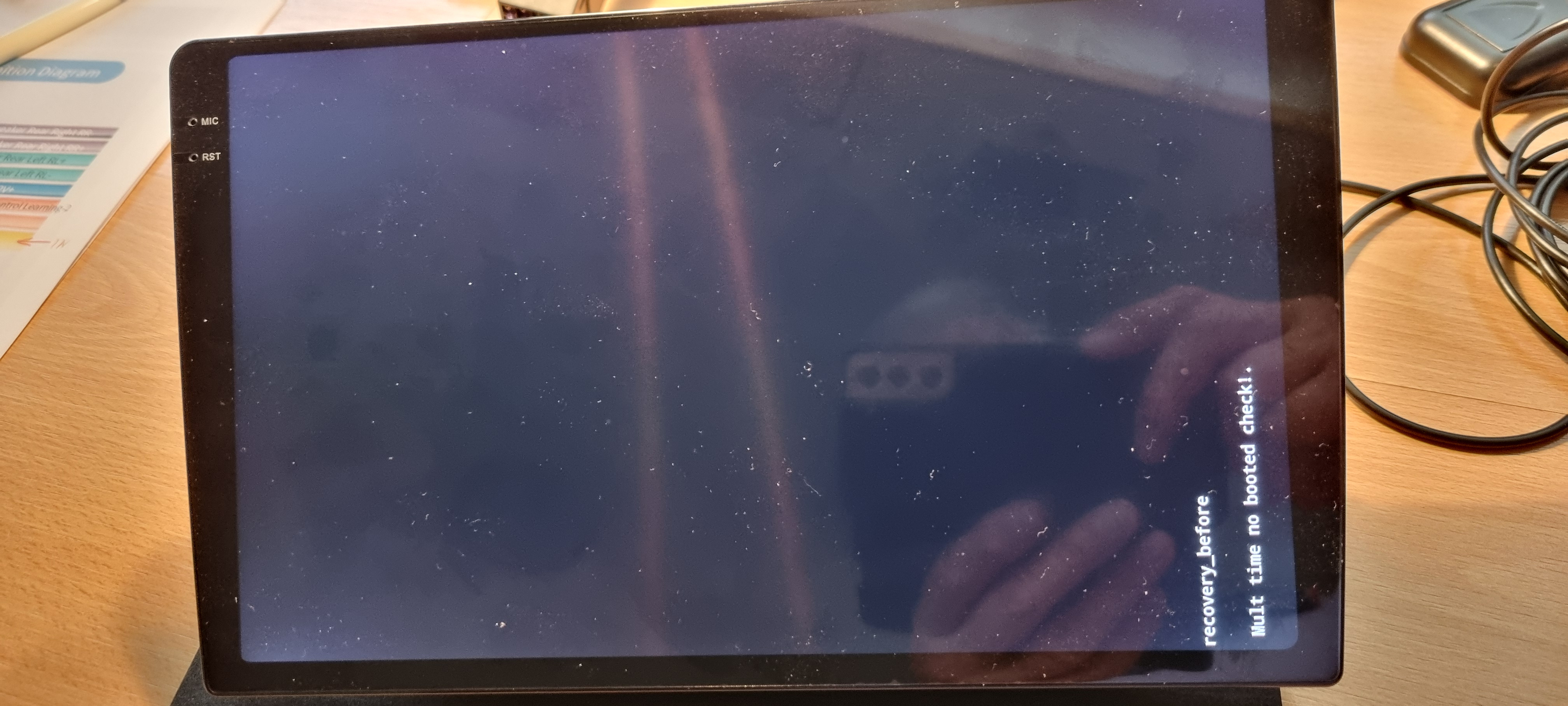

II have a new DUDU7, 8 x 128. I powerup the HU on my desk with an external powersupply.
Via OTA I managed to install 3.6E and the Bluetooth update. So far so good.
But then I believe the power supply hampered. It could be that several boot attempts did not complete. Anyhow the HU does not complete the boot process anymore. Initially it ended up with text on the screen: “recovery_before” “Mult time no booted check1”.
Subsequently I prepared a USB stick with the installation files of 3.6E. However installing was not successful. The installation process starts, but always after 100 seconds, the progress bar is the about 25%, the HU boots, and starts installing from the beginning again. After four attempts the HU stops.

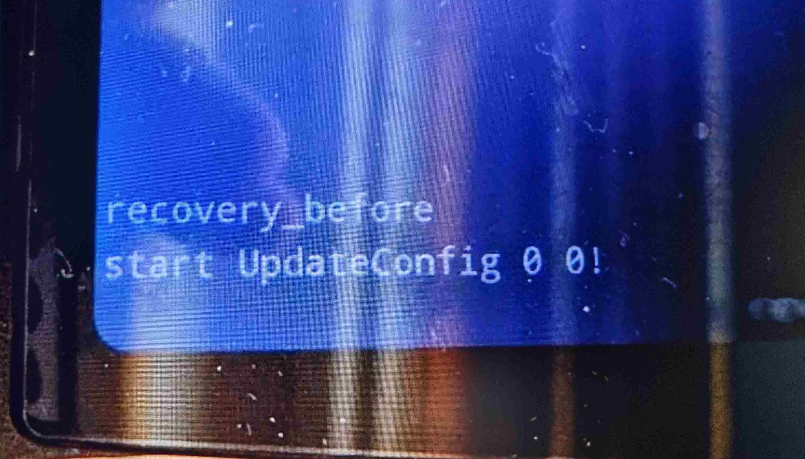

During these boots a message is very shortly displayed:
“recovery_before” ”start UpdateConfig 0 0!”
I tried 2 different USB sticks and installation with and without “Factory Reset” files. But with no success. So is there a solution?
