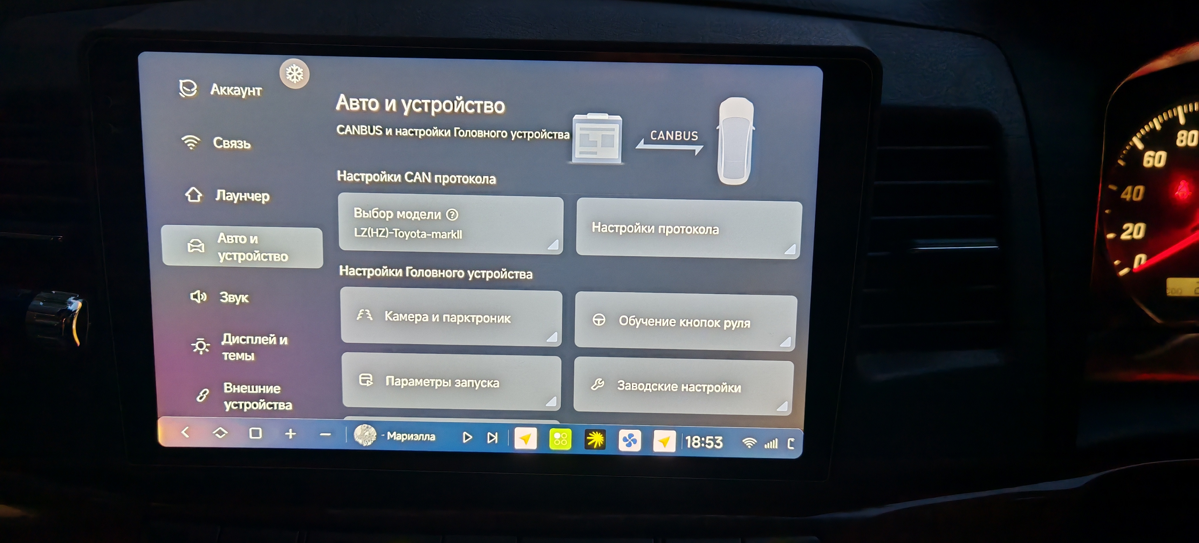

Fantom38 Приветствую.Пытался переустановить магнитолу. ПОДКЛЮЧИЛ canbus.Управление печкой неработает.

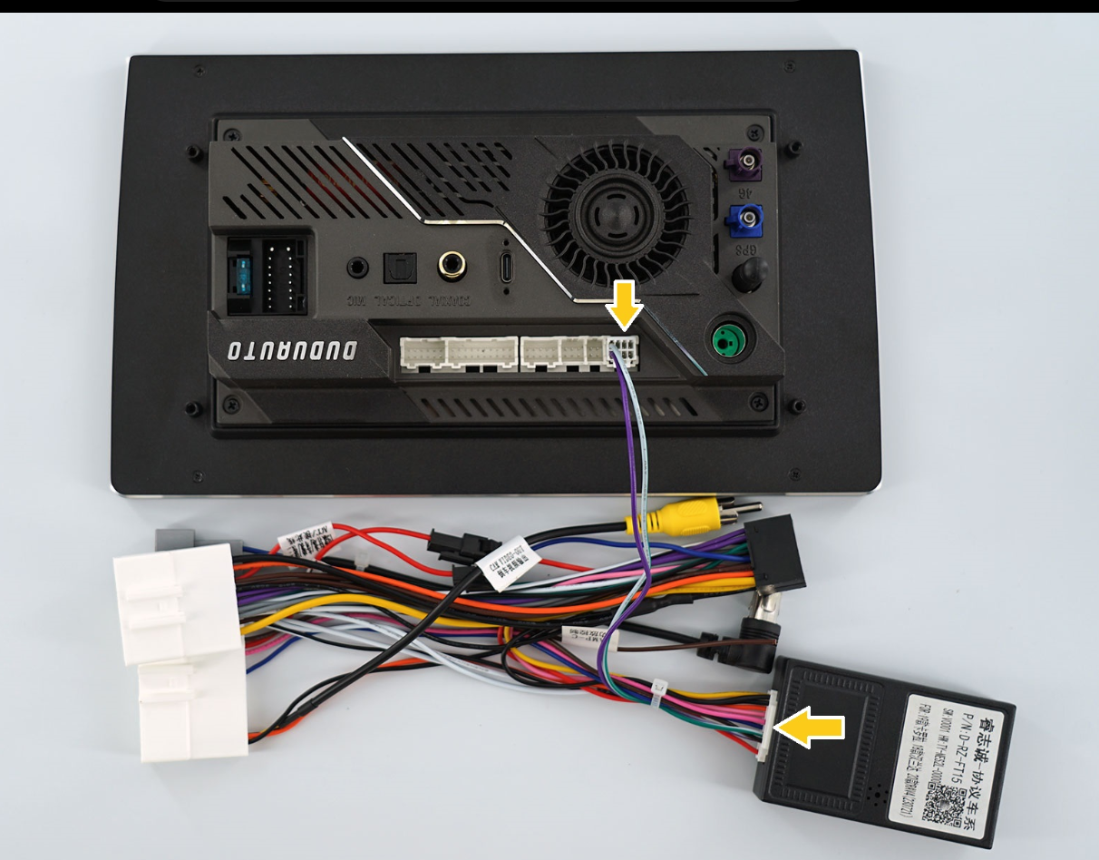

dudu-lai Hello, what car do you have? Can the factory screen control the air conditioning? Is the RX/TX cable on the C-mount disconnected?

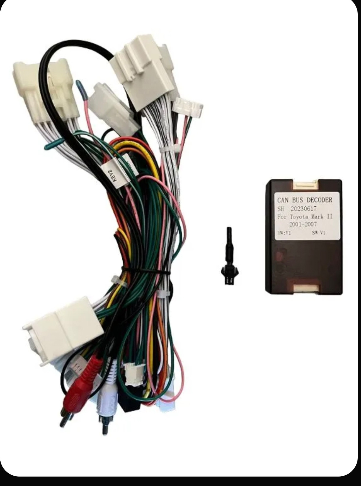

dudu-lai Fantom38 Are you sure you're using an LZ (HZ) CANBUS box, and not another brand? This phenomenon is a problem with the CANBUS box.
