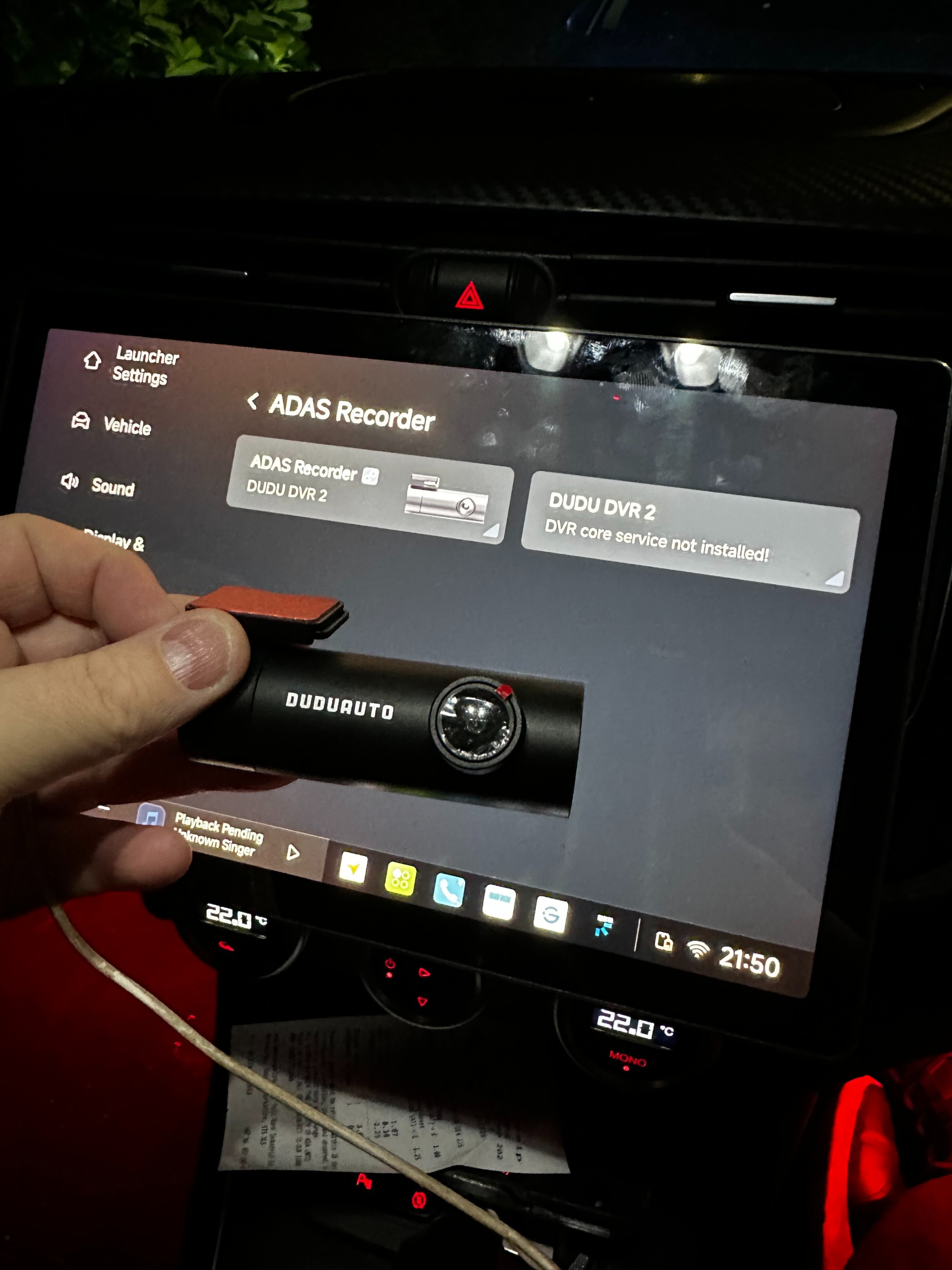

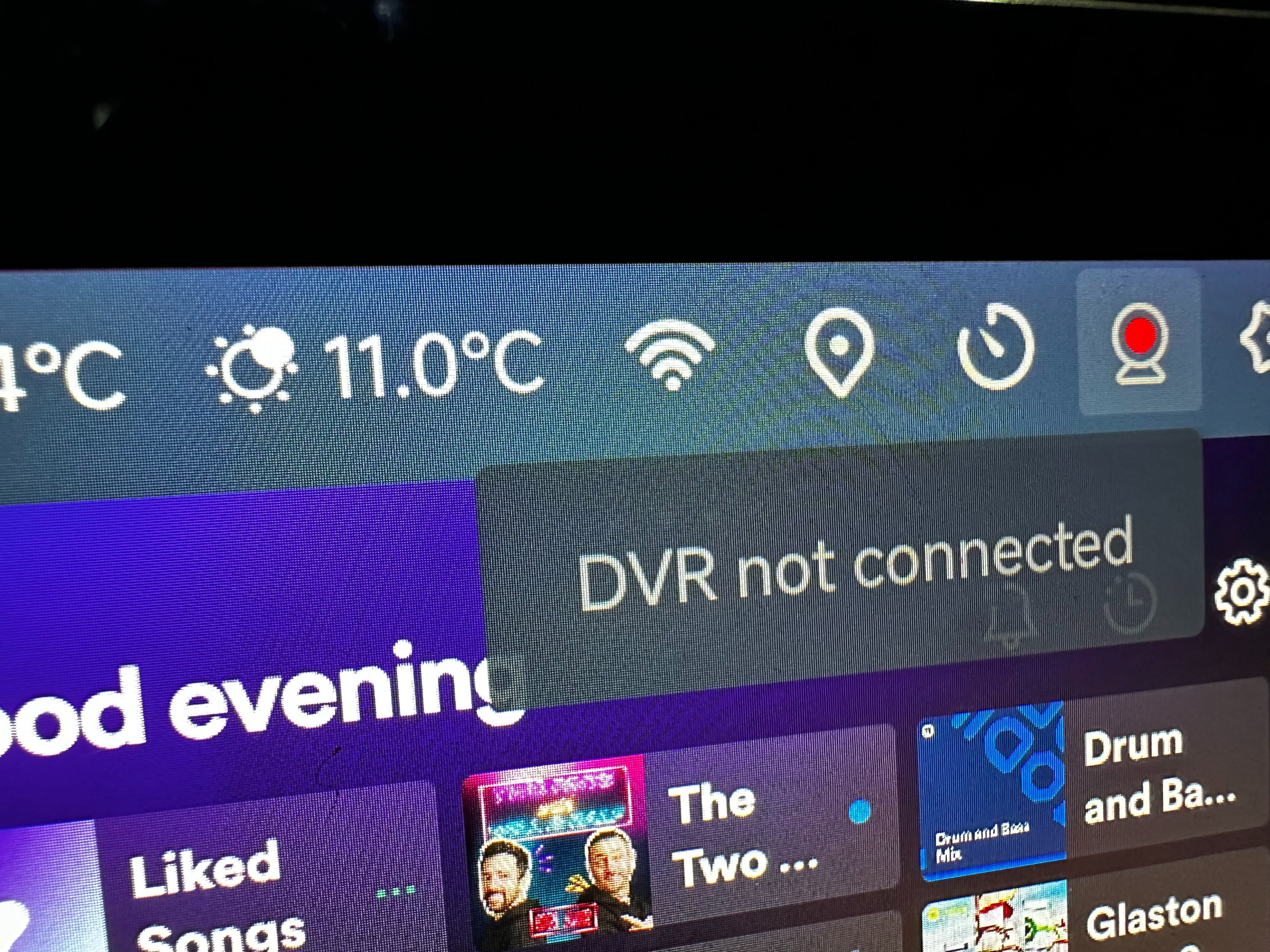

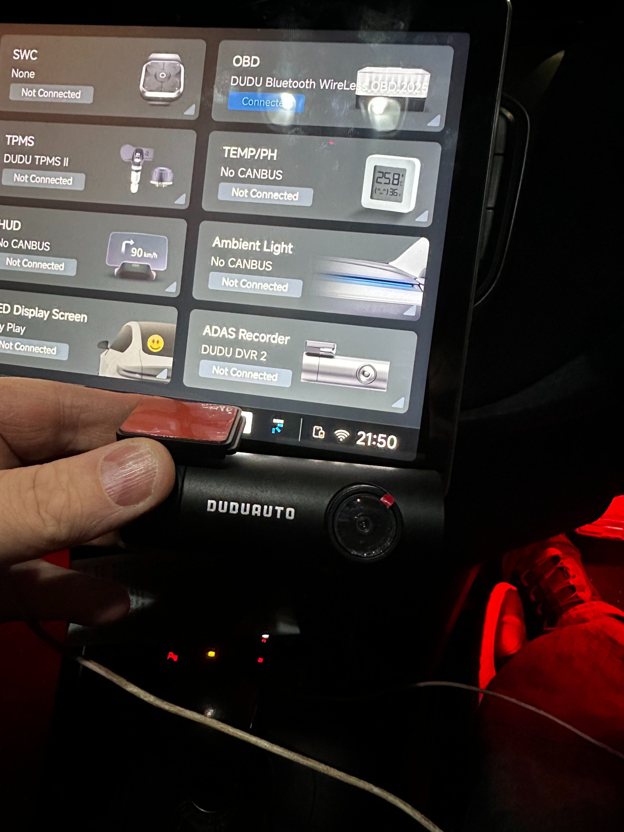

Whistler having issues trying to get the 2k DVR to work correctly. Says DVR not connected and the ADAS wont work
hafiz_tahir Whistler from the picture, you have to install dvr core service first. Go to the file manager Select usb (that contain the .apk). Install Open the dvr 2k apps Check for apps update and firmware update If prompted to install core service, proceed with the installation
DUDU-Meng Whistler If you are unable to continue with the setup, please uninstall the currently installed 2D DVR app and reinstall it. When you connect to the internet, you will be prompted to download and install the core service. Only after installing the core service can you use the following features. You may also install it manually. https://drive.google.com/open?id=1QNB4cC9TKfvSVYtT8eSF2SagOXNGXWoH&usp=drive_fs
Whistler hafiz_tahir I did try that following these instructions but it just kept failing. https://wiki.dudu-auto.com/en/%E5%A4%96%E8%AE%BE%E9%93%BE%E6%8E%A5/AR%E8%AE%B0%E5%BD%95%E4%BB%AA

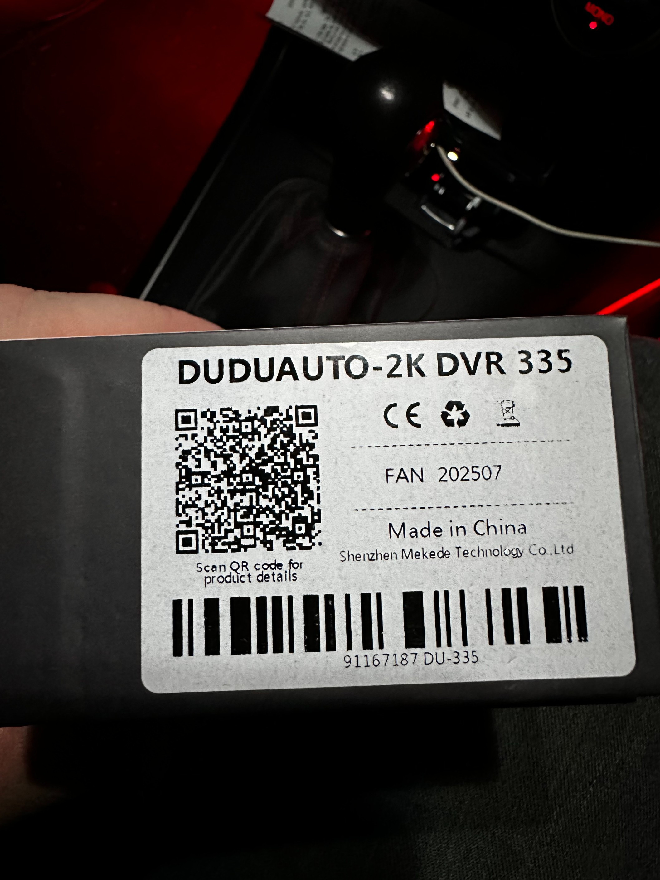

hafiz_tahir Whistler this is for AR recorder, not DUDU DVR 2k. 2k is the newer model. After install apps, is the apps prompt you to install the core service?
Whistler got this working now, uninstalling and reinstalling the app worked, it actually installed the core service this time. Thank you all for you help
