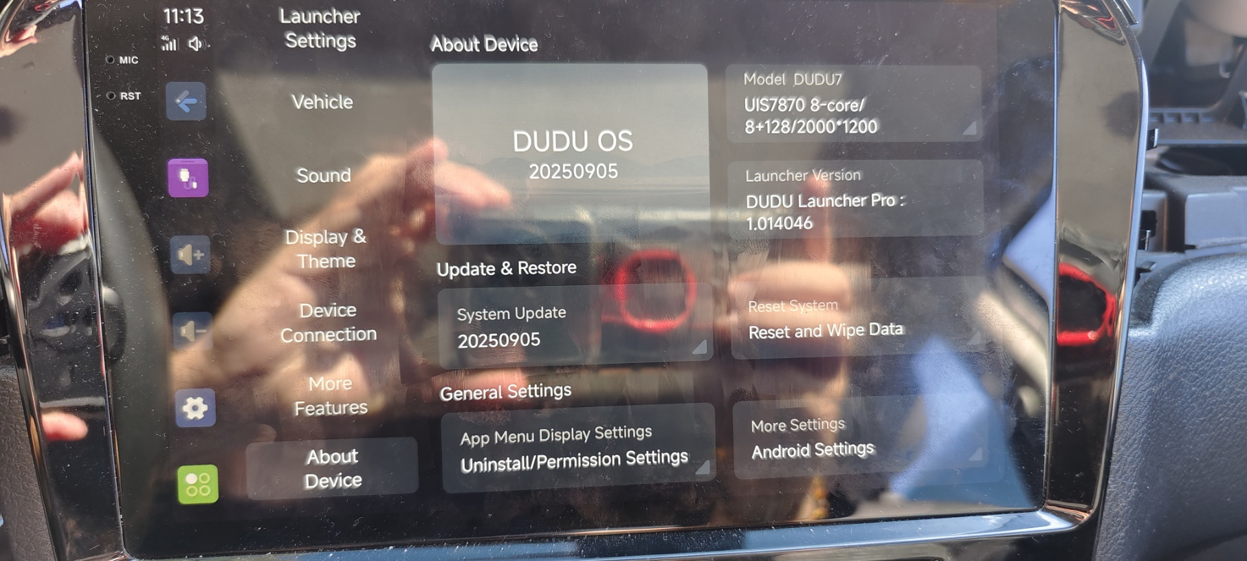

After the latest OTA update, it stopped working; before the update, it was working properly.

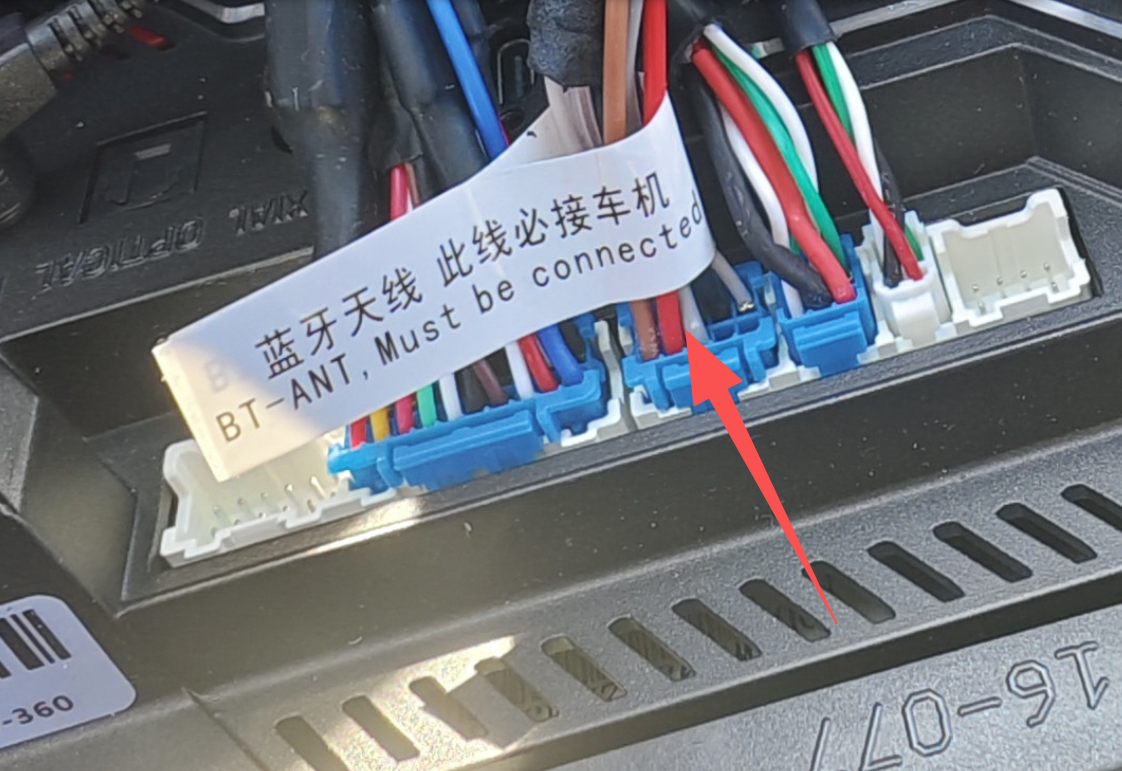

This is my system:

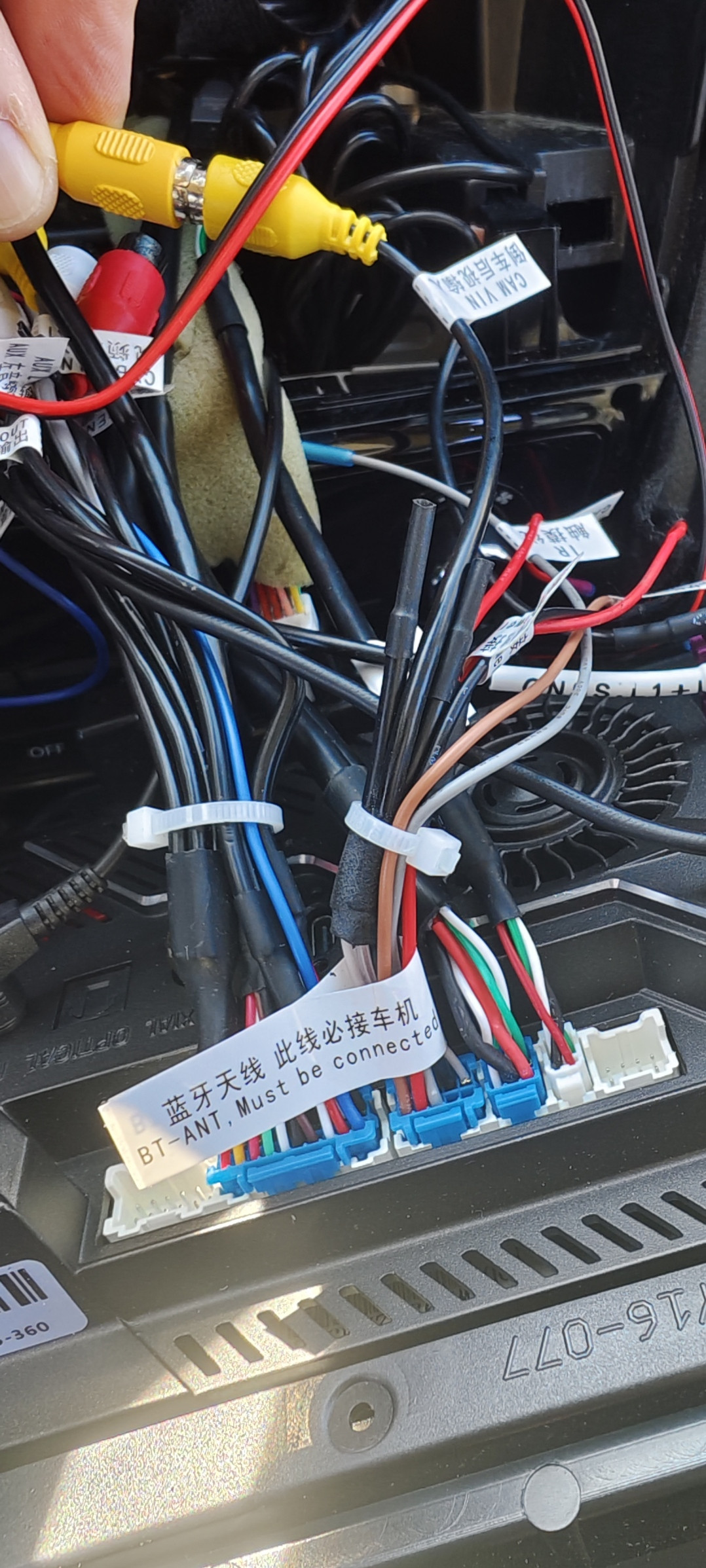

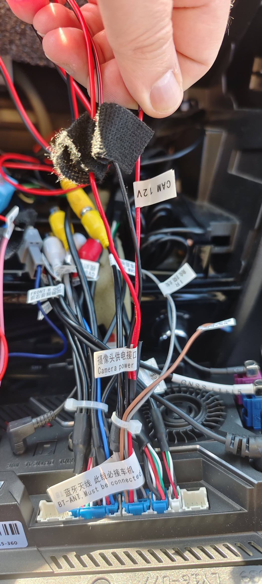

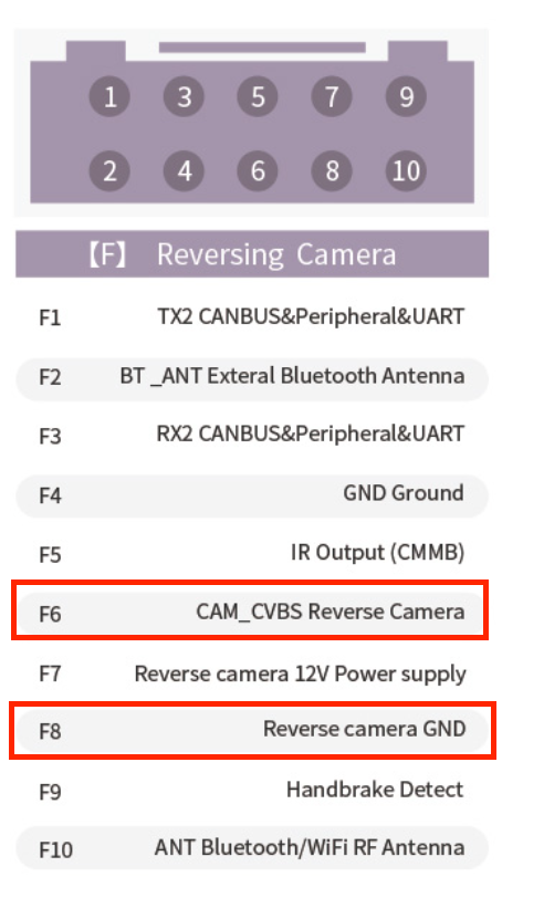

The rear camera is an aftermarket AHD, powered by the F socket and the trigger taken from the original car wiring:

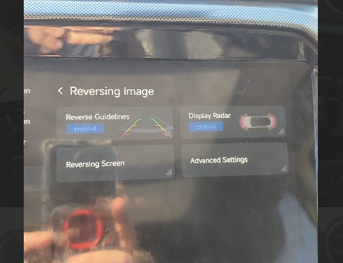

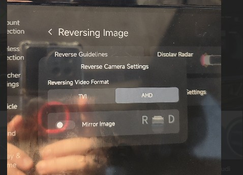

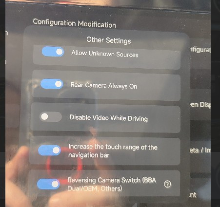

The DUDU settings are as follows:

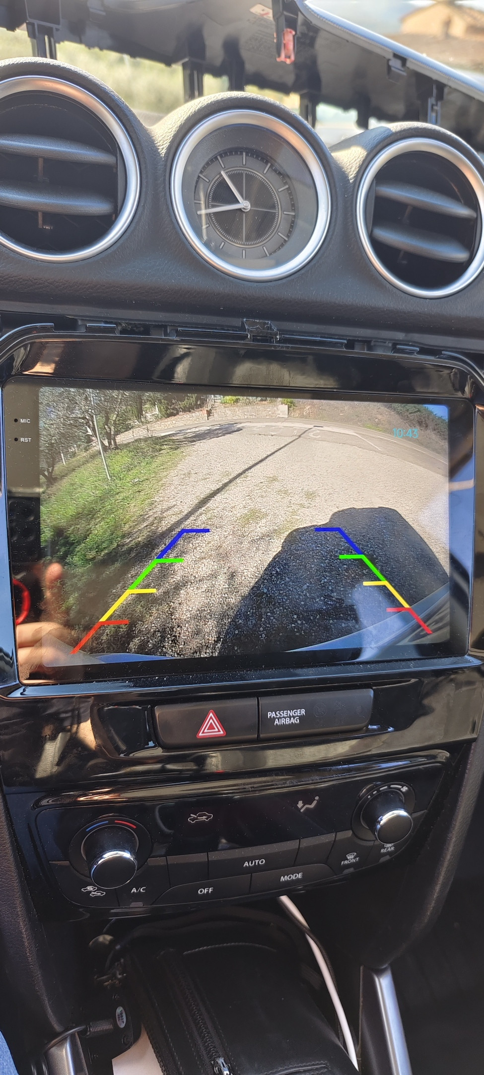

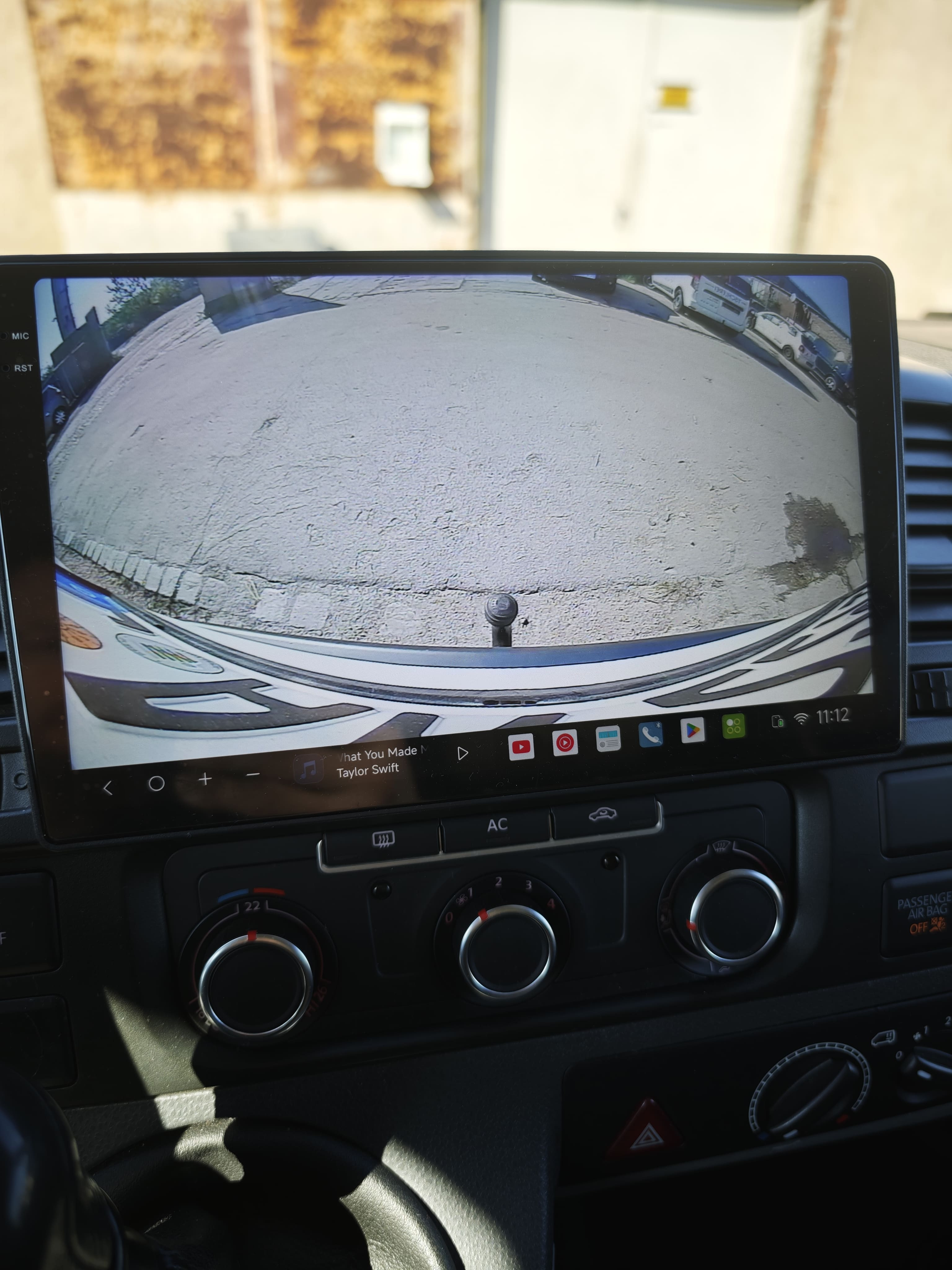

I tested the rear camera by changing the DUDU settings and connecting the video cable (yellow) to the AUX input and it works:
I did a system reset using "Reset and Wipe Data", but it doesn't work, I get a black screen with "No Signal" written on it.
