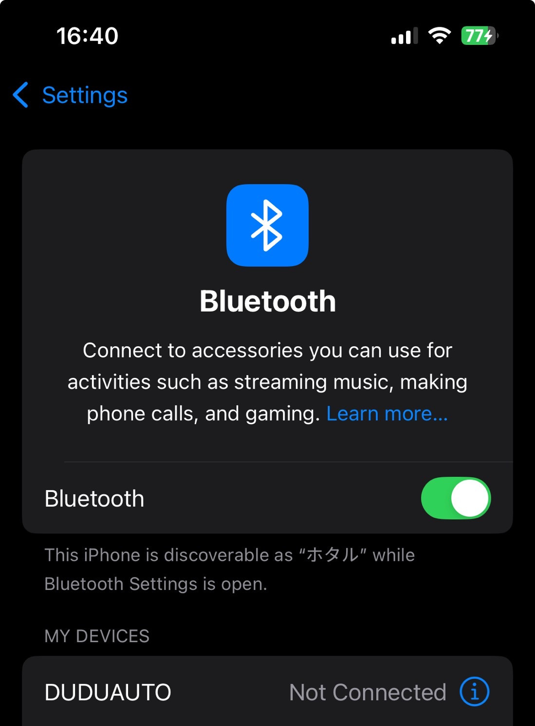

Nechigawara I want to change bluetooth name from generic duduauto into something else. I can't find the menu that allow it at all. Also, where can I set music widget transparency so I can see the live wallpaper?

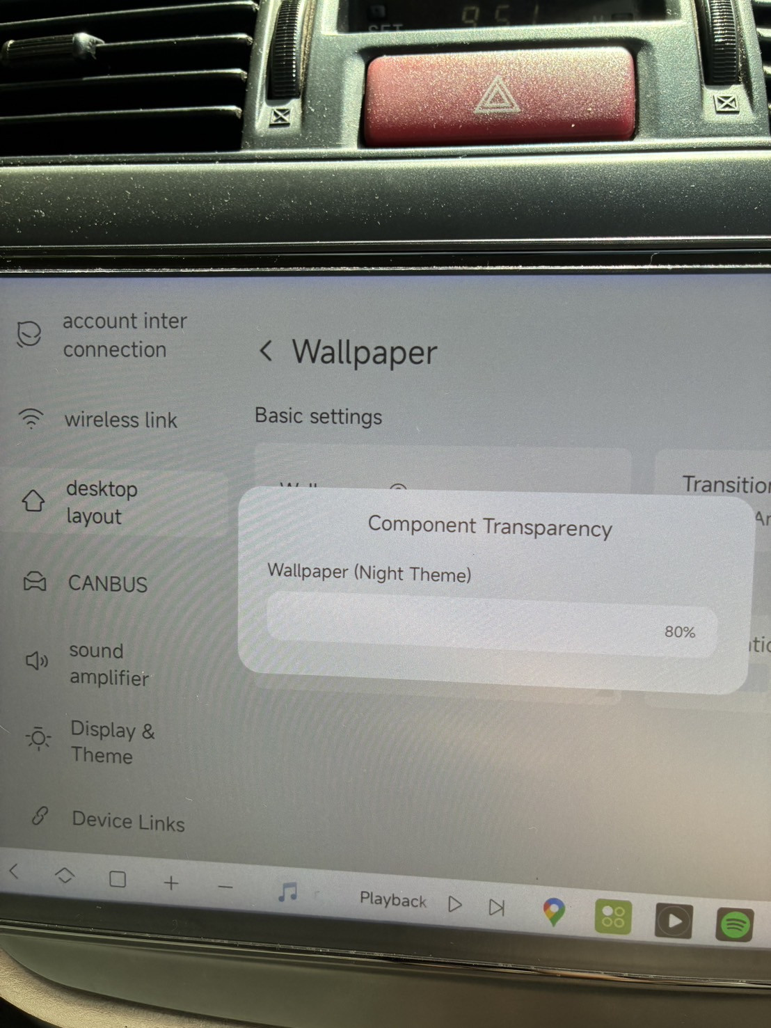

Nechigawara DUDU-Meng I tried this option and I don't see the change so I'm not sure if it's the right one.

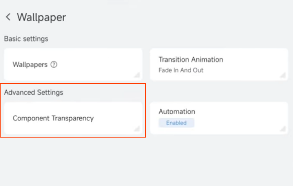

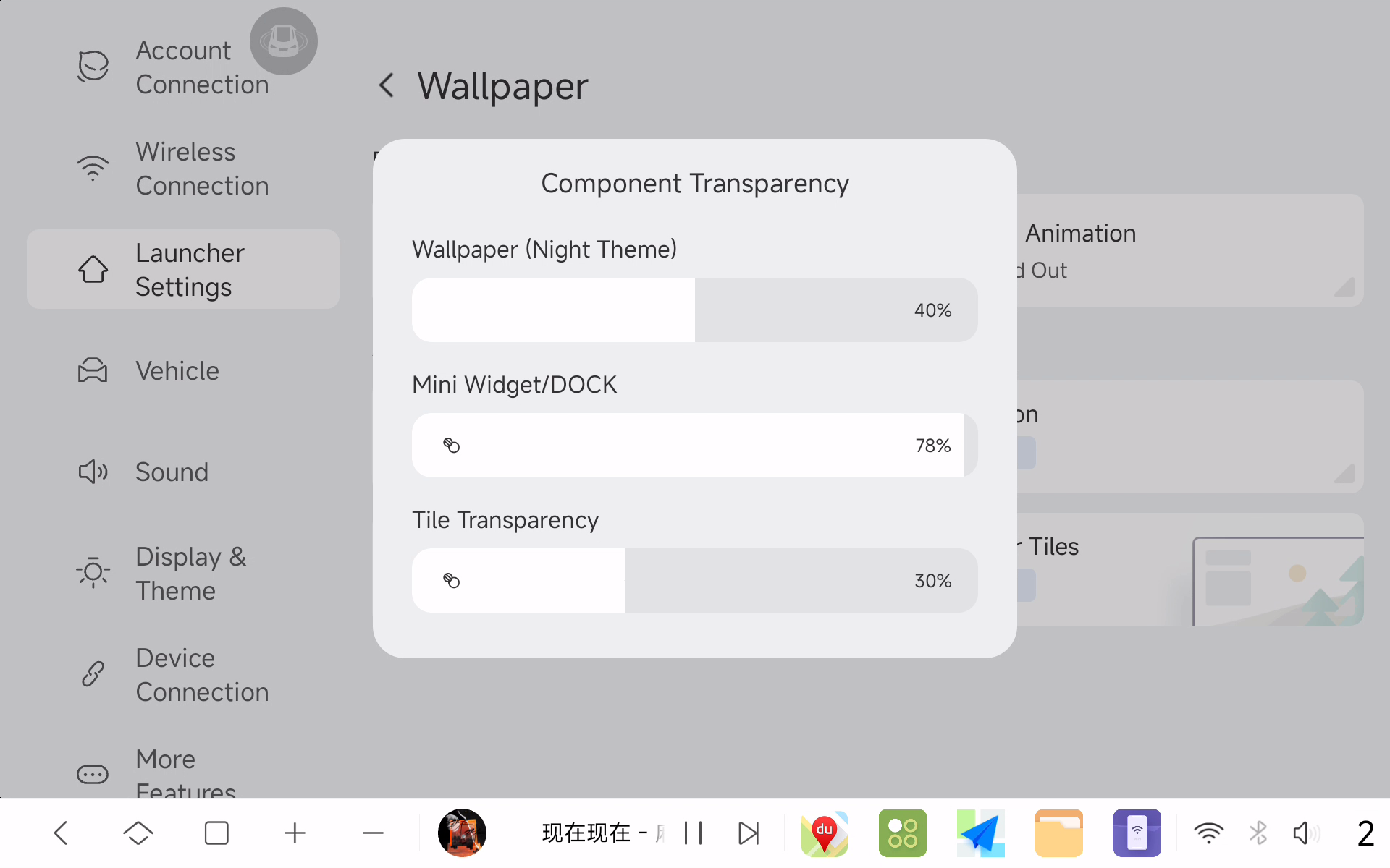

DUDU-Meng Nechigawara Transparency settings are all functional. The transparency of small plugins and attachments can be adjusted independently.
Nechigawara Don't know why I only got one option for wallpaper. But I decided to change back to default theme, and some how, the transparency of music widget shows up. So it depend on the theme may be?
DUDU-Meng Nechigawara My screenshot is in standard mode. Minimal mode shouldn't have any extra plugins, right?
