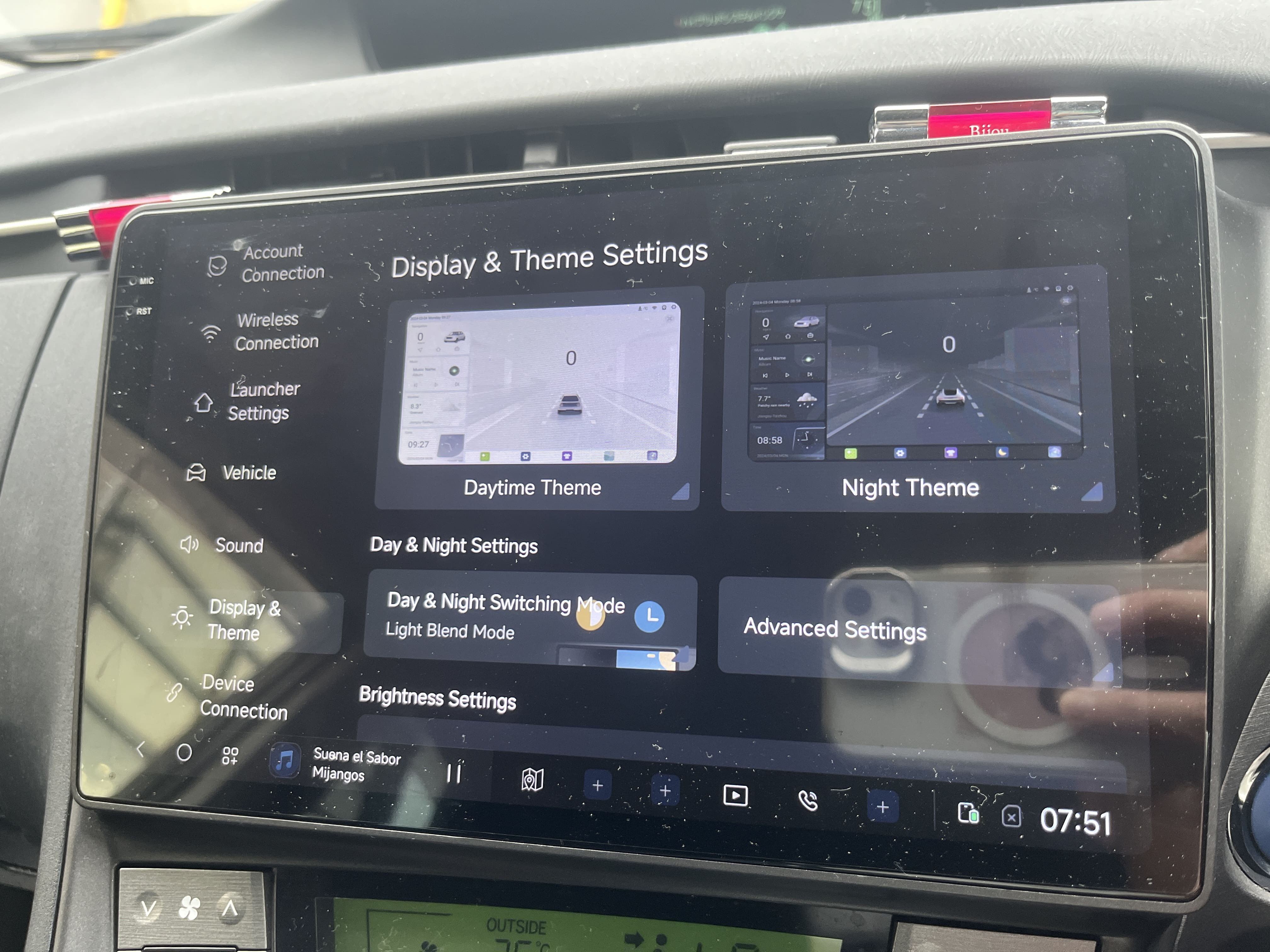

DUDU-Meng yes if I turn on the headlamp manually, it will switch themes instantly.

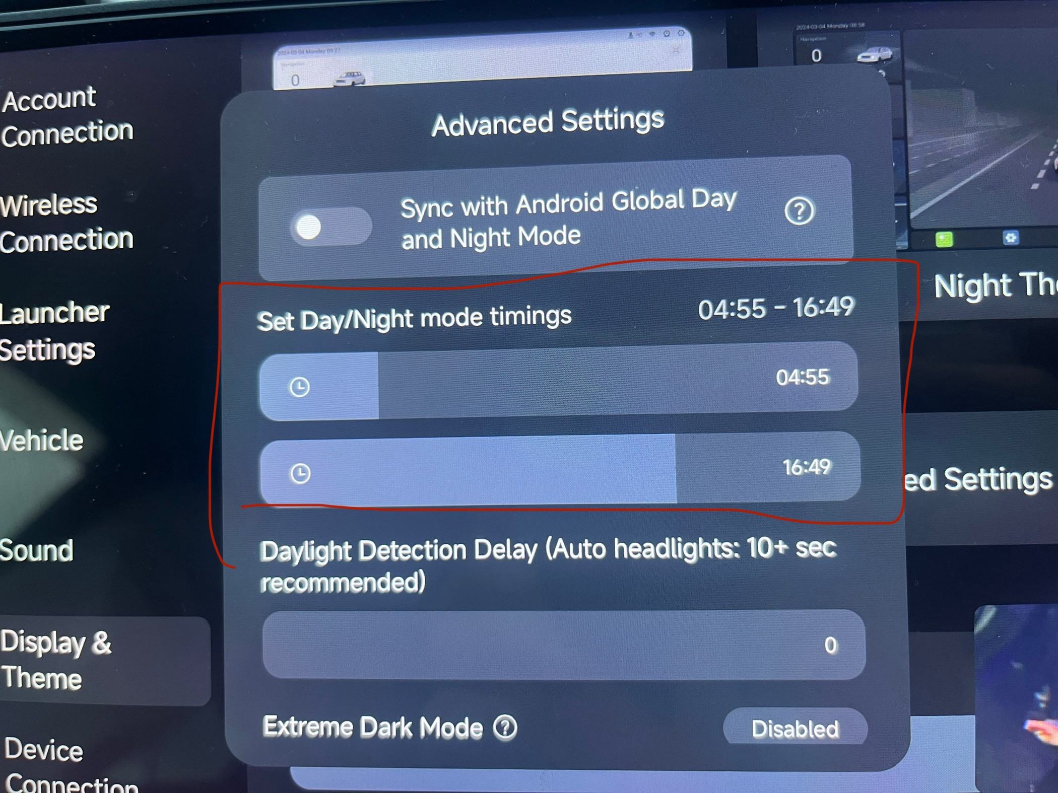

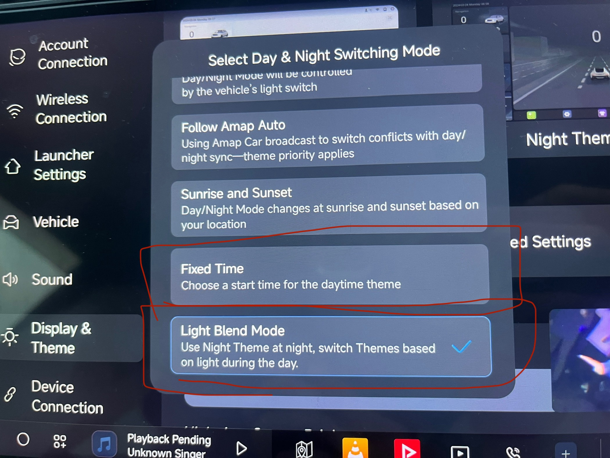

But if headlight is off, and it is during the day, my DUDU7 is sometimes still in night mode, or sometimes it is in day mode. It is at random.
For example, today morning I turned on the car, the dudu7 is in night mode. But when I drive, around 20 minutes later it automatically goes to day mode without me doing anything.
It was ok when I didnt connect my Canbus yet, but when I connected my canbus, it became this.
Is there any settings that I need to set up?

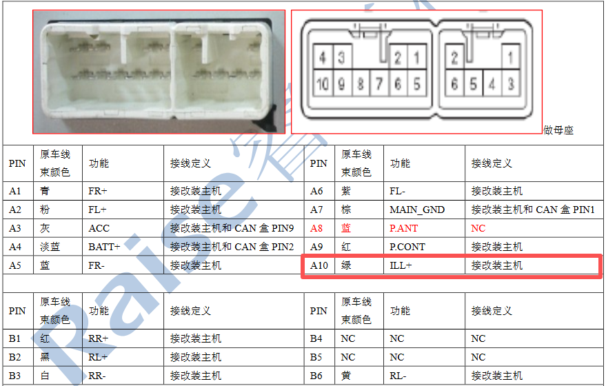

I am using prius 3rd gen 2014 with canbus Raize FT-RZ-01.
Currently I chose RAV4 on the canbus list, because it is acting the same even in Prius in the list
