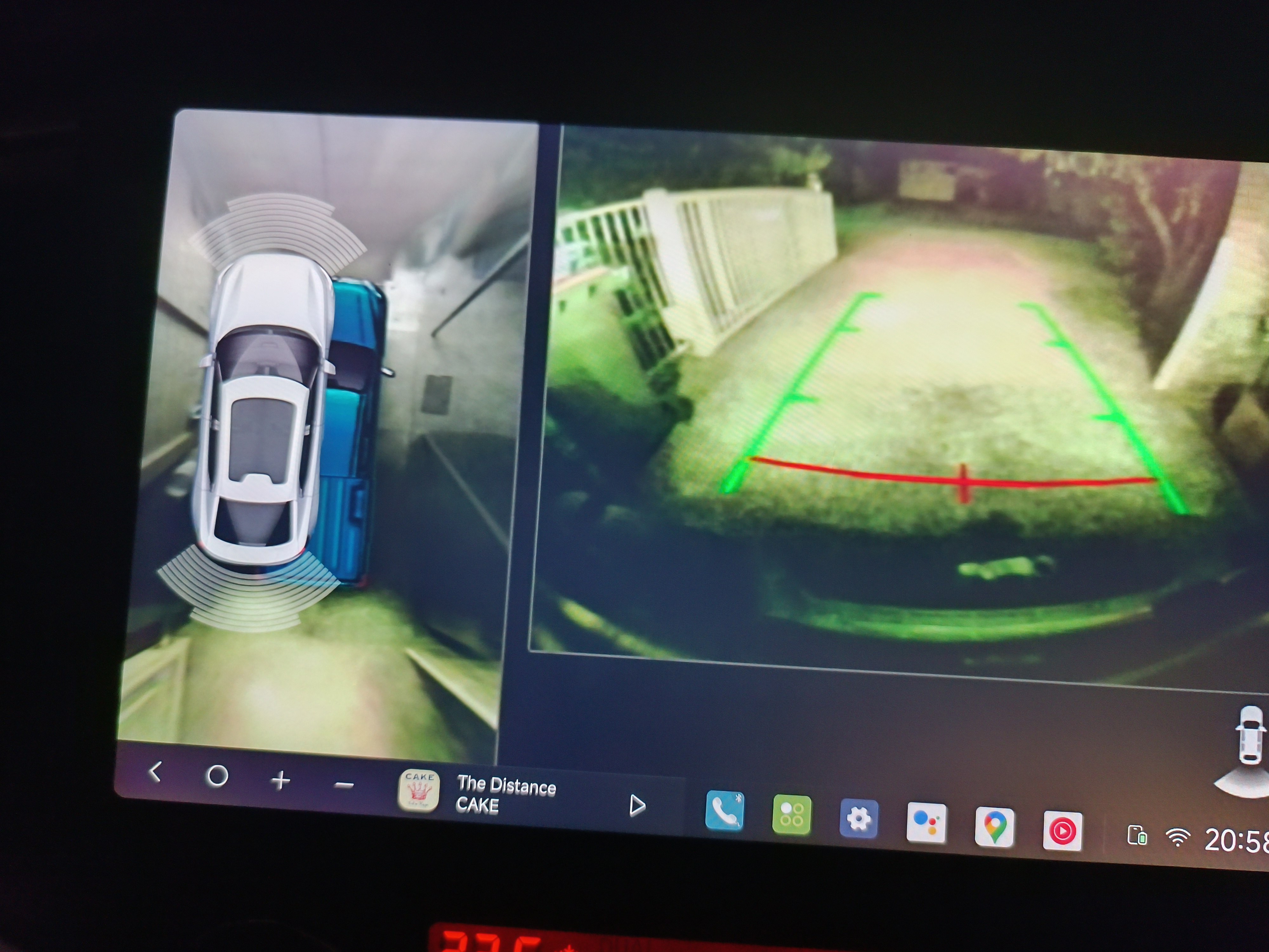

DBO Is there anyway to turn off the DUDU vehicle avatar for the 360 degree camera? My factory vehicle appears underneath and id like to get rid of the DUDU vehicle overlay. Thank you.

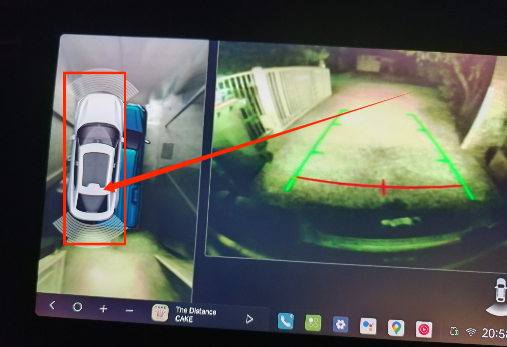

DUDU-Meng Press and hold here to drag it to your desired position. Alternatively, go to Settings > Protocol > Reverse Camera > Turn off Radar.
DBO Turned Radar Off and that made it go.. It won't move if you long press.and drag.. Turned off is what I actually wanted. Thank you.
