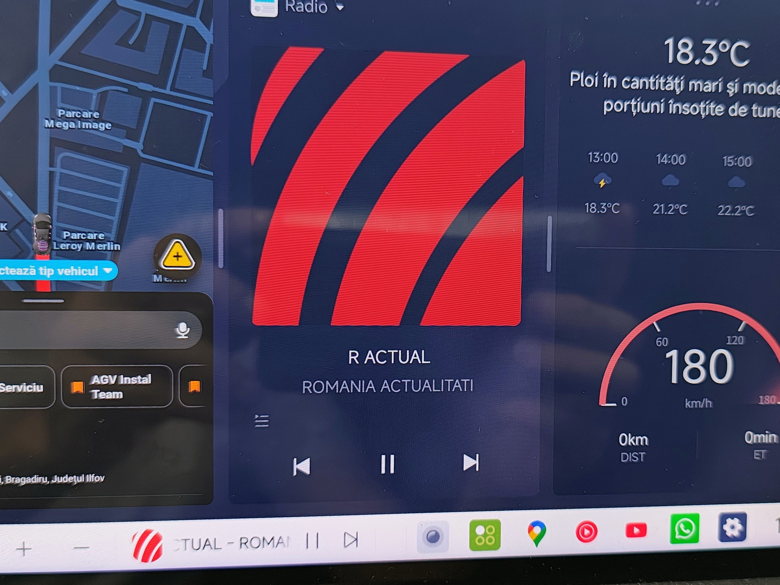

Popescu Hello! I have Dudu 7 with last update, car is Kia xceed 2020, with canbox Simple Soft. When i am with engie off, Key is on position ACC. On widget with Speed appear 180 km/h. Is possible to show 0? Thanks
DUDU-Meng Popescu Please print the CAN bus data to a TXT file and upload the TXT file here for analysis. The function is located under Factory Settings > Test Protocol.
DUDU-Meng We'll try to fix this issue first. Once we have the results, I'll send them to you for testing.
DUDU-Meng Popescu Please install this app to test and fix this issue. https://drive.google.com/open?id=17ZyQrR_7LZm1ZbmY-fY9vRgNtRCj_Mhu&usp=drive_fs
