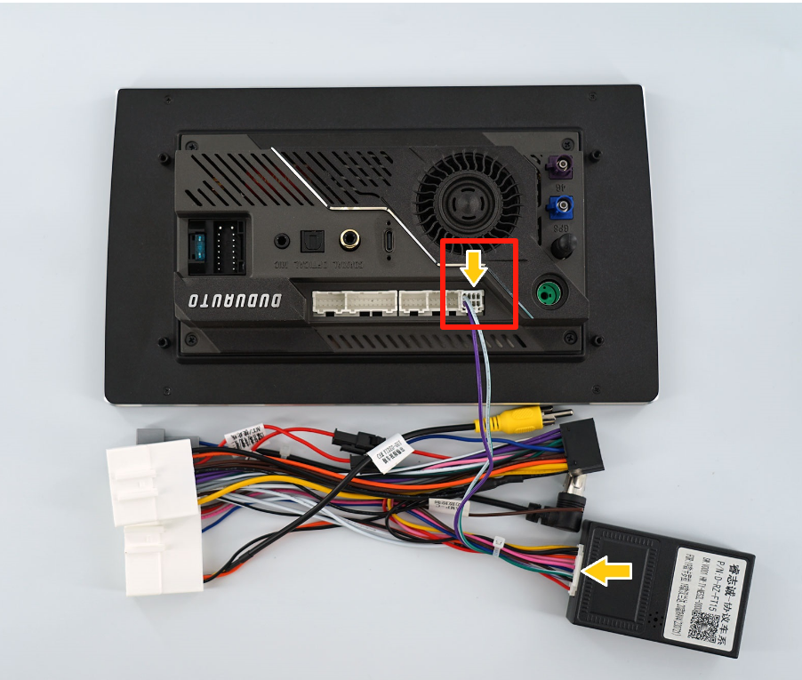

Car : Toyota Rav4 IV (XA40) 2017
Canbus : Raise RZ-FT-02/SW: V0004/HW:TY-GD-0209N12 I used successfuly in the past with a Junsun/Hengchen 8581 head-unit
Enabling CANBUS debug on screen shows a lot of trafic in and out but nothing works : no SWC, no door/trunk open, ..., no reverse camera anymore, no AC screen when enabling/disabling AC or changing its parameters
Version information screen shows : CANBUS version : unknown box
FYI, I did choose RZC(Raise)-Toyota-RAV4-2013-2018(393328)
Running second 3.6E update / CANBUS 2125082208
Is there an update available for that Canbus decoder ?
Is it dead ?
Is the issue HW (dead) or SW (fixable) ?
