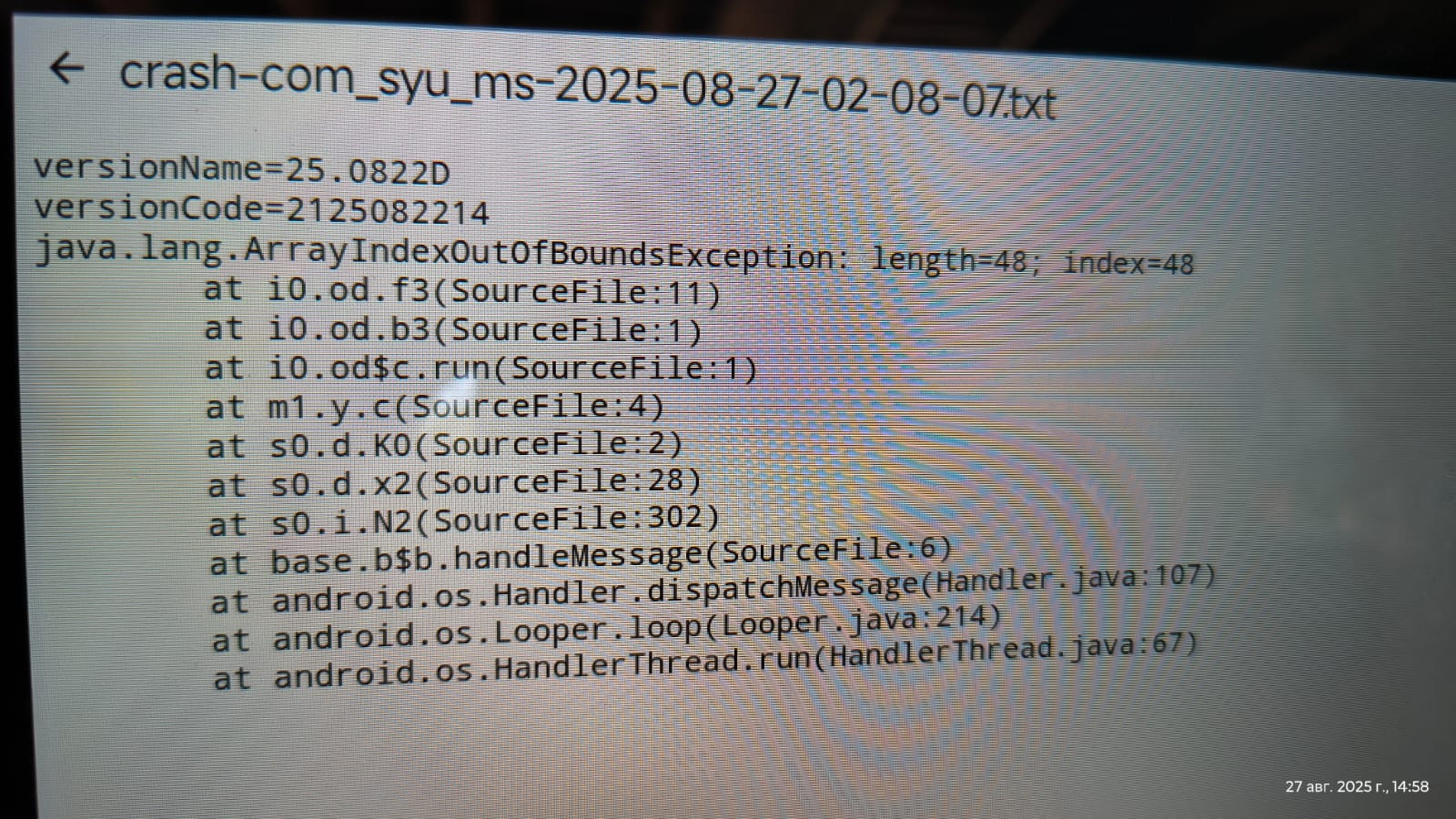

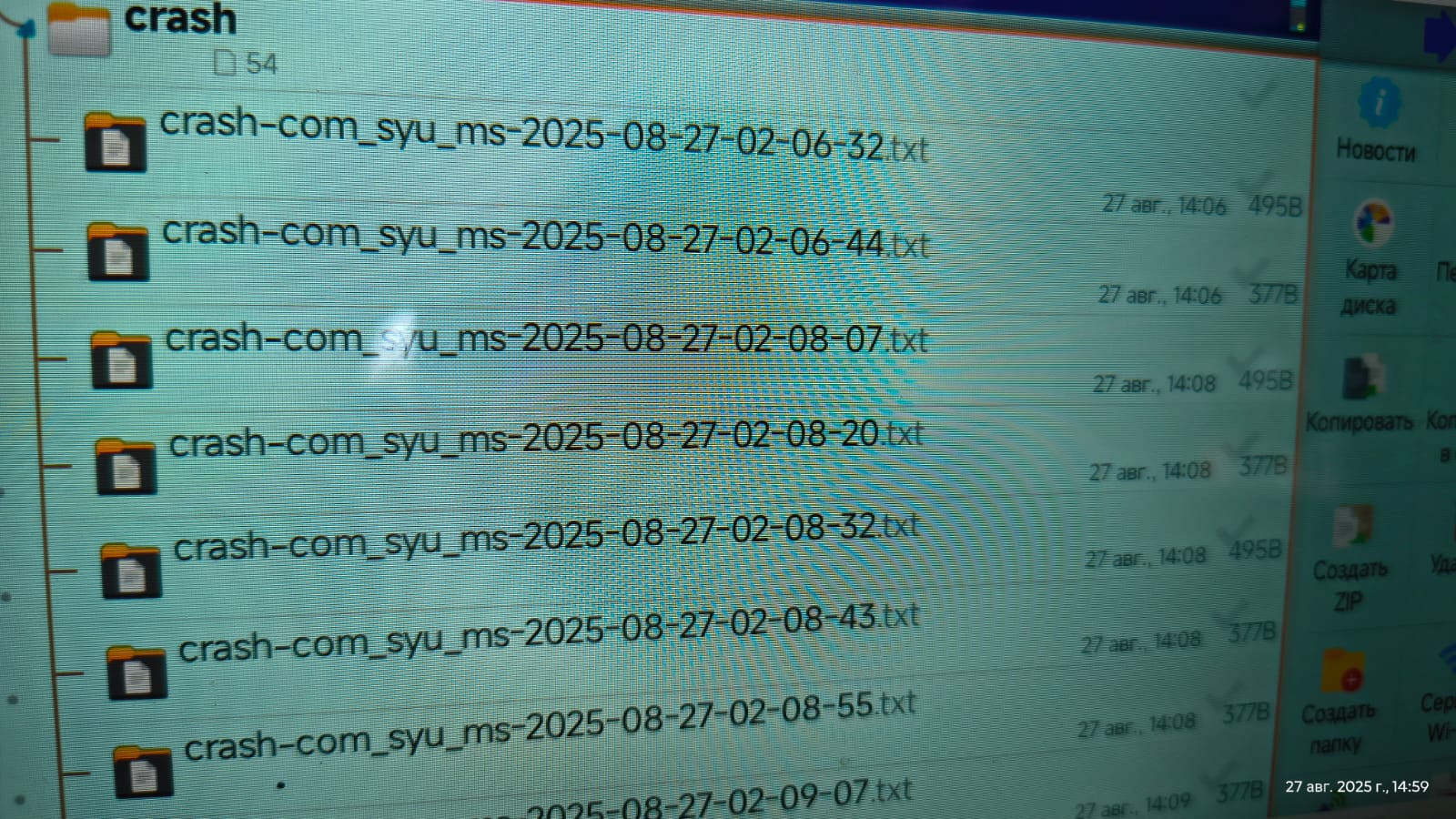

Romanus . music is completely turned off, sound control is completely turned off, can-bass is completely turned off. volume control does not respond either from the screen or from the buttons.

DUDU-Meng Romanus If it's multimedia auto-pause, you can update to the latest 250829 system firmware and test it. This should resolve the issue.
DUDU-Meng Romanus Version 0829 is currently in the testing channel. It seems to have been released on the forum as well.
Romanus проблем не было на прошивке 20250430. после обновления до последней новой появились проблемы. я сейчас поставлю обратно 20250430
DUDU-Meng You may revert to 0430, but I still recommend trying 0829 first to see if it resolves the issue.
Romanus DUDU-Meng ( у меня Teyes Lux One устанавливаю все прошивка от DuDu проблемы везде именно со штатным проигрывателем MP3)

DUDU-Meng Romanus Please upgrade to the latest version released on the forum to see if this issue has been resolved. https://forum.dudu-auto.com/d/2206-duduos-36e-official-update-now-on-ota-duduos-37-preview
Romanus DUDU-Meng привет. Да я установил. несколько дней. сейчас все нормально. я напишу , если будут какие то проблемы. спасибо
