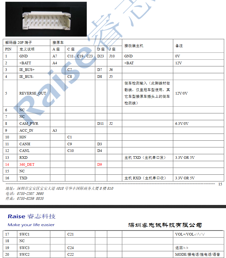

ianespana Hello, would anyone have the electronic diagram for the CANBus connector? I'm working on implementing my own decoder (none exist for my vehicle), and need to know the pin definitions on the stereo's side. They are not in the wiki
ianespana I'd also like to know what the logical voltage for the CANBus decoder should be. 5v or 3.3v

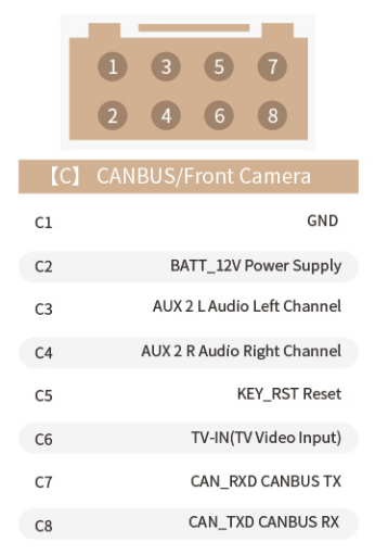

ianespana dudu-lai Do you have the diagram on the stereo's side? This is for the CAN decoder. I need the diagram for the 8 pin connector
dudu-lai ianespana https://wiki.dudu-auto.com/en/%E5%AE%89%E8%A3%85%E6%95%99%E7%A8%8B/%E8%BD%A6%E6%9C%BA%E5%AE%9A%E4%B9%89%E5%9B%BE
