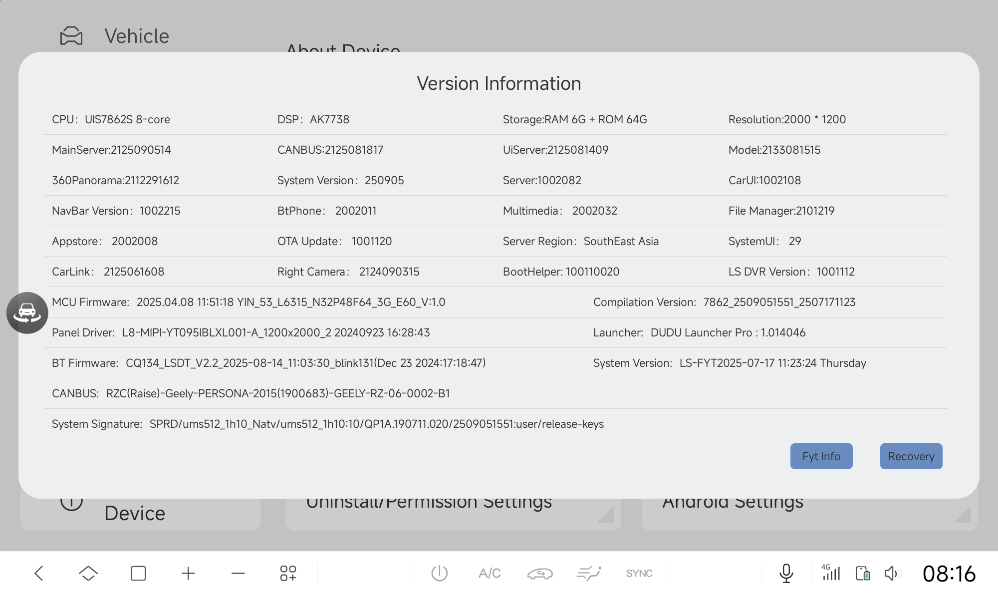

my canbus? i dont think so, because initially (when i still using DUDU3 OS) this issue is not happening. only after update somewhere Q4 2024-Q1 2025. i try the below firmware, it start the issue (that time still DUDUOS 3). then i sell my Head unit on feb 2025:
Global_DUDU7862_2408211835_2408171619
Global_DUDU7862_2409271840_2408300921
Global_DUDU7862_2412220202_2412031746
now, i purchase DUDU6 in august 2025, the issue still there.

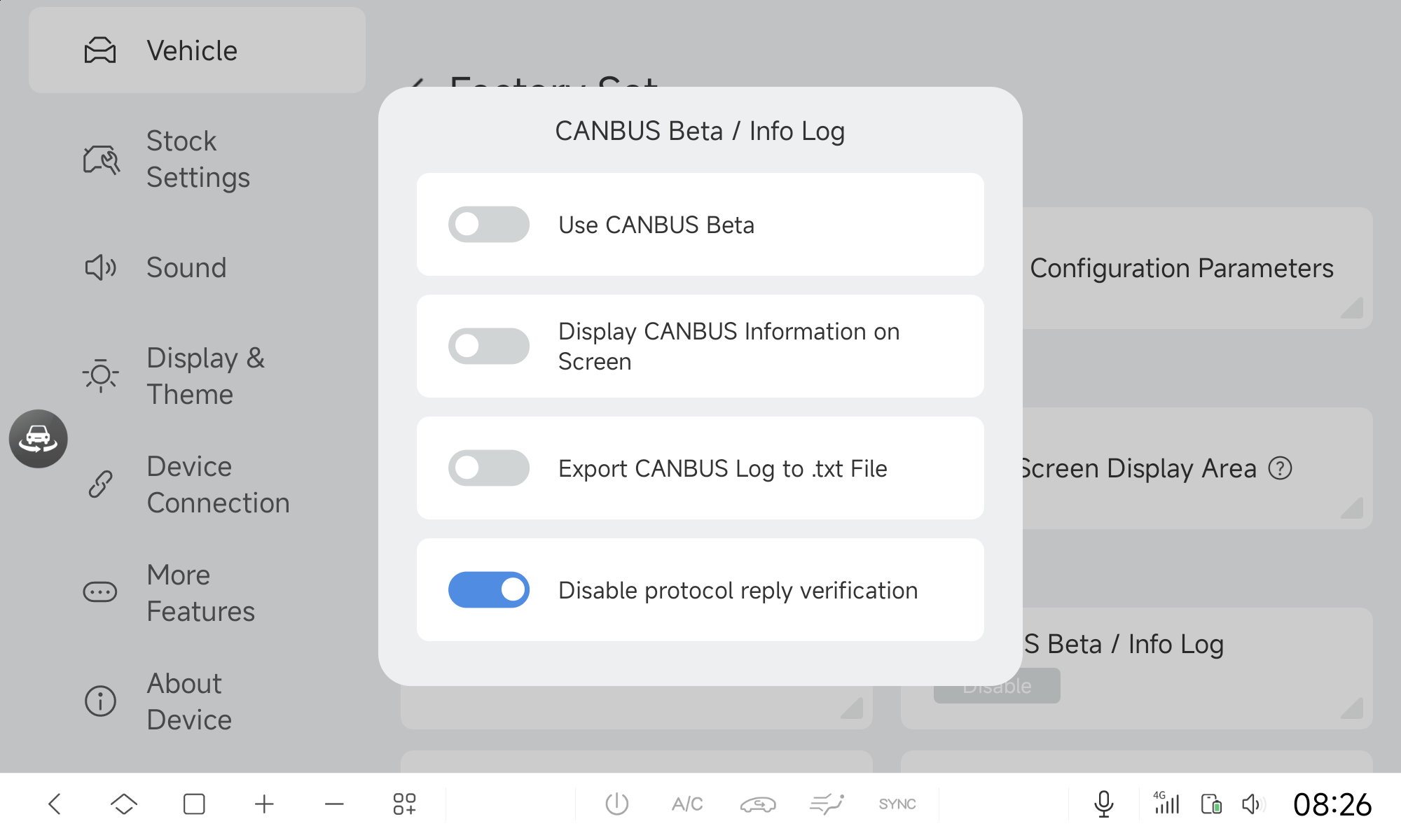

I ran a few test:
- I disable my canbus, restart the HU -> the speed correctly show (maybe using GPS)

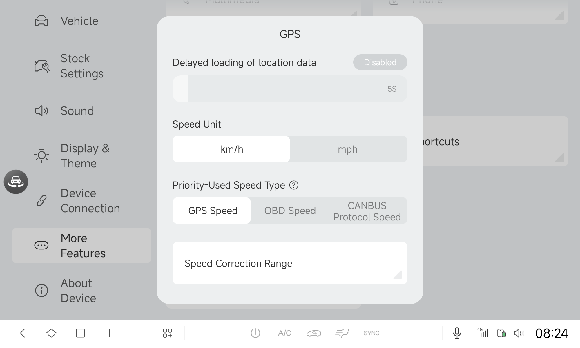

- I enable my canbus, set the GPS speed to follow GPS -> the issue is there
- I enable my canbus, set the GPS speed to follow canbus protocol -> issue still is there
BTW im using Malaysia Proton Persona. Canbus using Raise Geely Persona (Geely and Proton is same since they are same group)
