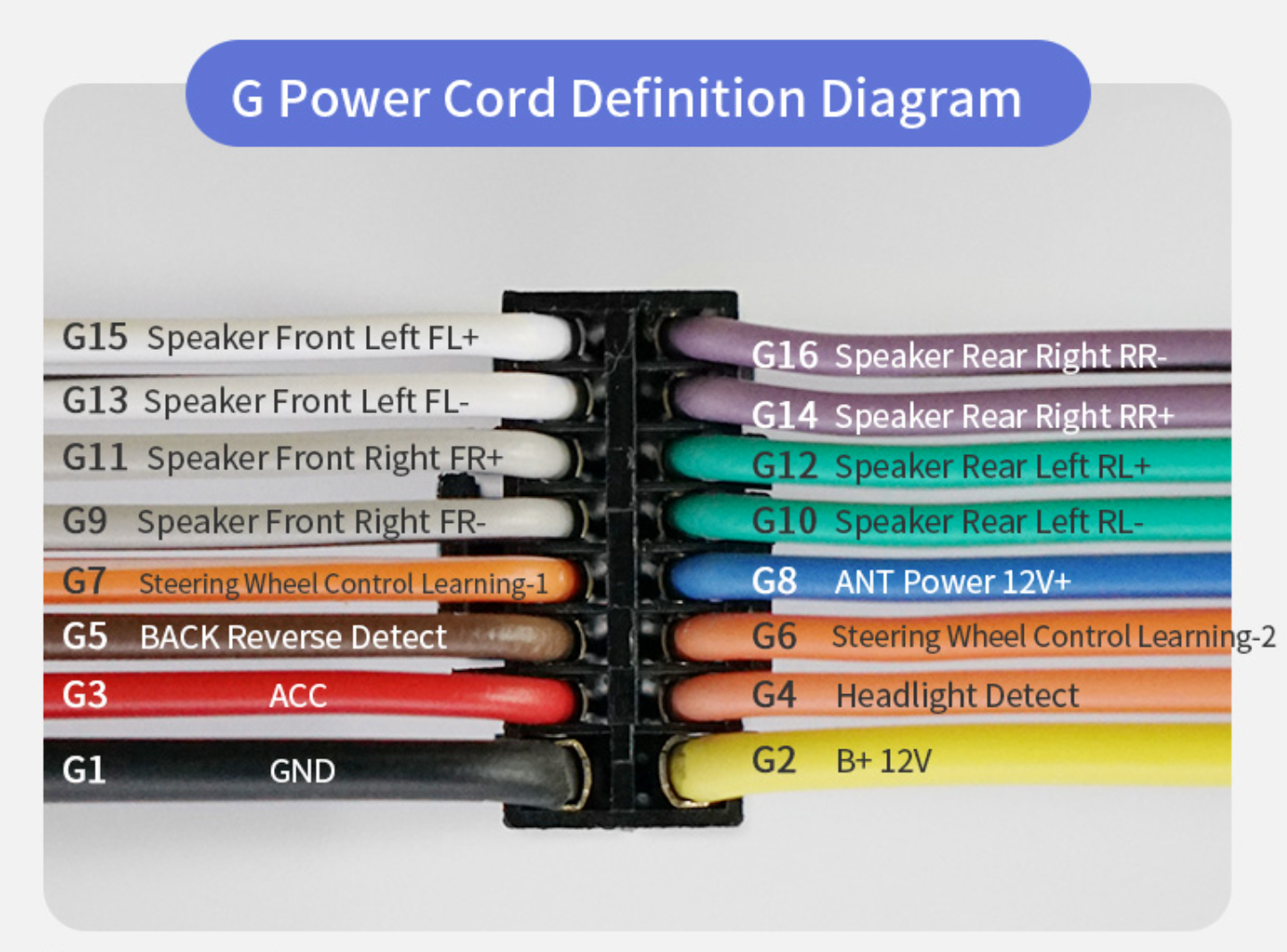

You should double check if connectors is properly connetcted, and if you have multimeter you can check for for voltage on G2 and G3 pins when key is on acc.
G2 pin is constant voltage, G3 pin is for powering on device. If there is no voltage there than your canbus is problem.
