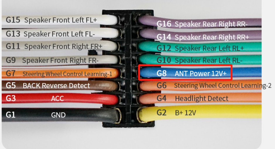

narcotico Hello, using a Type A connector (AMPcont cable), you can turn this cable on/off through your device's amplifier settings (equivalent to a controllable ACC cable). This does not necessarily mean you are using the device's amplifier output.
Whether you are using RCA or optical coaxial, you can connect the AMPcont cable to the power ACC input (control line) of your aftermarket amplifier.
Use this method, then update to MCU version 20250715 to see if the popping sound when turning off the console is resolved.
