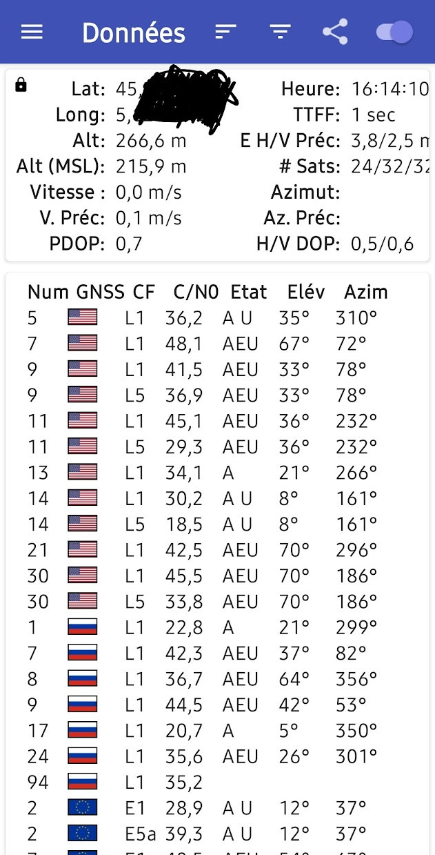

Actually, the head unit Dudu7 is kind of "right". For comparison purposes, I installed the same GPS apps on my mobile phone than the head unit, and it appears that raw datas altitude from GPS are wrong as well; the difference in the mobile apps, the app displays both altitude (raw and corrected).
Example : In this screenshot from the GPS app installed on my Samsung S25+, the actual and almost correct altitude is 215,9 m (MSL), the other one (266,6 m) seems to be the raw data from the GPS chip.
