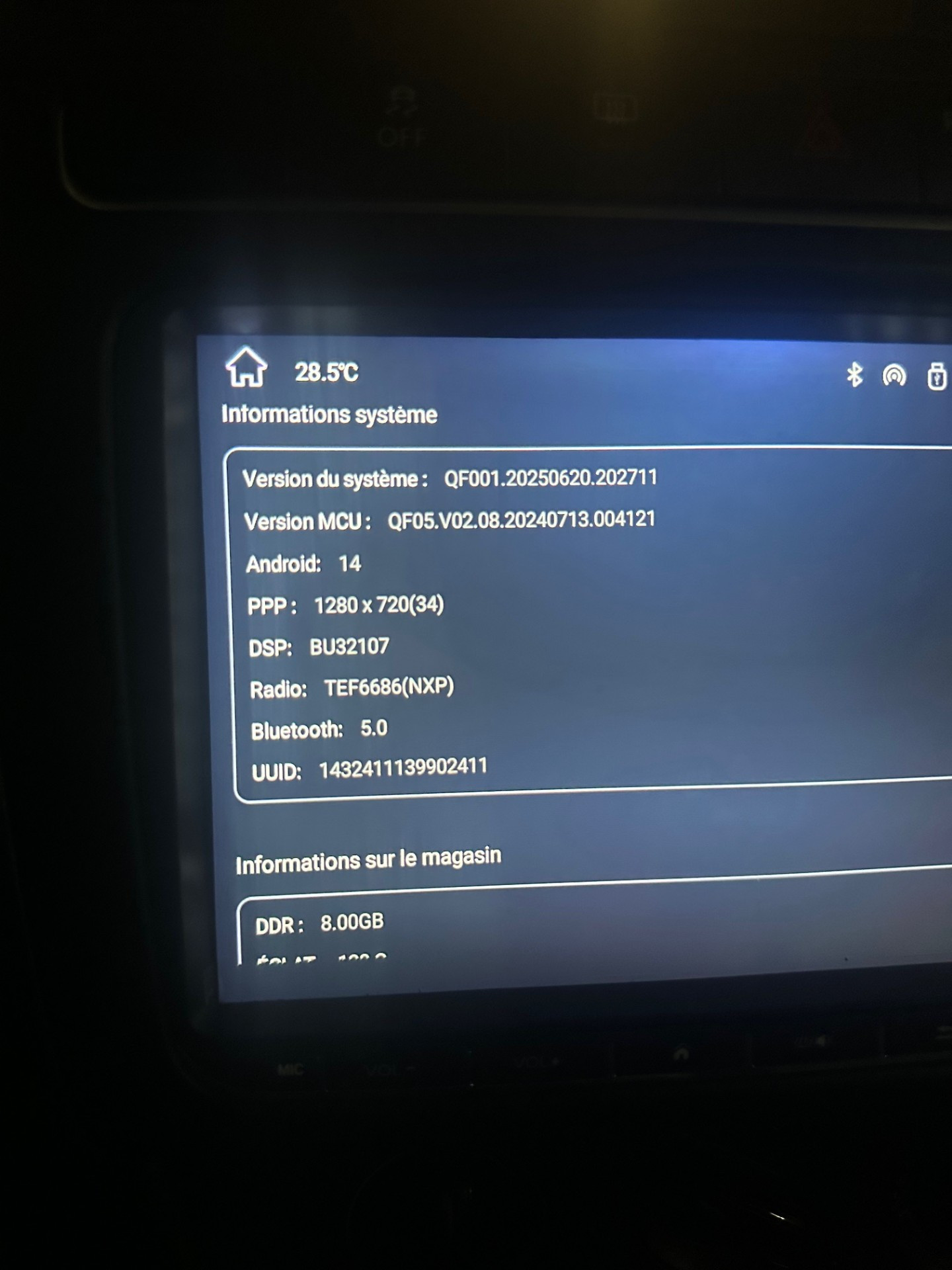

Moha94470 Hello, i have an Hizpo S8 and i need to know how can I install DUDU on it and if I can, what is the correct version and the link please ? Thank you very much 🙂
MihaiFlorin Moha94470 Only the launcher. And to be honest I don't know what version public or private. Your unit is not an FYT platform based one so no compatibility with the full firmware.
DUDU-Meng If you only want to use DUDU Launcher, please refer to the following link. If you want to use DUDUOS, you will need to change or purchase a DUDU device. https://forum.dudu-auto.com/d/106-dudu-launcher-global-updated-download
