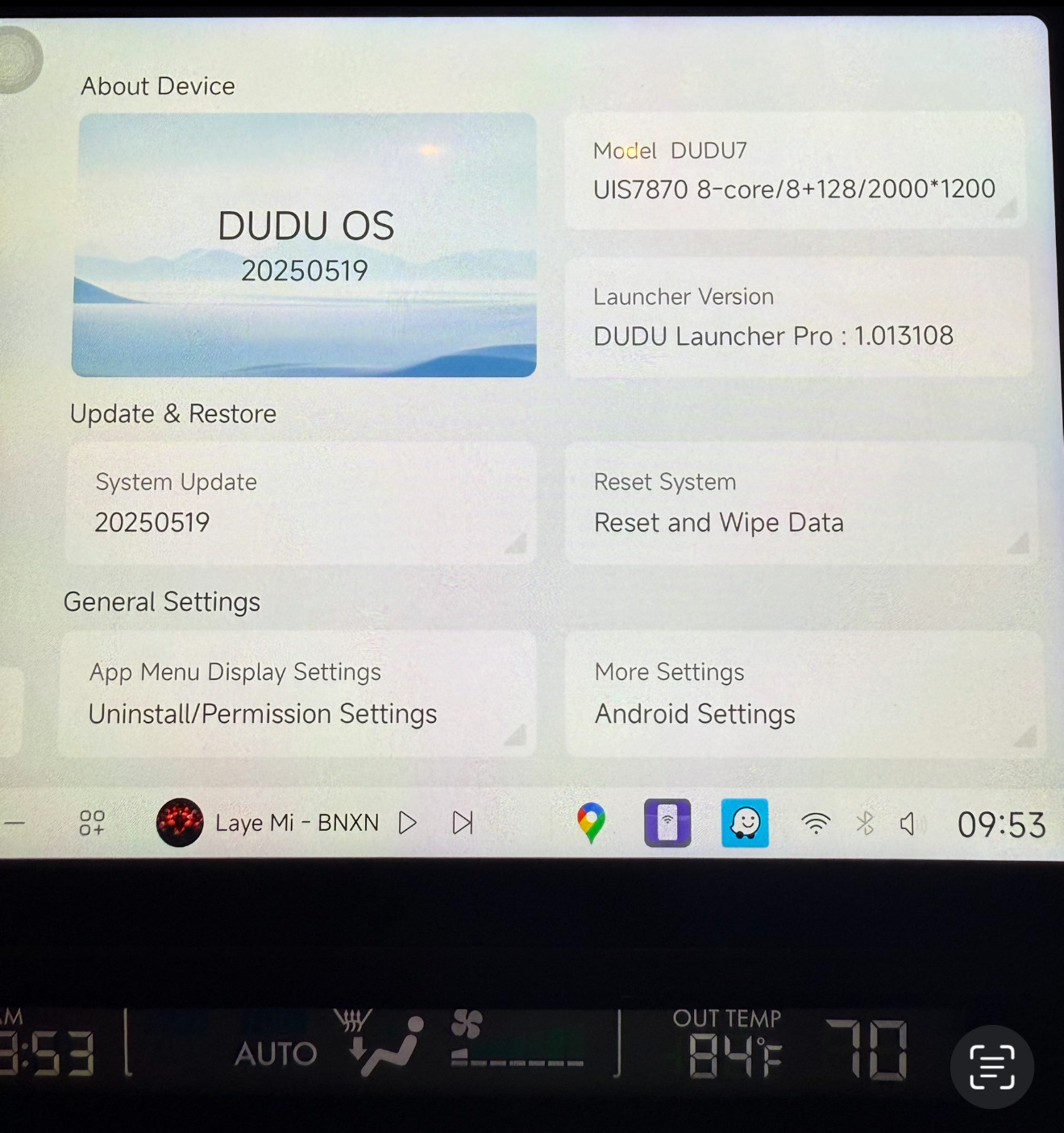

Nafichisom Can not access climate control on 2016 Subaru Outback with HK. Canbus is installed and working. Installed DuDu7 unit. XP(simple)>subaru>outback>2015-2019.

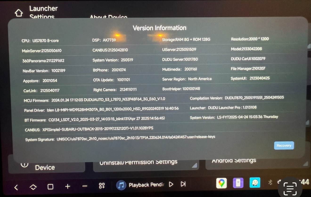

DUDU-Meng Nafichisom Please upload a screenshot of your system information using the link above, and also take a video or photo to illustrate the issue you are experiencing.
MihaiFlorin https://forum.dudu-auto.com/d/1674-important-notice-feedback-on-bugs-must-be-prepared-system-information

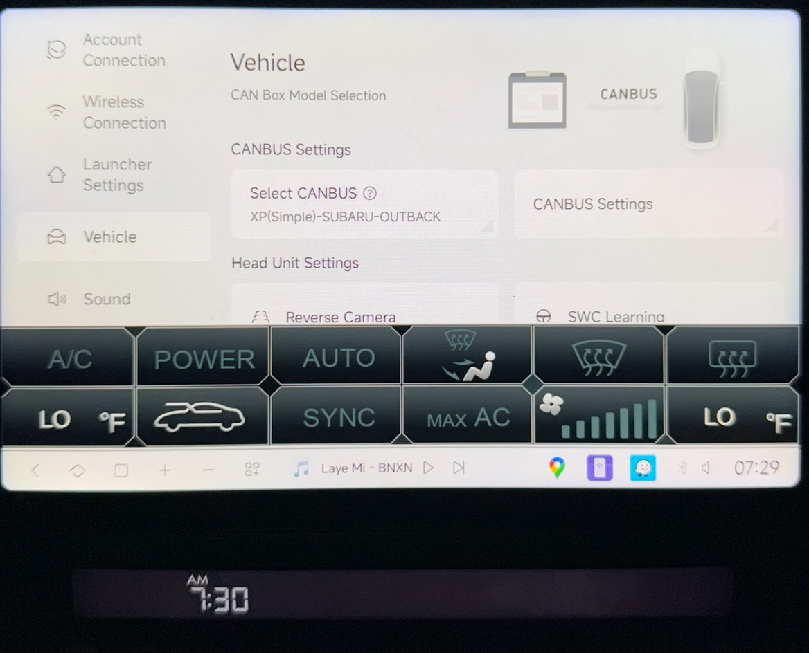

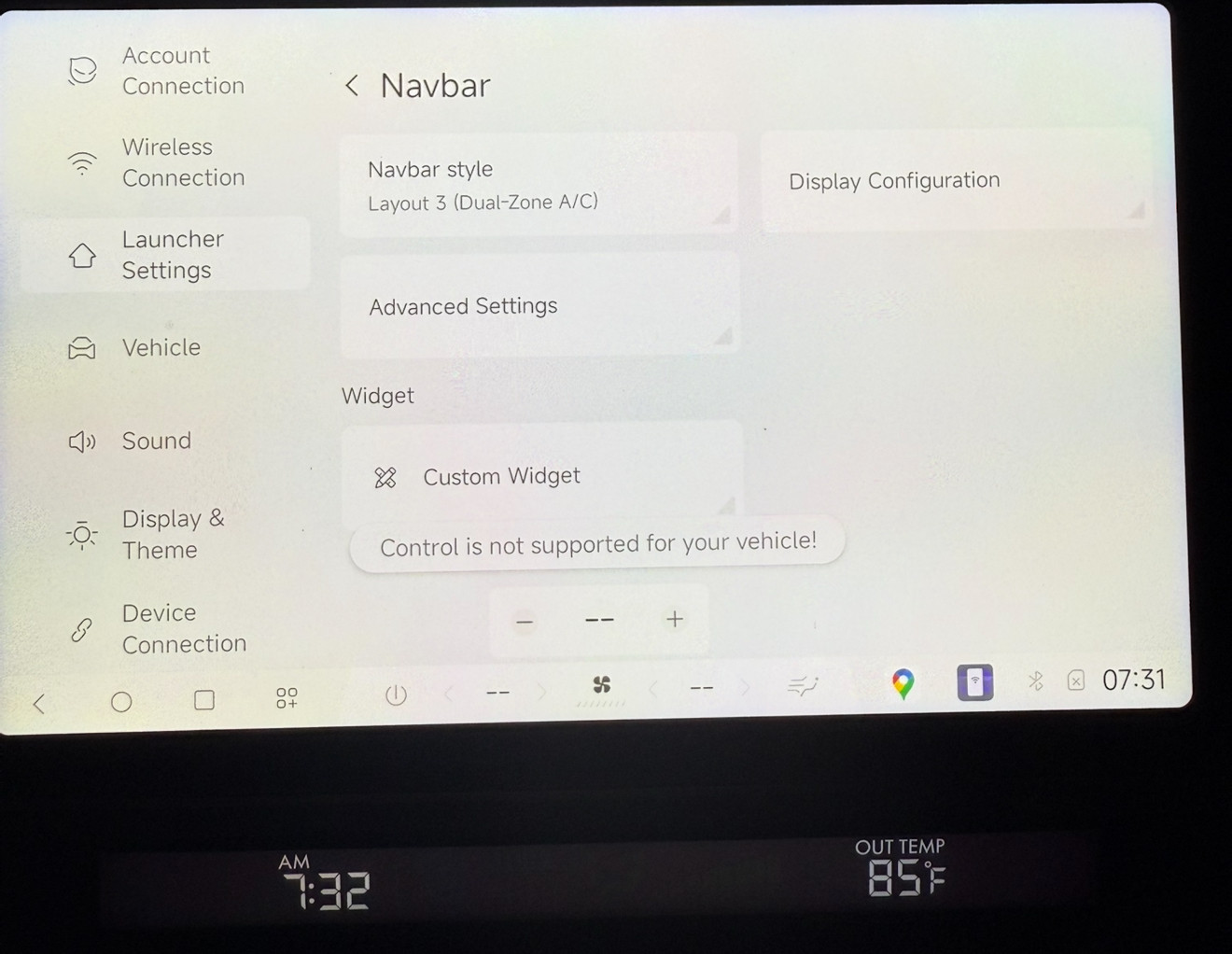

Nafichisom HVAC control only shows when I select canbus and never again, hvac control in launcher not supported.

DUDU-Meng Nafichisom Your Subaru model is not yet compatible with the new air conditioning interface, so the navigation bar cannot control the air conditioning.
DUDU-Meng Nafichisom Traditionally, it should be possible. When you adjust or turn on the air conditioner, the air conditioner panel will pop up.
dudu-lai Nafichisom Download the Touchscreen Assistant app from the App Store to control your air conditioner. Air conditioner control requires OEM screen support.
