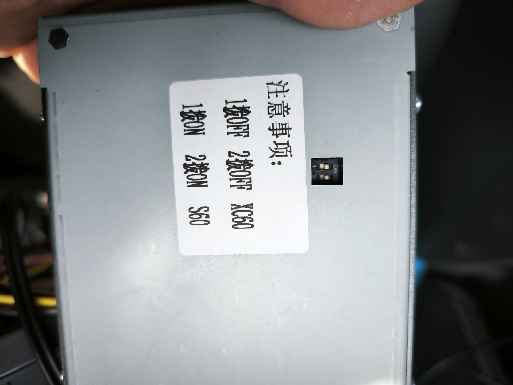

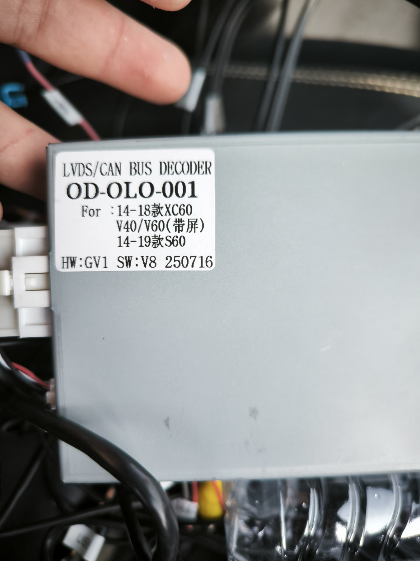

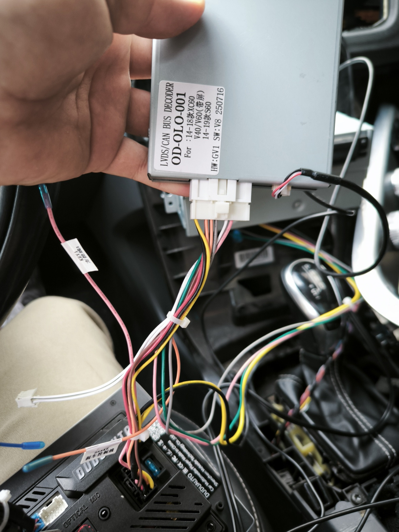

Do the parking sensors work? (display on the screen and sound)? -- It depends on the CANBUS box, if it is not suitable for the CANBUS of your car, these malfunctions will occur
--- Yes, the sensors work, there is sound from them, there is no visualization of the DUDU media (or there is when you request it) The CANBUS box is provided by DUDU for the car model

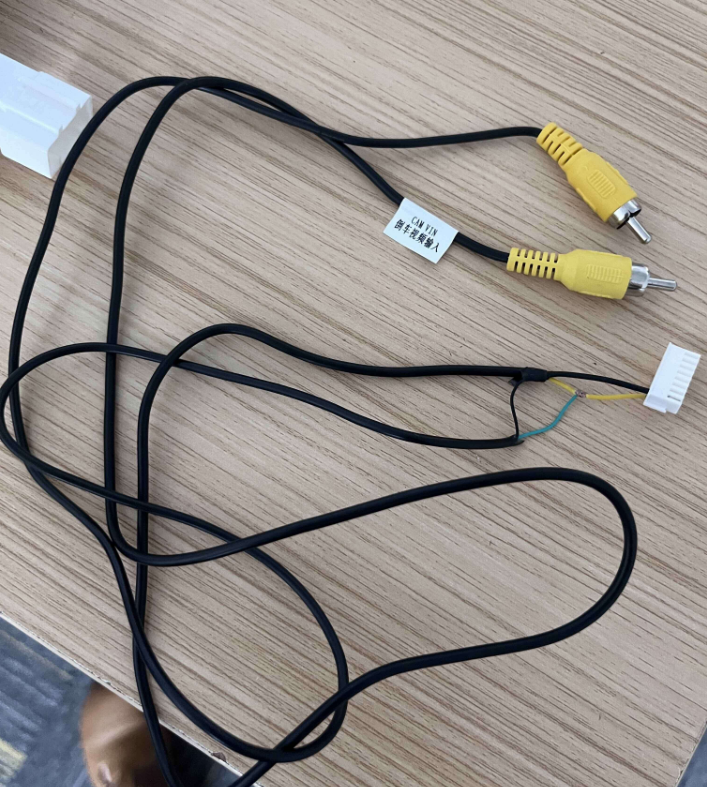

Does the reversing camera work? -- Compatible with original car cameras (correct CANBUS box and wiring harness) and third-party cameras, not necessarily with DUDU cameras
---- The camera works on the original display, on DUDU the media does not recognize it at all. Canbus is provided by DUDU for the respective car model.
DUDU told me that the media will not work with 3rd-party cameras

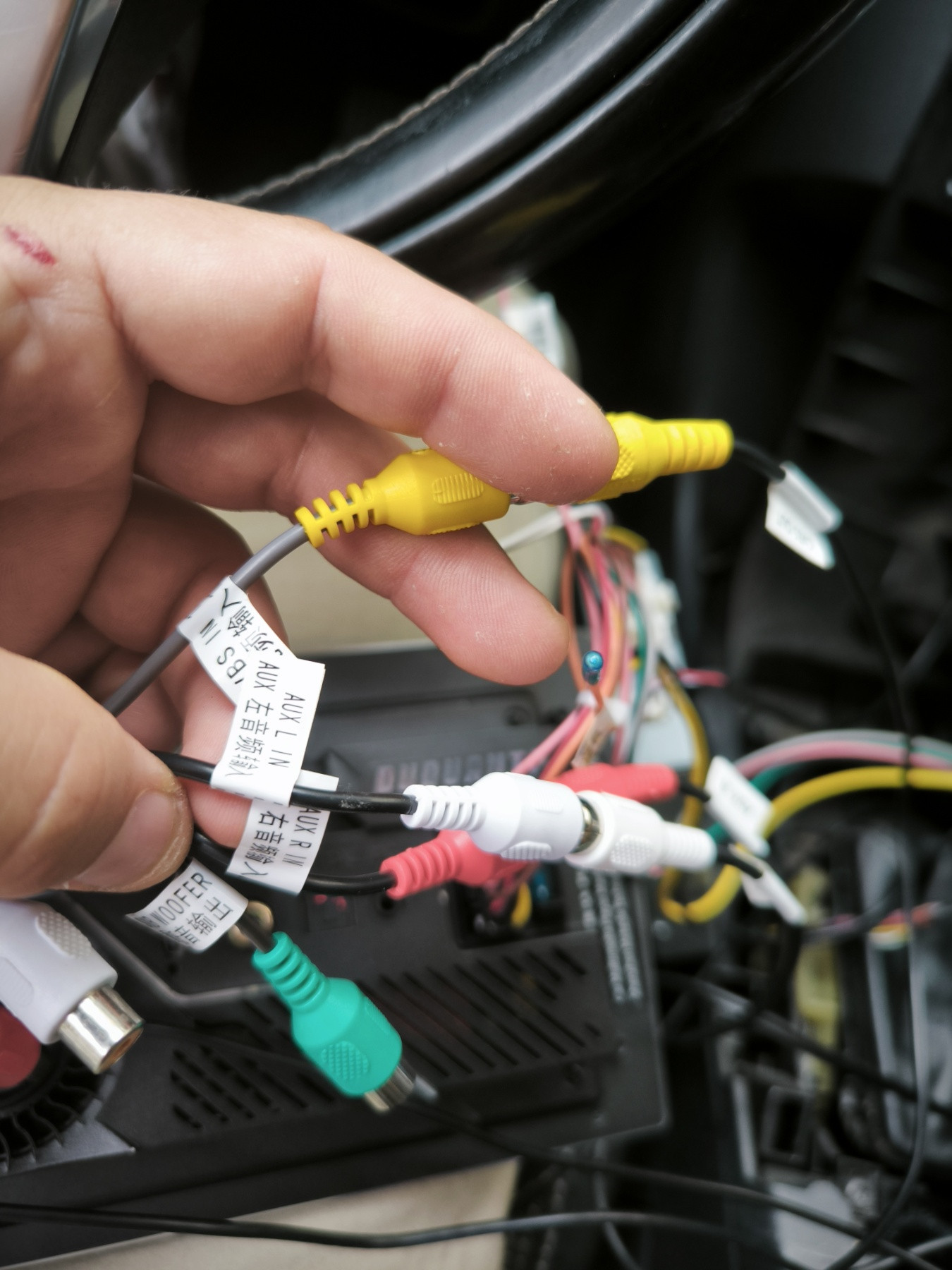

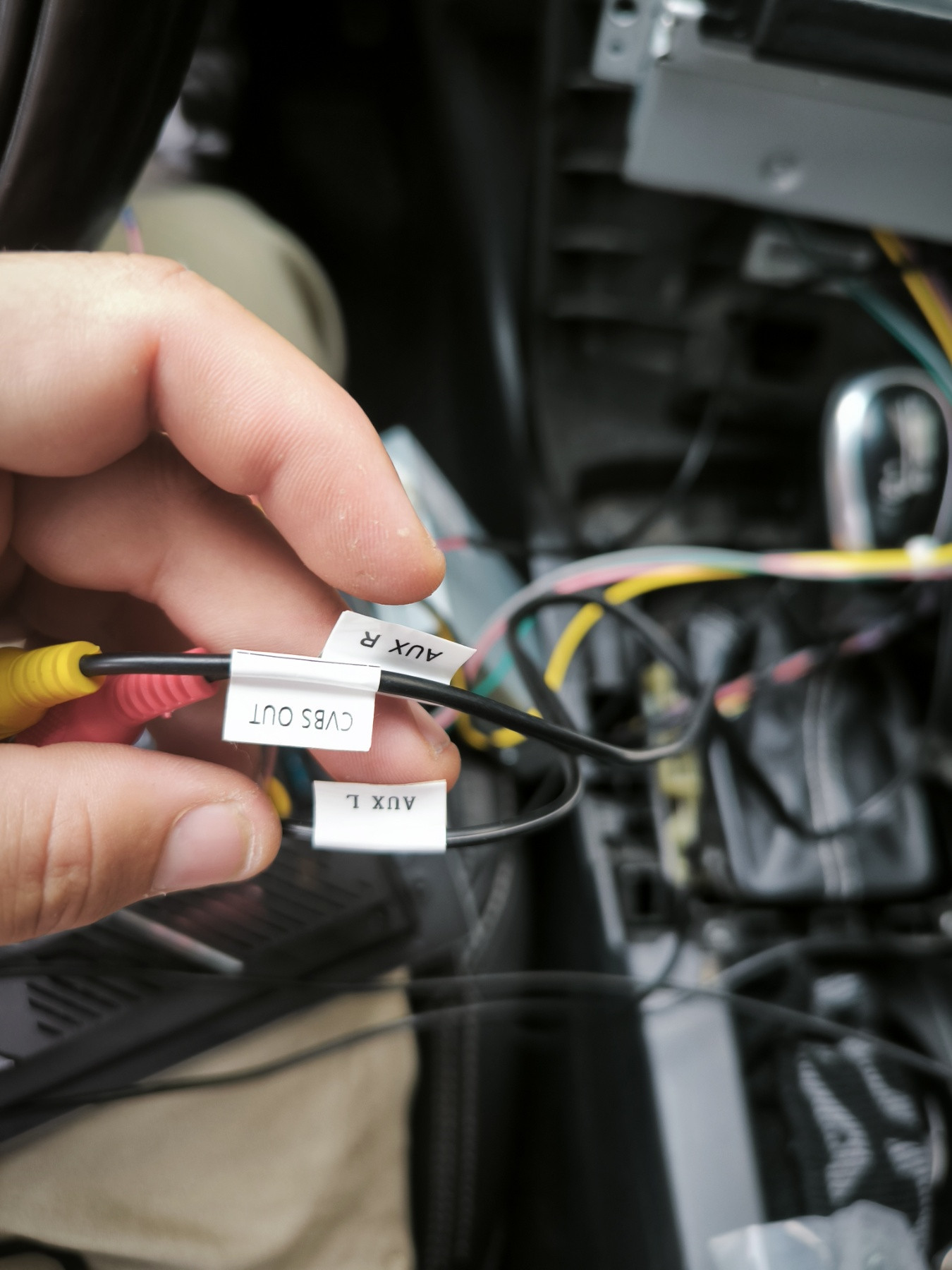

Do the MyCar functions work? -- The CANBUS box analyzes the original video signal, and the RaiseCANBUS box analyzes the AHD video signal, which is clearer.
---- When I am in AUX mode, it shows a picture from the original media, on the DUDU media, the steering wheel buttons for increasing/decreasing the volume and changing songs work, the buttons on the center console also work, for increasing/decreasing and changing songs

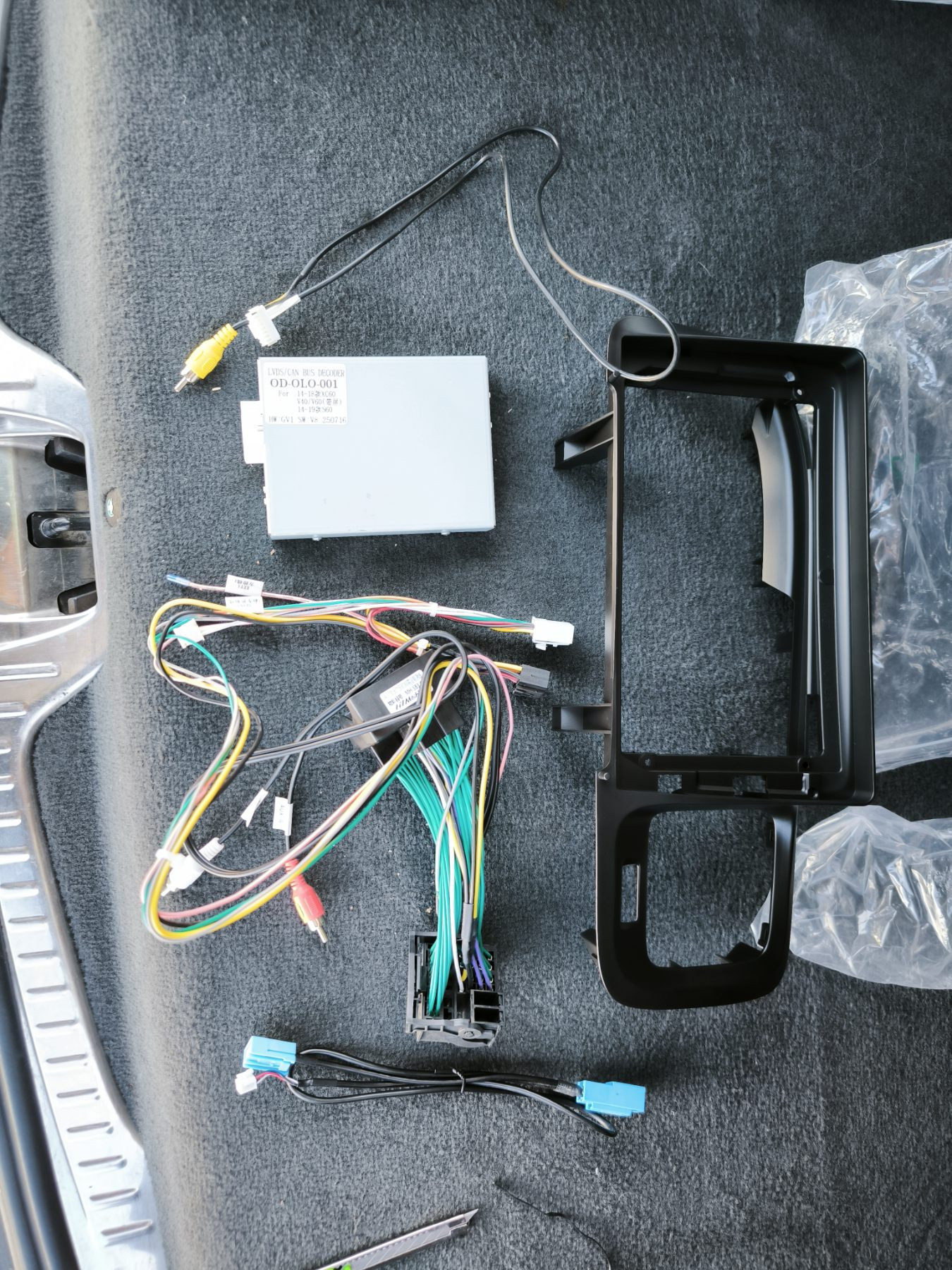

The frame that they send with the device does not fit the device, you have to cut it to mount it -- Requires 1DIN bracket installation. Cutting the frame is incorrect installation
---- You can see the clip attached above, this is a DUDU error, without cutting you cannot attach the media to the frame, 1DIN bracket installation is not possible
The problems they mention with the canbus box should be known to DUDU, it is not acceptable to force users to change canbus boxes because DUDU does not check whether they work for the given car model (the canbus box is not very cheap for us to play trial/error)
