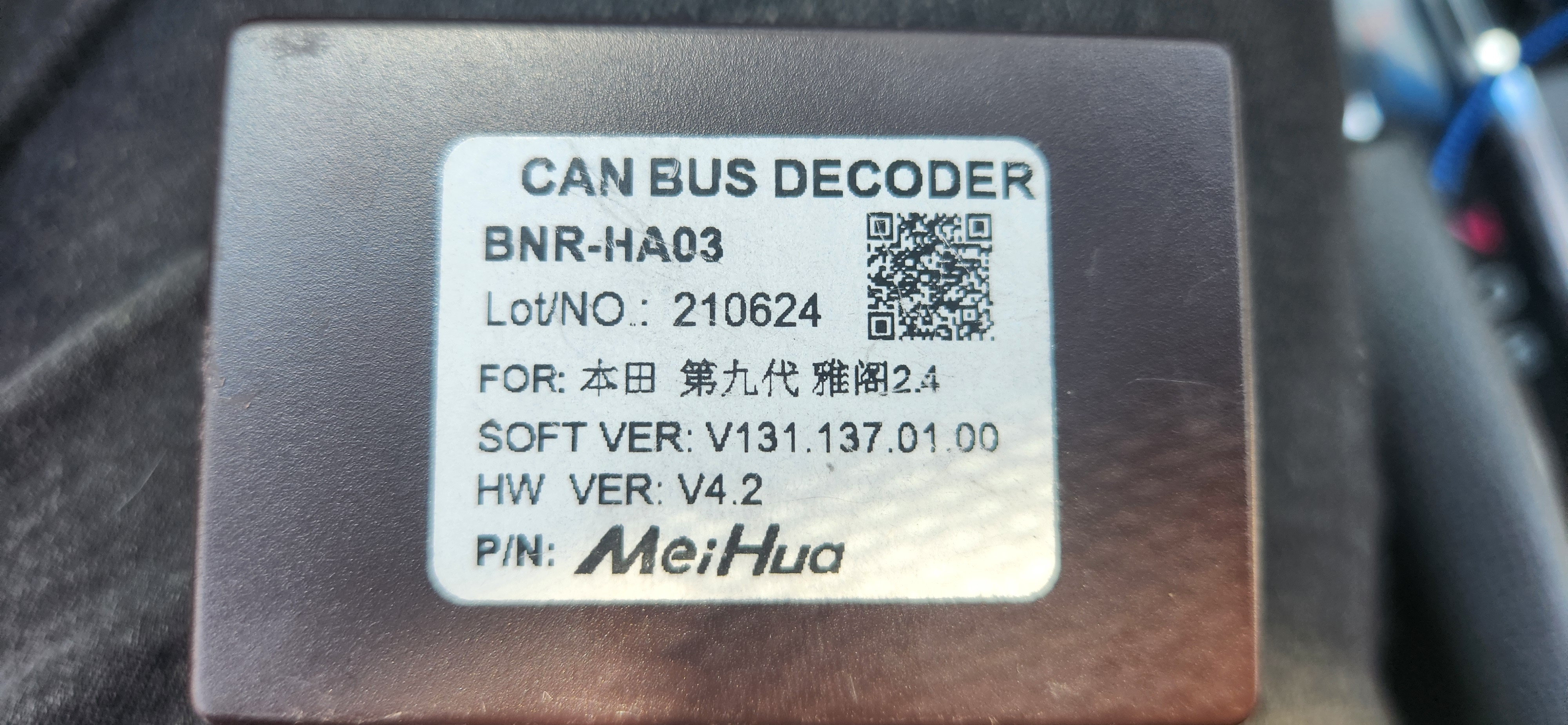

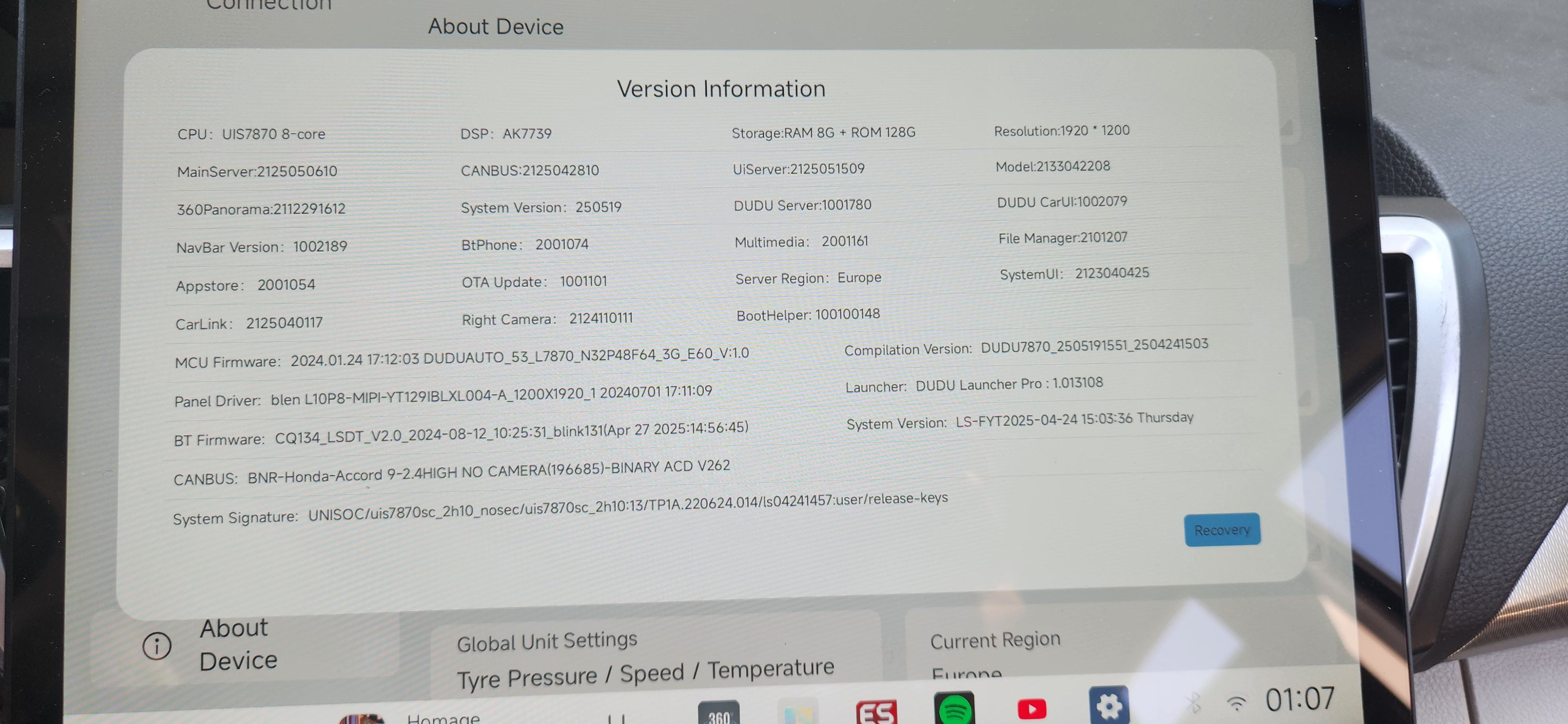

Niche 【1】None of the canbus functionality seems to be working tested steering wheel controls and vehicle settings. Canbus module is from BNR and other info list below. 【2】2014 Honda Accord Plug In 【3】3: To provide system information Log data: file-2025-08-14.txt10kB Canbus video: https://1drv.ms/v/c/bdad20183a12ca37/EXY_bbbaoppFiSnq3YDF_QUB-xW1uta5utZoo-TbgwjcBQ

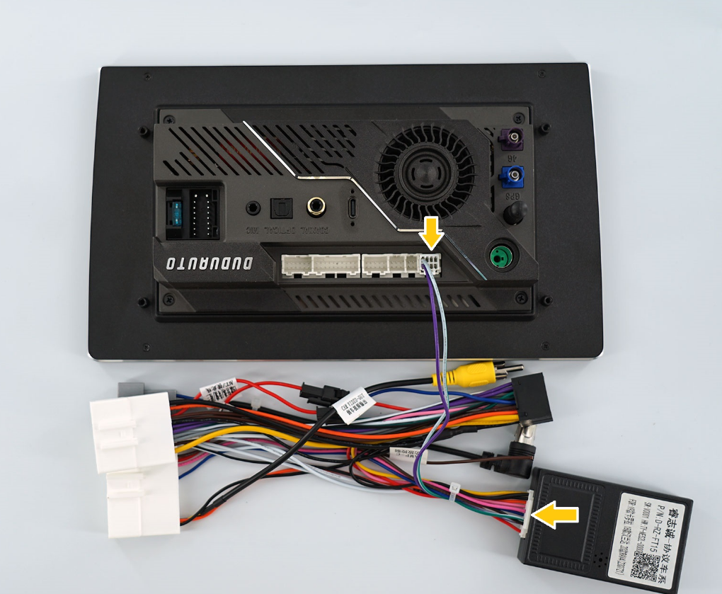

dudu-lai Niche I can't play or download the video you uploaded. Sorry. For a BNR CANBUS box, you can try selecting raise-Honda-Accord9-High. Also, please check that the CANBUS serial port is connected.
