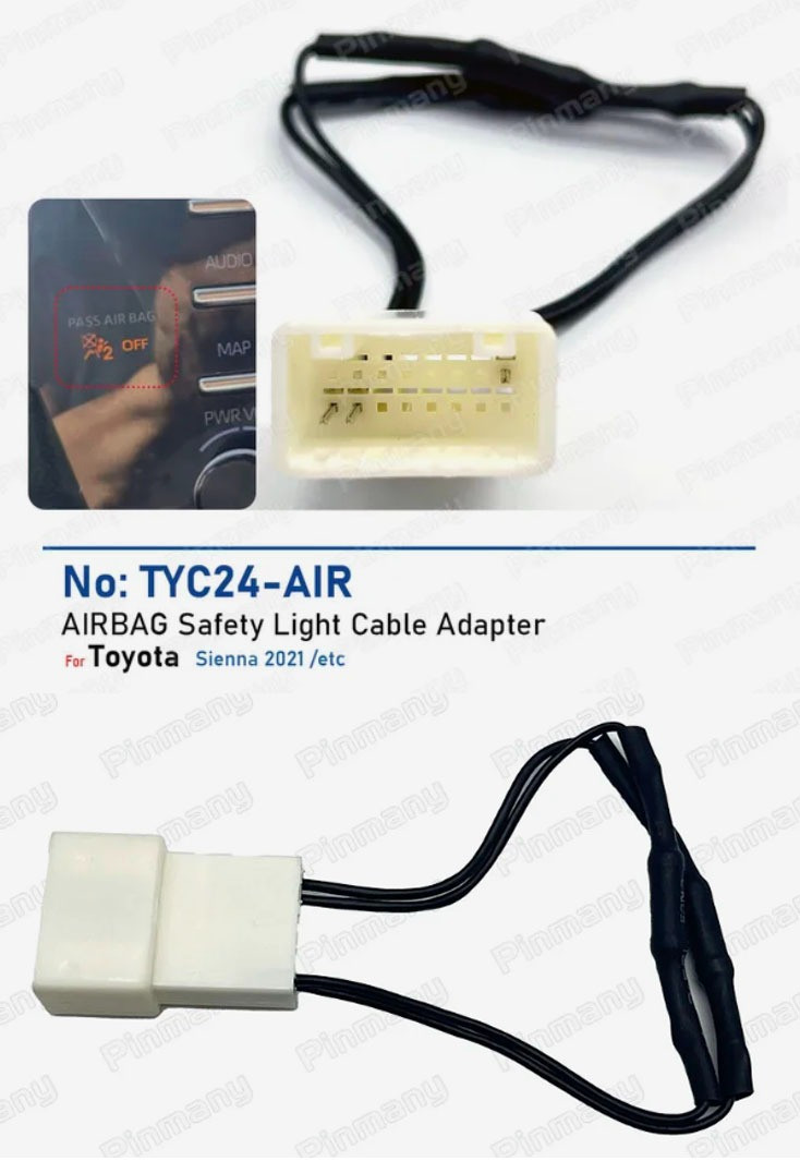

When I ordered the DUDU7 for my 2025 Toyota Sienna XLE, a small adapter was included in the shipment from Mekede to help satisfy the passenger airbag safety check so that you don't get a warning light on the dash. However, I'm pretty sure I get a connector mismatch, possibly because the vehicle is new and there was a change in Toyota hardware. I'm wondering if anyone either:
Was able to find a way to suppress the passenger airbag warning in a 2025 Toyota Sienna using a different adapter. (If so, I would truly love to see photos or a part number or web link.)
Also has this rectangular 16-pin adapter and was able to use it. (If so, could you confirm what model and year of your vehicle?)
Thanks for any help. So far I haven't been able to get any help about this from DUDUAUTO support, and they encouraged me to write in this forum instead. If I could at least get a pin-out of the factory cable (and ideally the external adapter as well), maybe I could figure out how to build my own adapter if needed.
