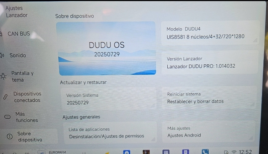

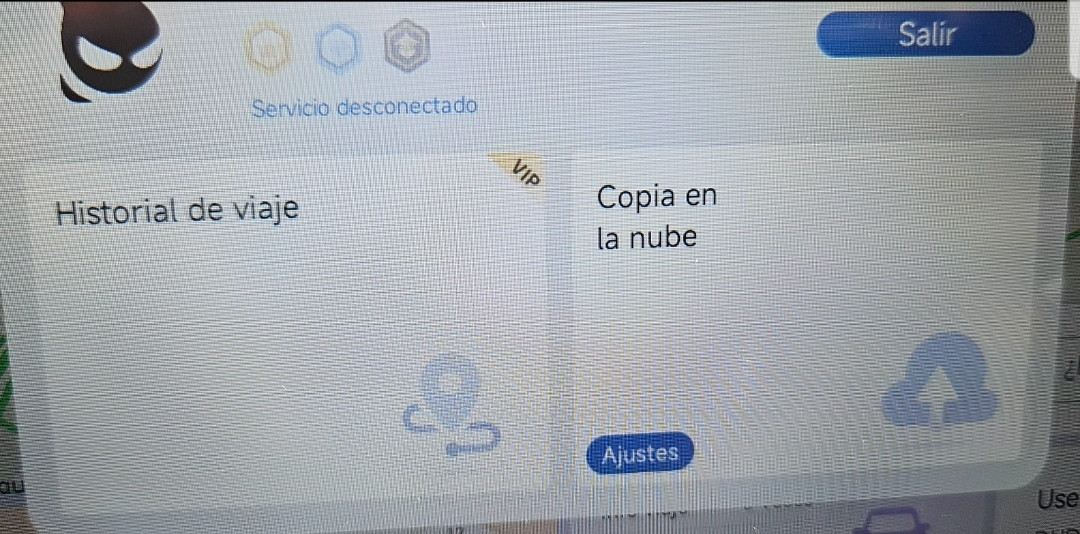

Ctorrejon I bought Duduauto 4 radio less than a year ago. The server I use is Europe. Why does it say disconnected service? How can I fix it? Thank you.
Popescu Ctorrejon Hello! Try to change language în English on android settings and see if stay connected. My language was romanian and after I change to English it was ok. Is something about language.
DUDU-Meng Ctorrejon This is a known bug. This is a known bug. We are currently investigating the cause. In the meantime, you can use English as a temporary workaround.
DUDU-Meng This issue has been fixed. Please install the latest desktop app to test this issue. Thank you. https://drive.google.com/open?id=1o1Dgi8SeCFNCir4SWV_EBplr4WazQ3Nz&usp=drive_fs
