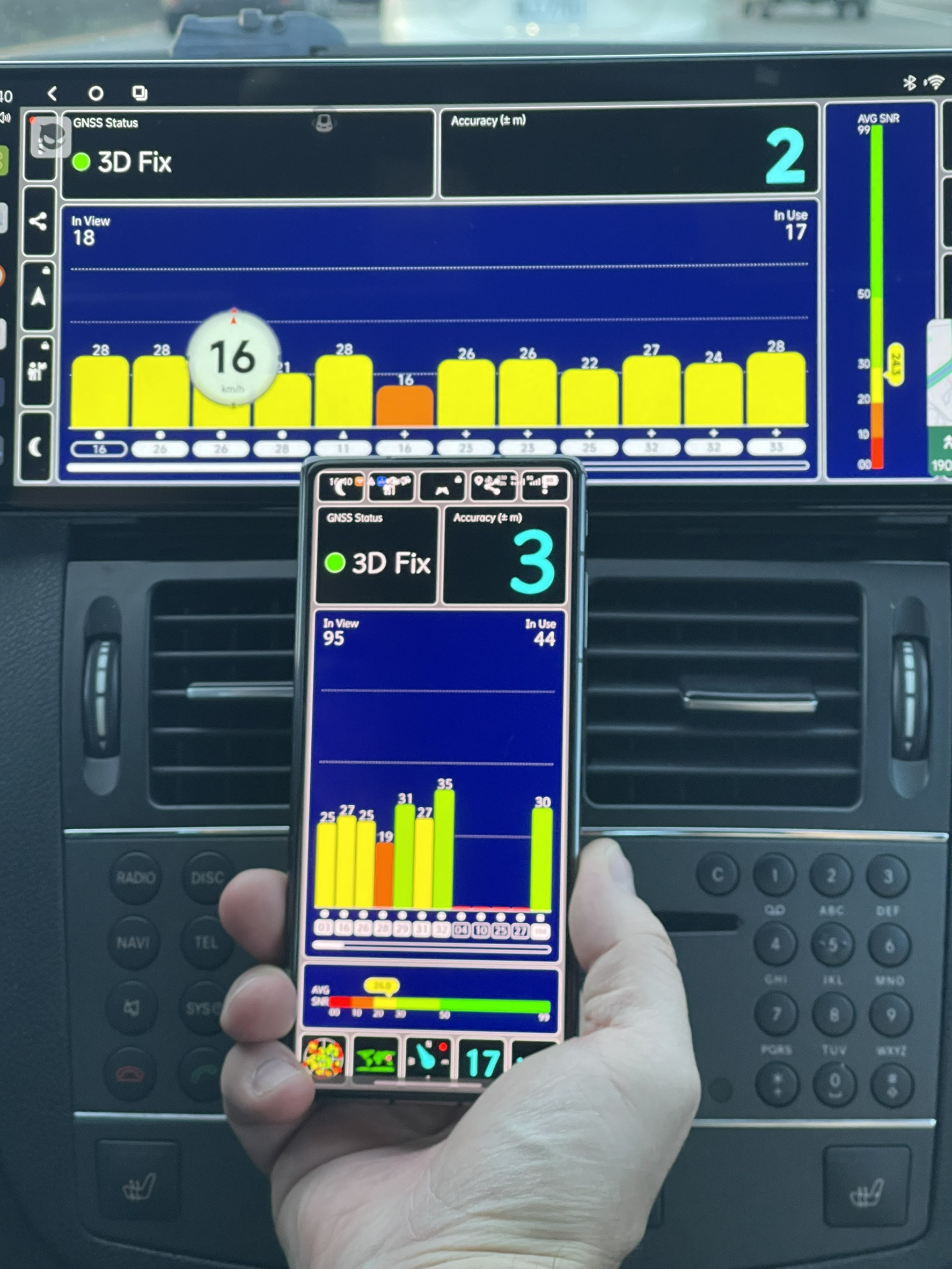

Please check the number of satellites and signal strength with GPStest.

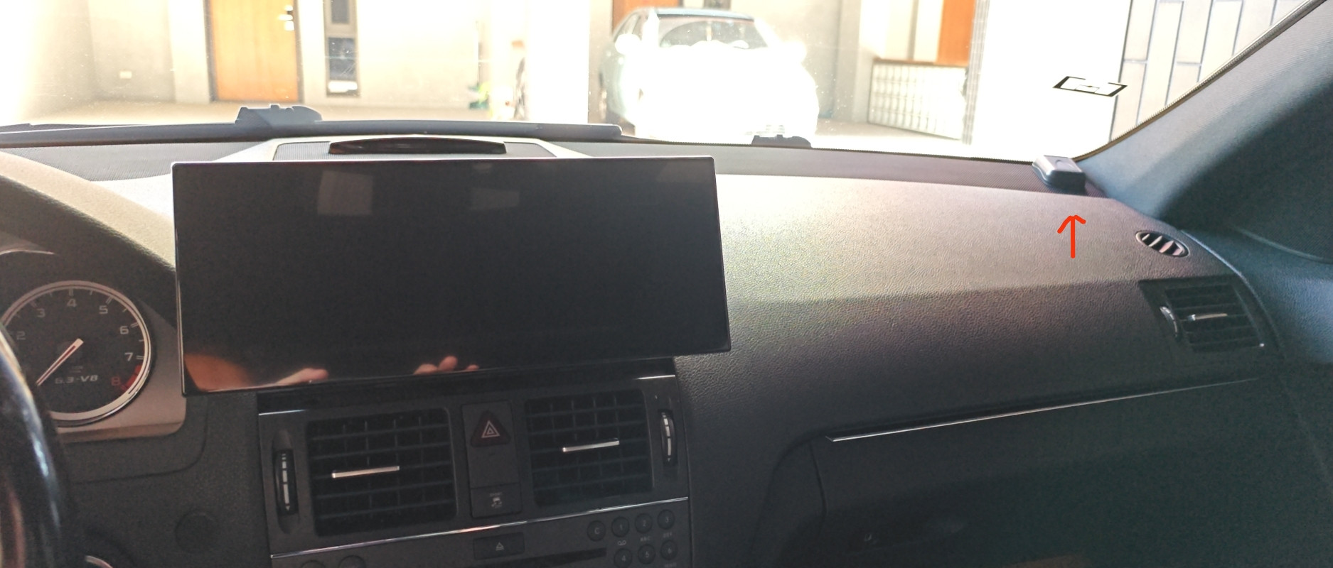

I have tried removing the GPS antenna and reinstalling it many times or changing the installation location but nothing has changed.

MrDuaGang Can you install the app GPSTest? It would be interesting to see how many satellites are seen - or not. You may only be seeing Google Location Accuracy information.
https://play.google.com/store/apps/details?id=com.android.gpstest
Segundo this might explain why they recommend the antennas be located bottom right corner of dash instead of up my rear view mirror. I found this thread looking for placement comments.
Is there any other information related to best practice for antena placement?
I also have an issue with the GPS. I installed the antenna at the bottom right of the windshield as recommended. My phone can lock 90 satellites in seconds using GPSTEST, whereas it takes up to a minute for DUDU7 to lock in about 15 satellites maximum. This is a big problem when in the city, because the GPS loses signal for 5-10 seconds frequently.
