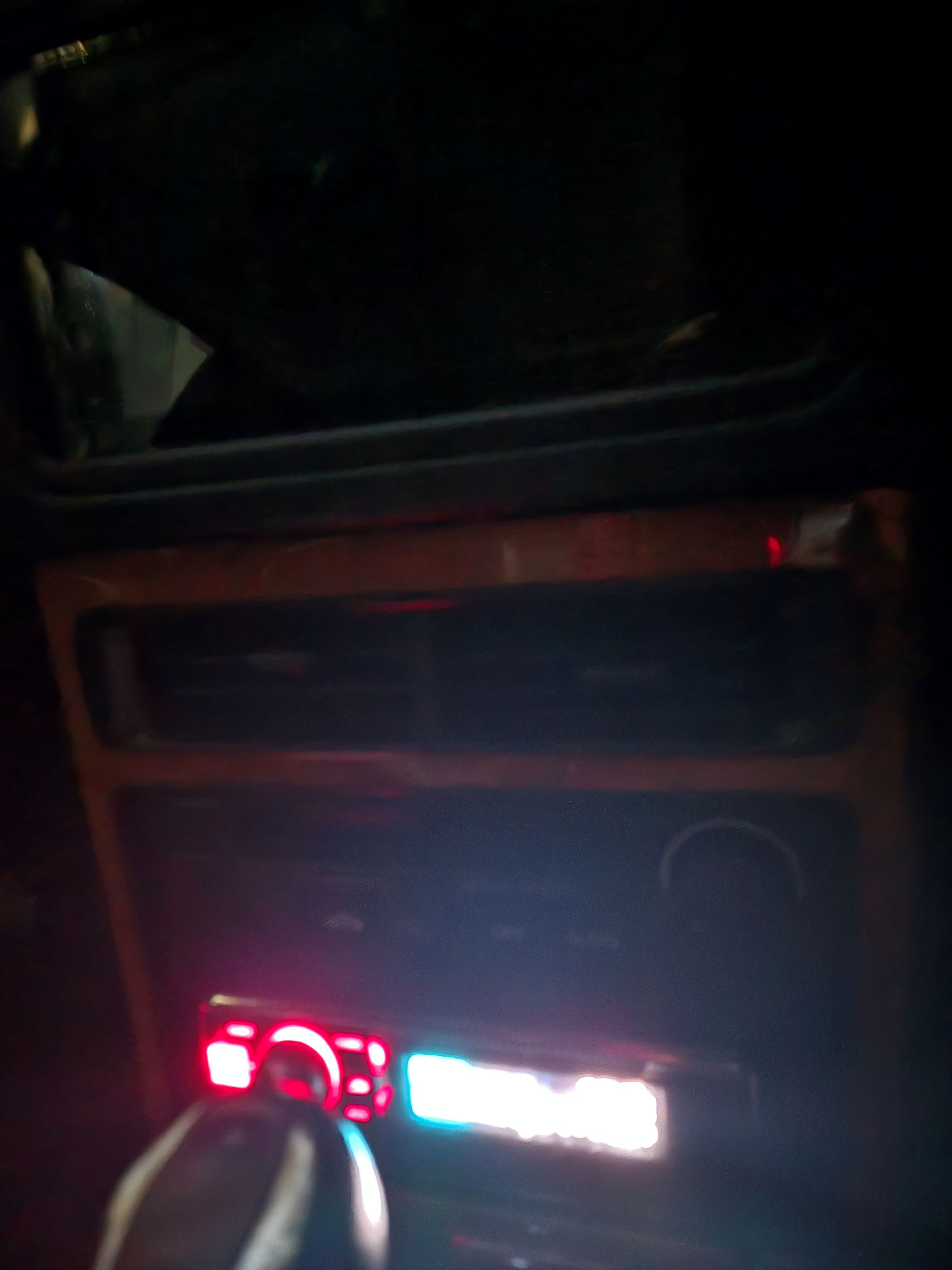

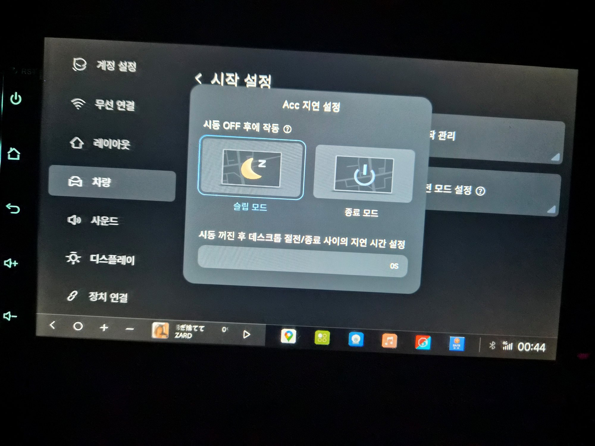

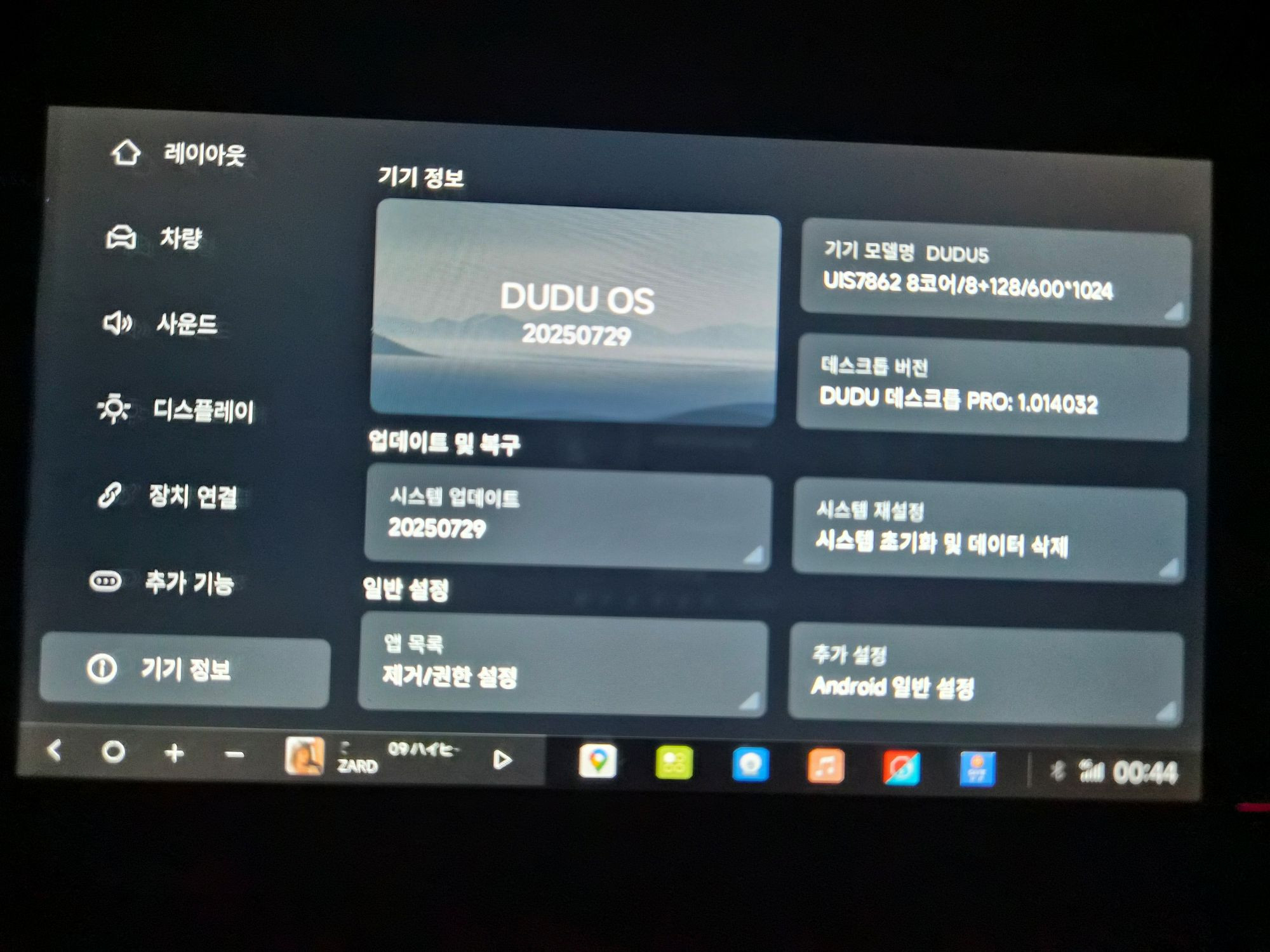

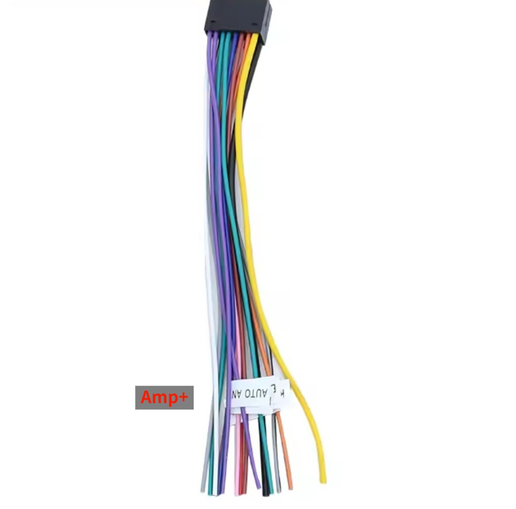

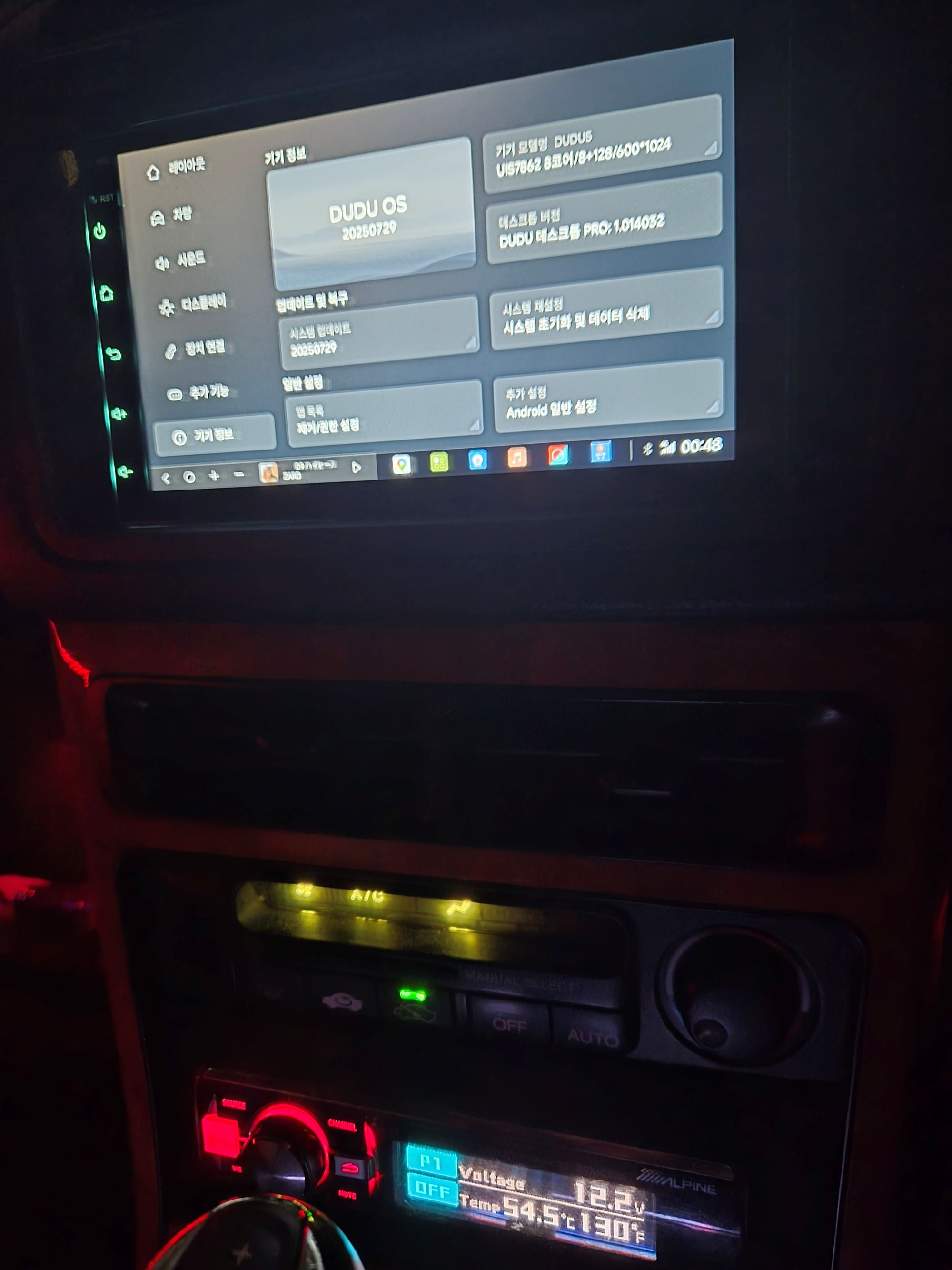

legend1104 acc를 끈 후 amp+ 외부기기 전원이 차단 되어야 하는대 안대는 상태 입니다. 슬립모드만 차단이 되지 않습니다. 두두os 사용전에는 차단 되었습니다. acc를 끈 후 amp+ 외부기기 오디오 전원 기존 안드로이드os (슬립모드 적용off : 슬립모드 미적용 off ) 두두os (슬립모드 적용amp+ on : 슬립모드 미적용 off )

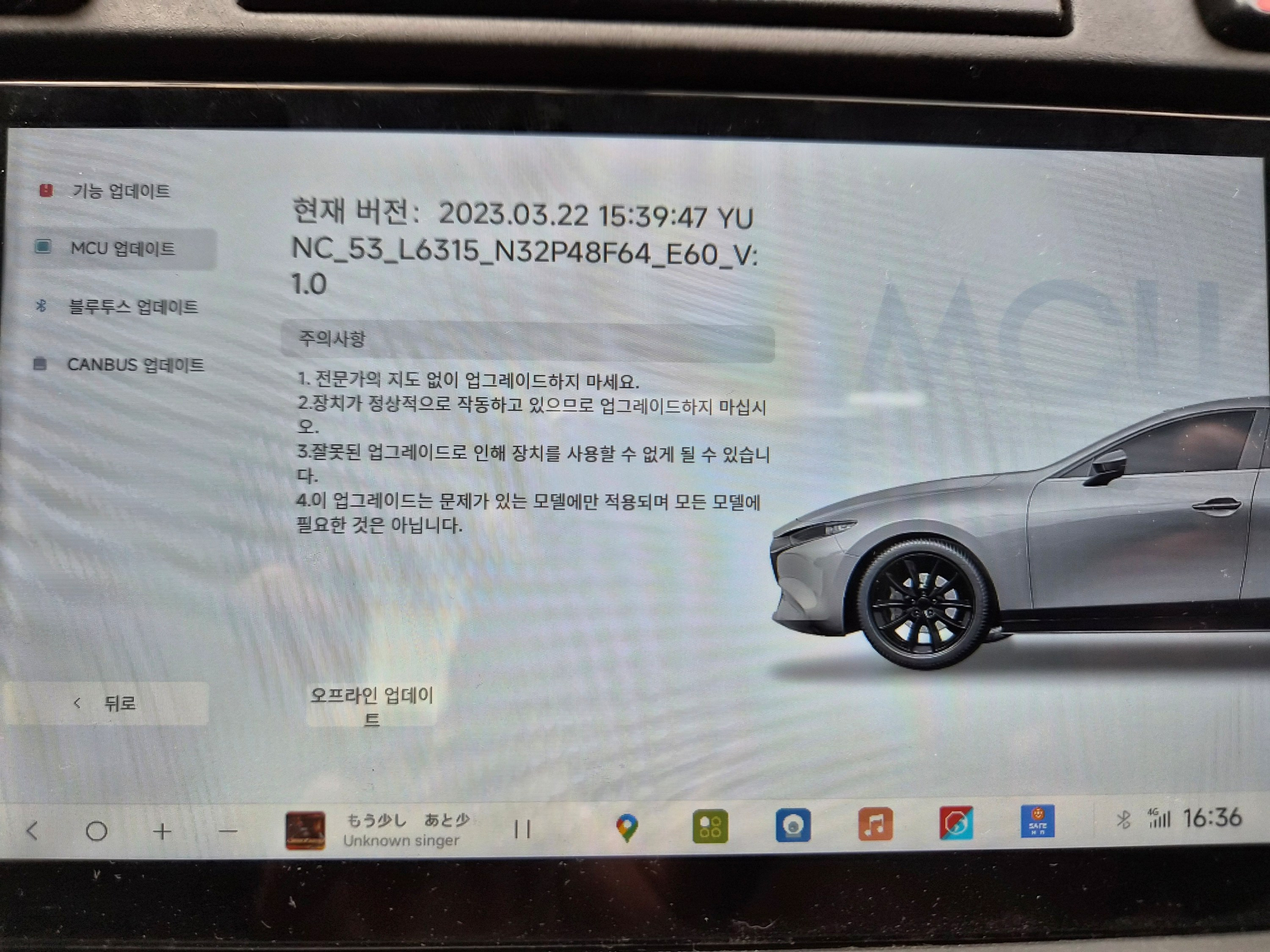

DUDU-Meng legend1104 The external amplifier device is controlled by the MCU. If the external device is still on after you turn off the ACC, please update to the latest MCU. You can press and hold here to take a screenshot of the system information interface that pops up and upload it here.
DUDU-Meng legend1104 The MCU firmware you are using is YUNC. I don't know what it's called, but the issues you mentioned are all set in this MCU firmware. You need to upgrade to a standard MCU without customized private functions to resolve them.
