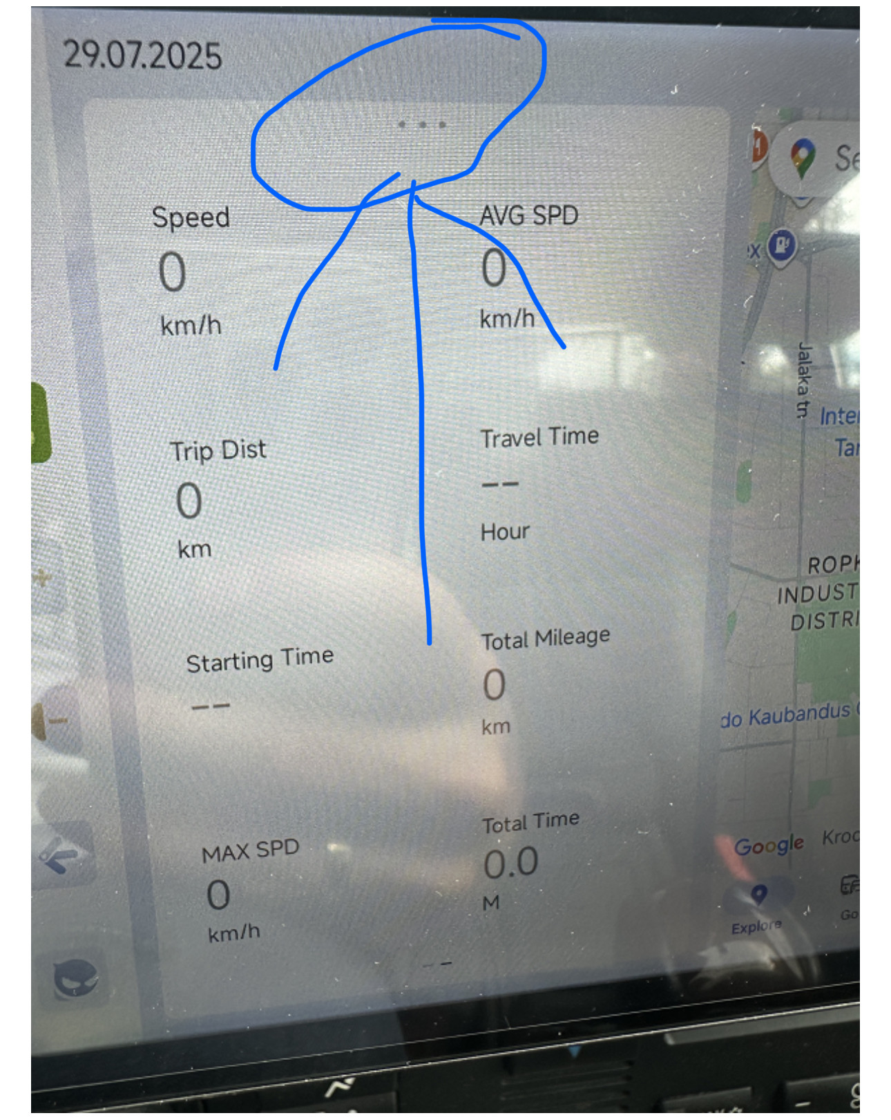

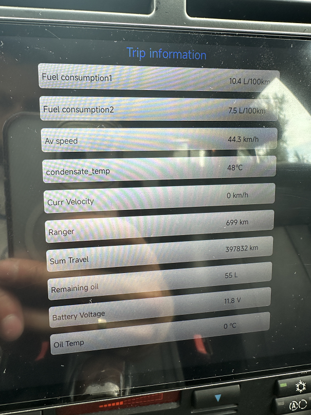

janis Hello, I am using dudu7 with latest beta 250724. Is it possible to add vehicle information to widgets. What i mean, infro from here: And display and interact on widgets like example from here:
MihaiFlorin janis Press those 3 dots and go widget settings. Then you can customize what is displayed by drag and drop
janis Yes i find this. but there are only obd options not any can data. and i do not have obd dongle. but i want to use already existing can data. displaied in vehicle info.

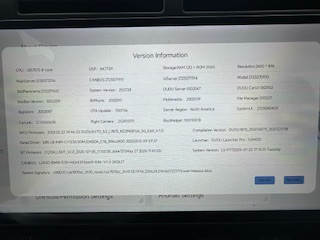

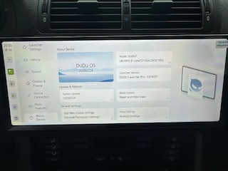

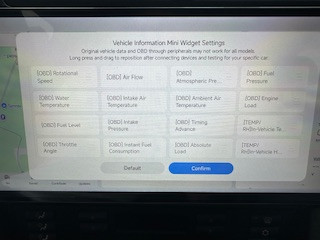

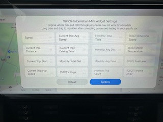

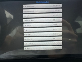

janis Here are my headunit info and car info: I habe bmw e39 And here are the options what i have in widger customisation: And here are the info headunit gets from can: As you can see i cant select not single option what car info i get via can.
janis I know the diferent speed options. but i want to display at least fuel cunsumption 1 and 2 and range from vehicle information. but there are no drag and drop option for these in the widget customisation. Basically i want to achive this:
DUDU-Meng janis If these options are not available in the widget editor, then these features are not implemented. You will need to submit a feature request.
