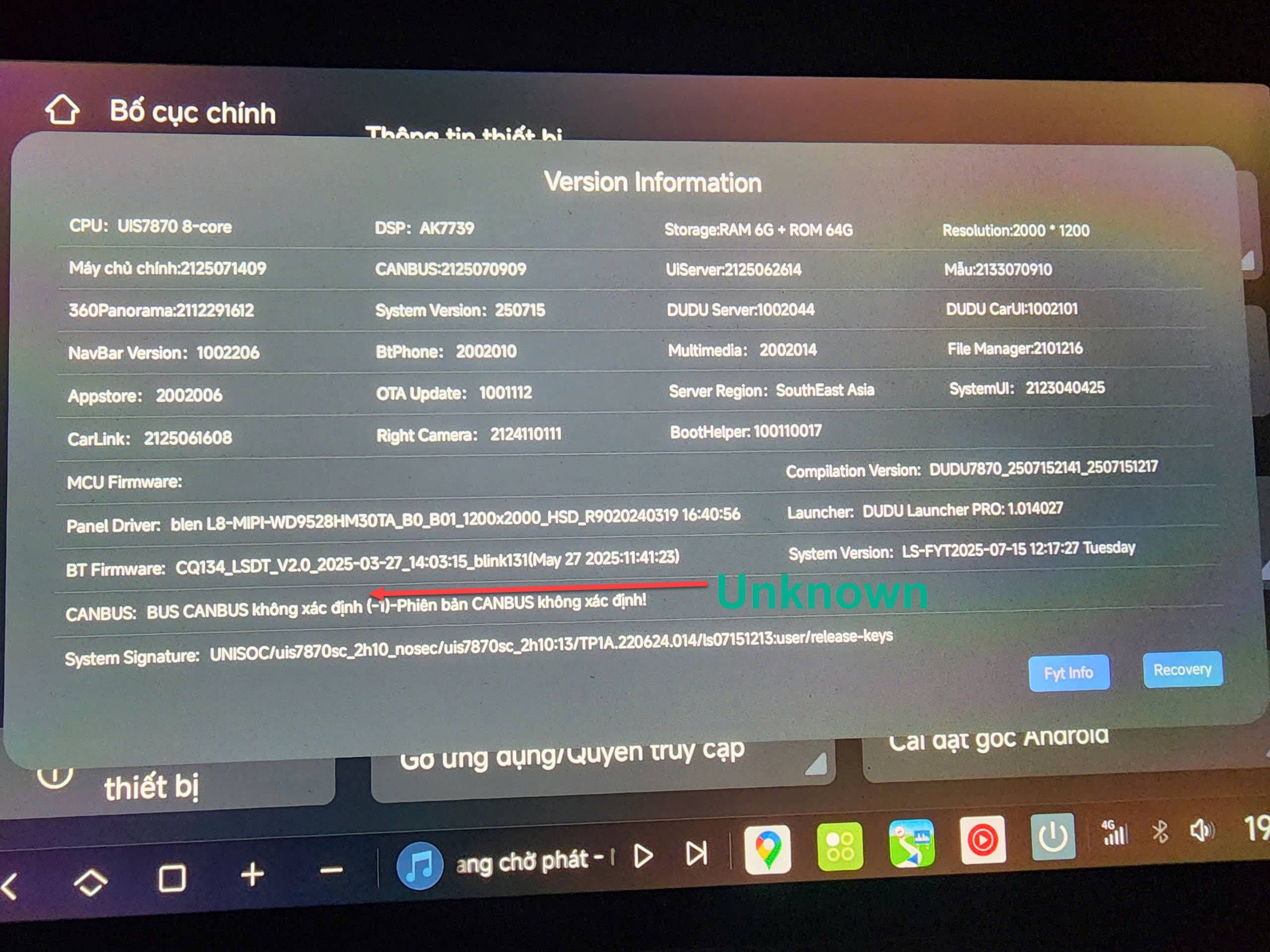

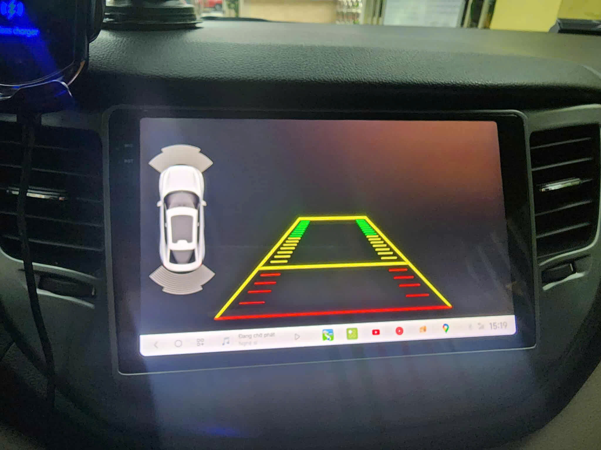

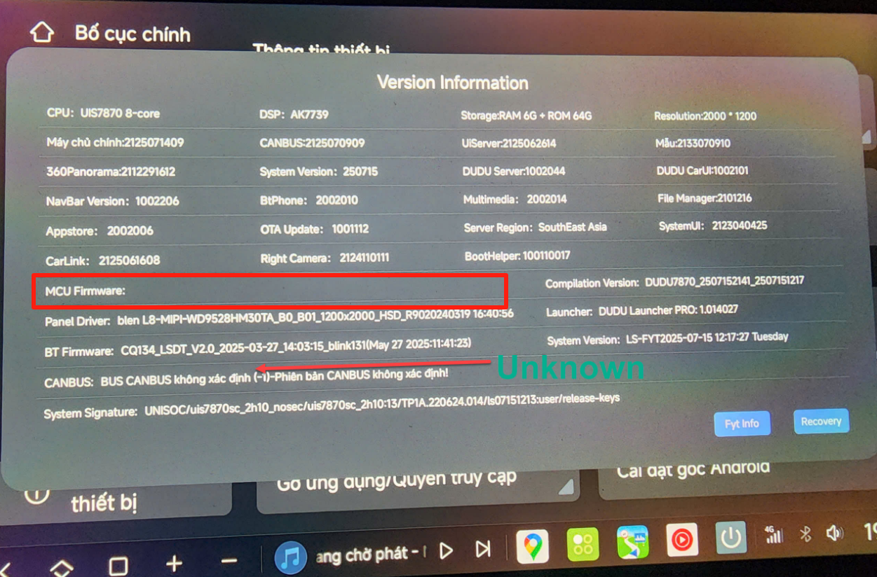

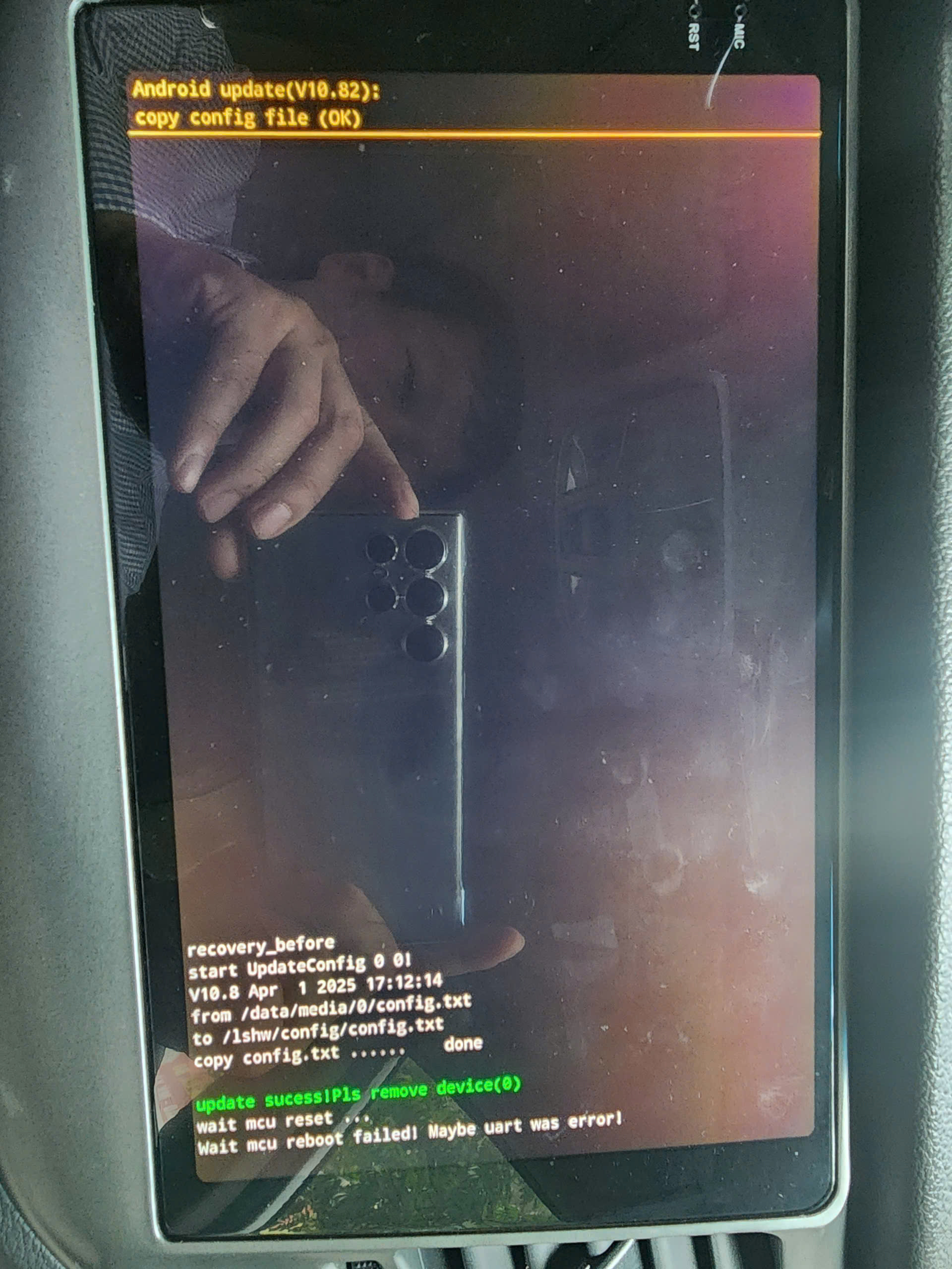

In the “Startup Settings” section → under “Action after power off”, when left at the default setting “Sleep”, every time Dudu boots up, a screen appears showing the camera guide lines and radar sensor display. I have no way to exit this screen. (If I disable the reversing line and radar, the screen goes black and displays the message: “No signal.”) I believe my car does not use Canbus, as shown in the image below.

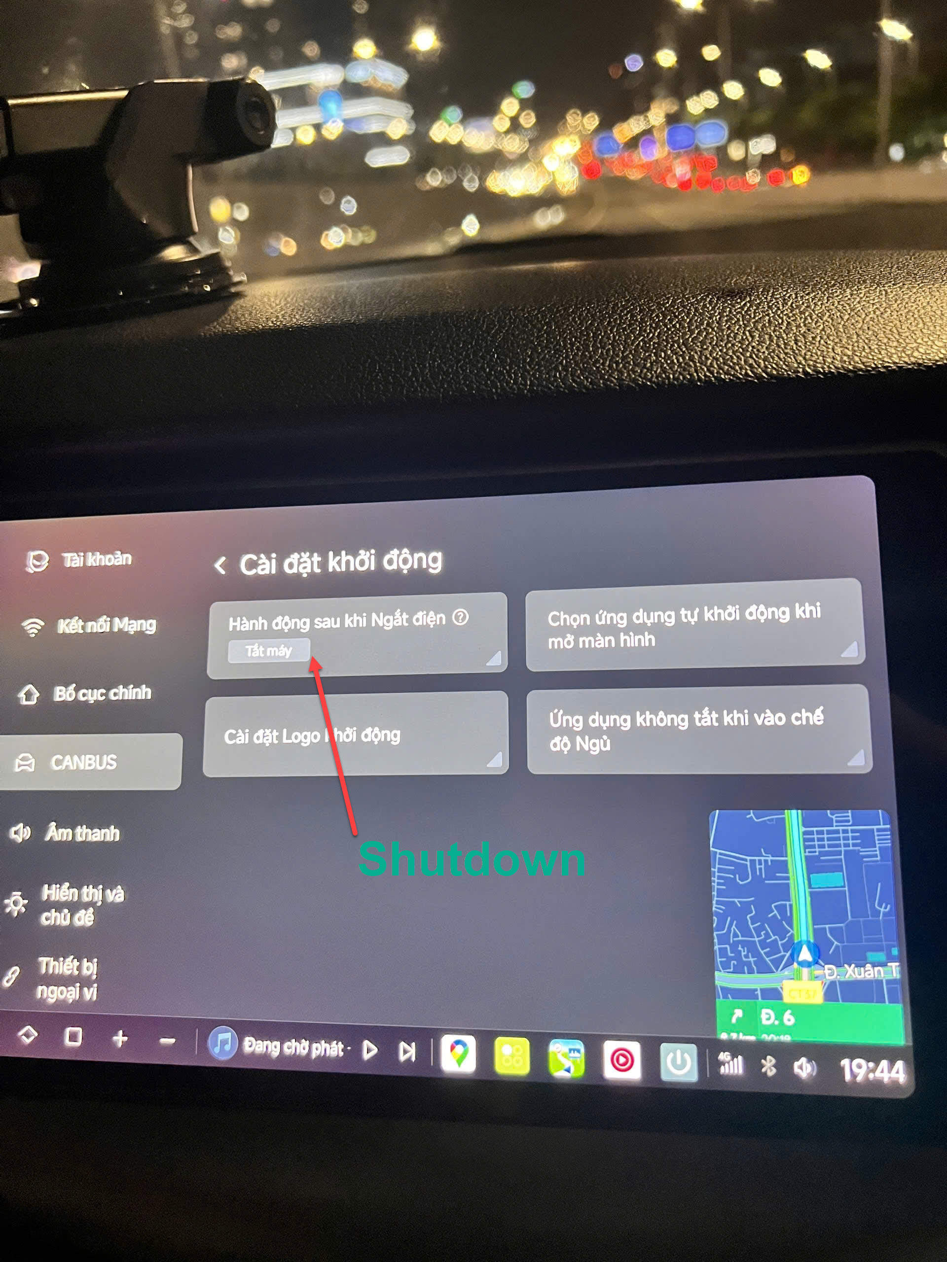

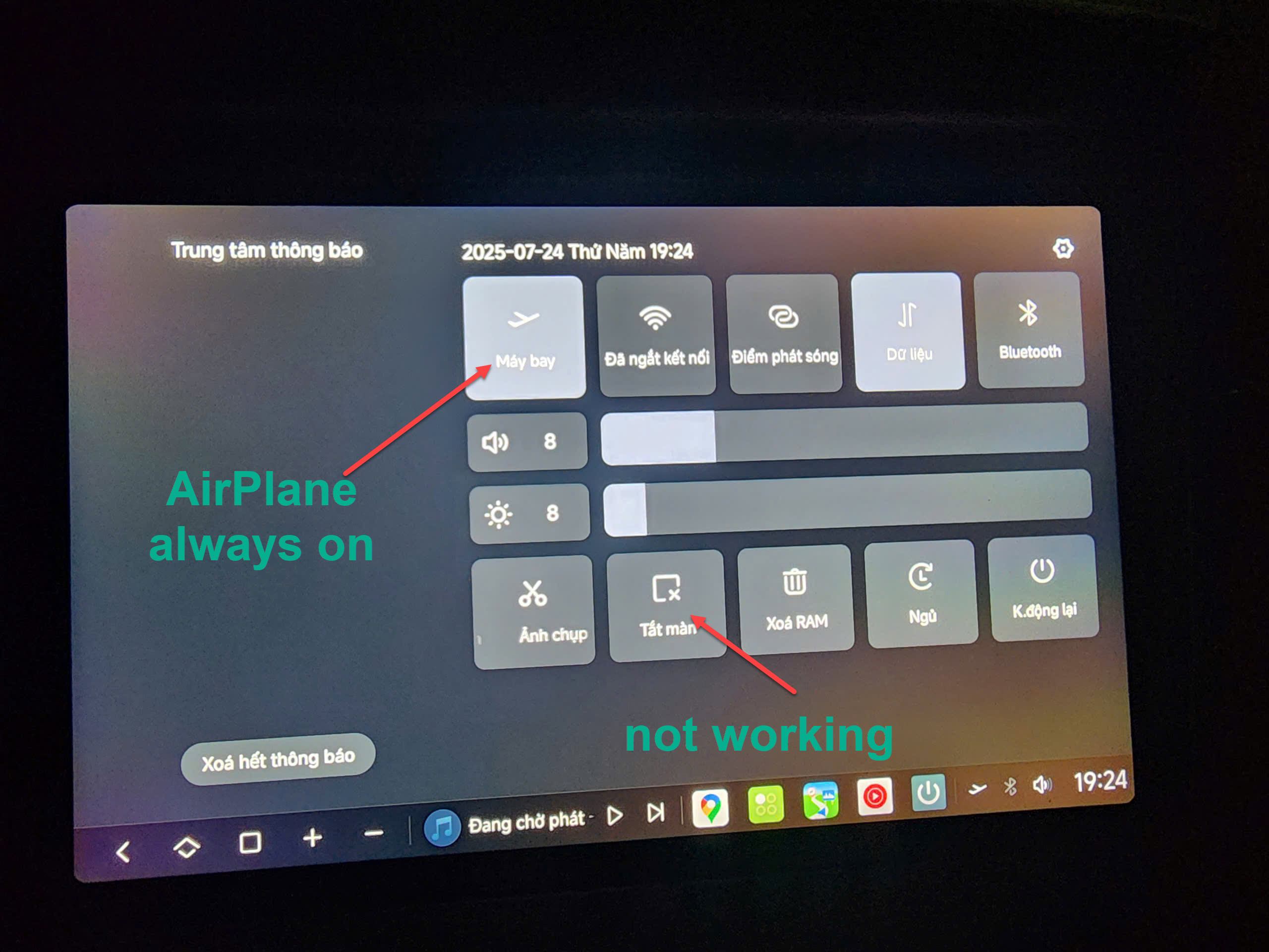

If I change the “Action after power off” to “Shut Down”, then every time Dudu boots, the error screen (with camera lines and radar sensors) does not appear. However, Airplane Mode is always turned on by default, and I have to turn it off manually.
Additionally, the “Turn off screen” button does not work. PIP is left at its default setting.

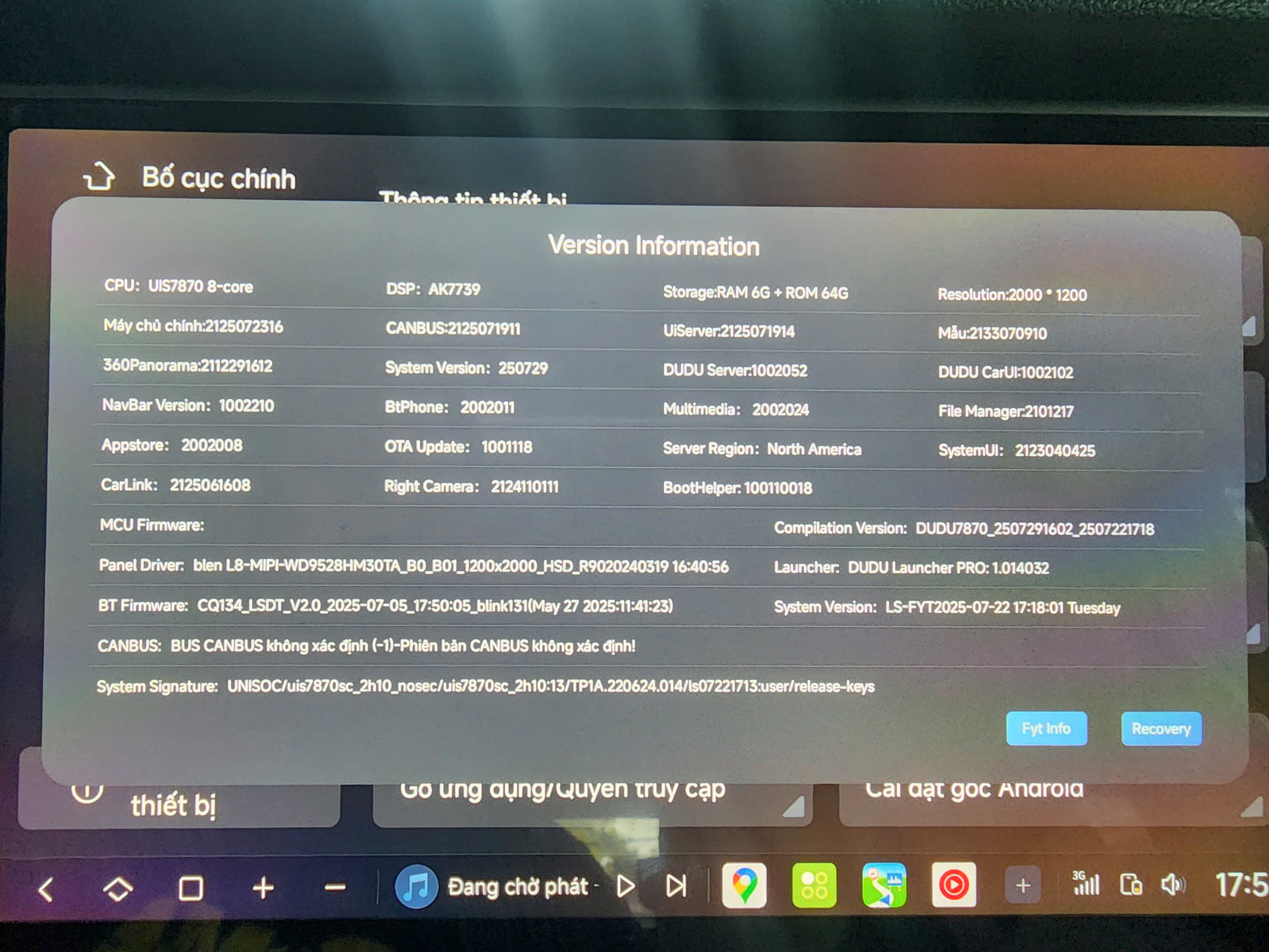

Below is my car information.
