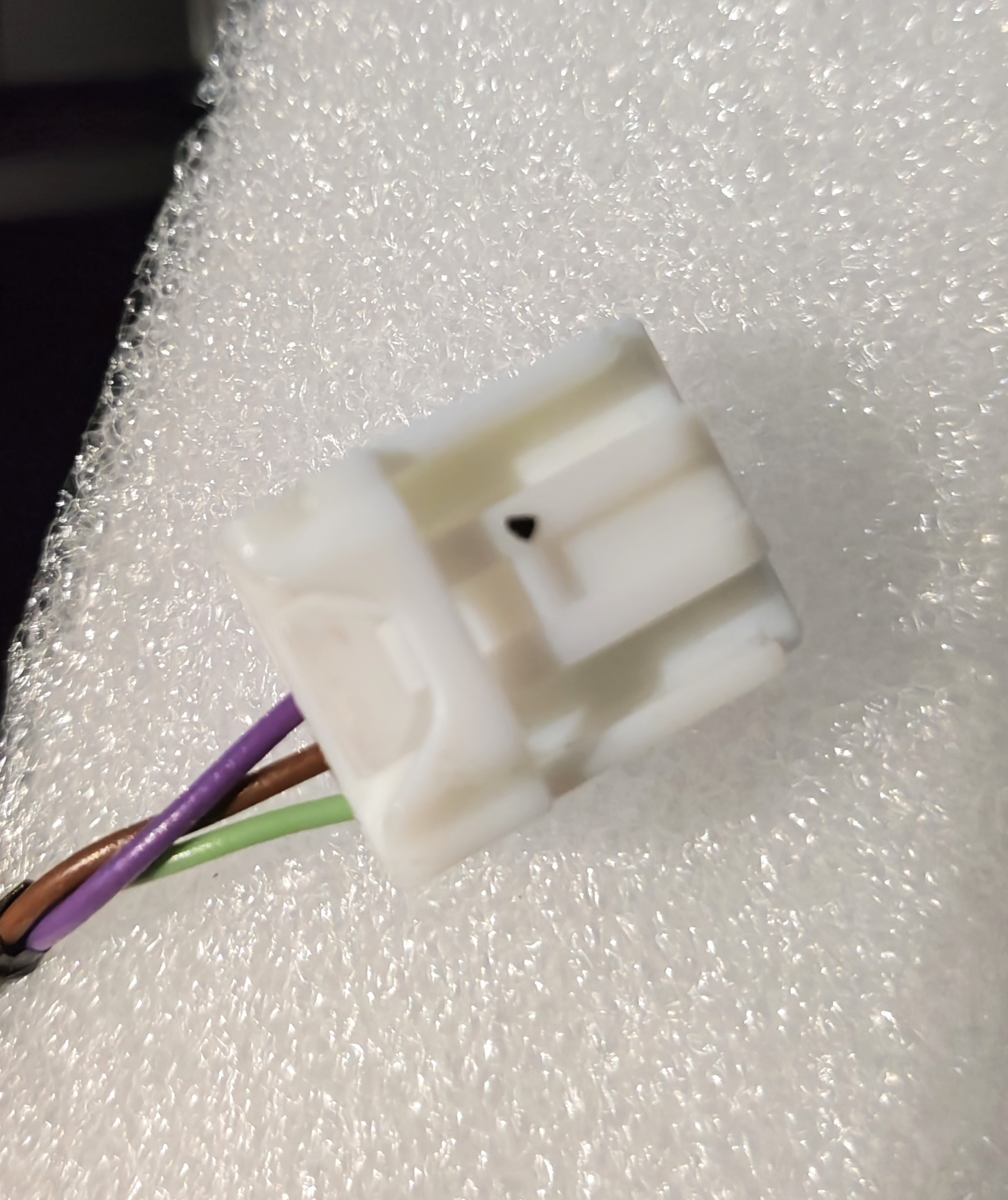

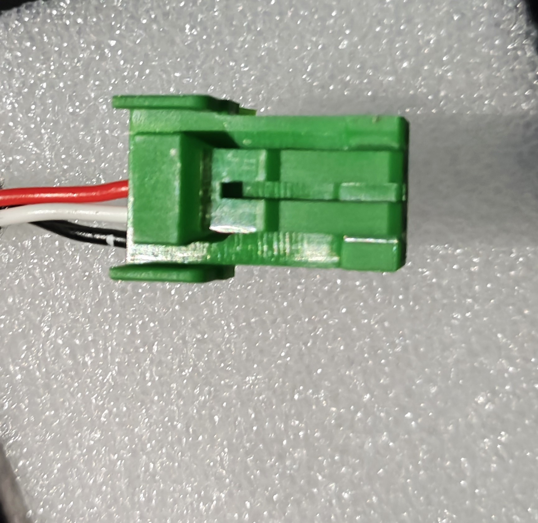

I've got DUDU7 and installed it in Suzuki Swift 3rd Gen, the reverse camera plug is proprietary, not normal RCA plug, you can see from the picture, the green plug has 3 wires, black is Ground, Red is 6V and white is reverse Camera signal. (information from OEM HU sticker).
I tried to use that plug (by using pins) on DUDU7 but no reverse trigger. I added OEM head unit back, put the car in reverse gear, plugged green one, no trigger, plugged on white one and the picture appears, when only using white plug, there's reverse trigger without a picture.
This confirms, the green plug is for Camera and white triggers reverse camera.
How would I connect it to my DUDU7? I can make my own harness for the time being until I buy ready made, please help. I want to retain OEM camera which is clearly labeled as 6V, while DUDU7 has 12v wire.
