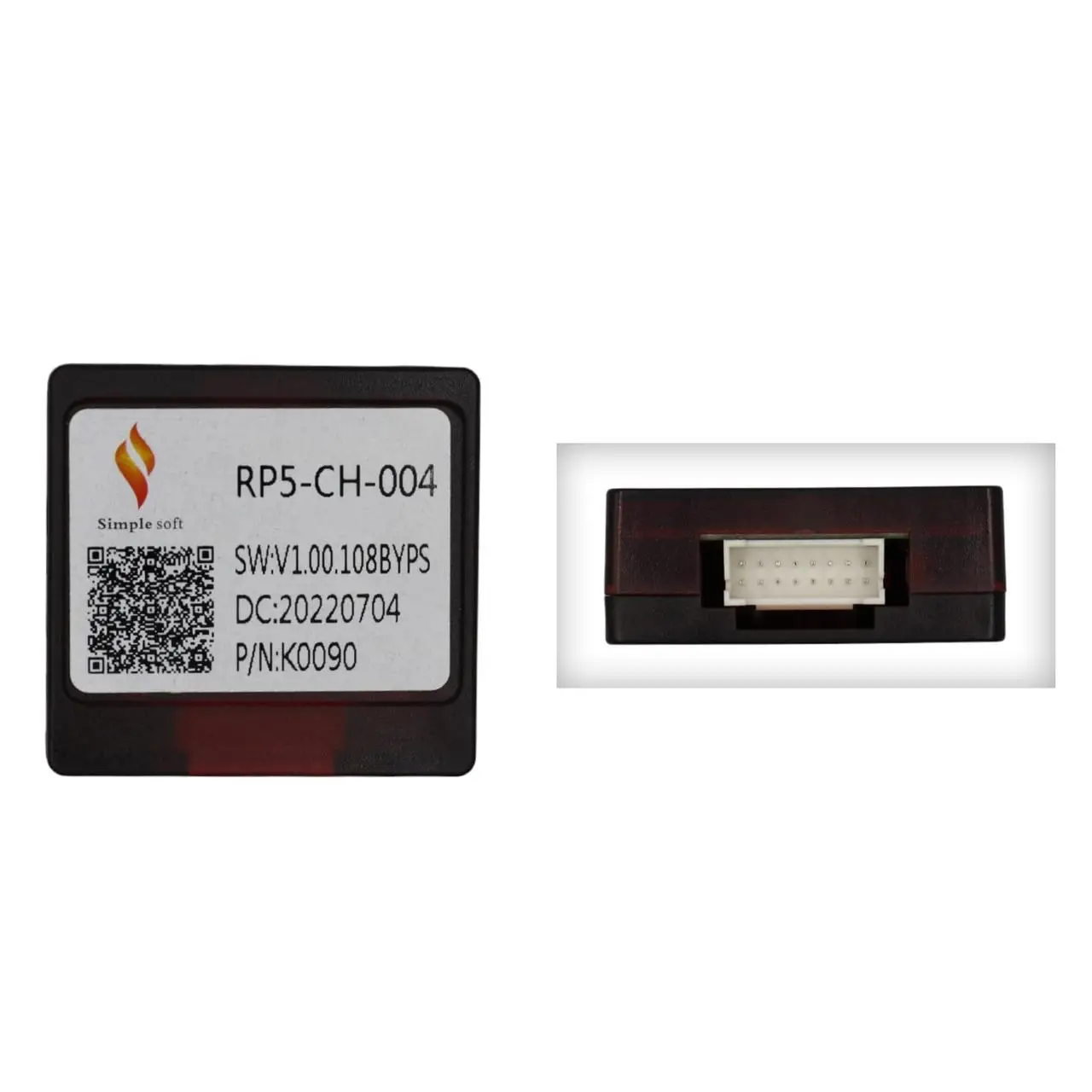

I have a Chrysler 300C 2006 and recently installed a head unit running DUDU 5. I’m using a CANBUS adapter Simple Soft RP5-CH-004 (see attached photo).

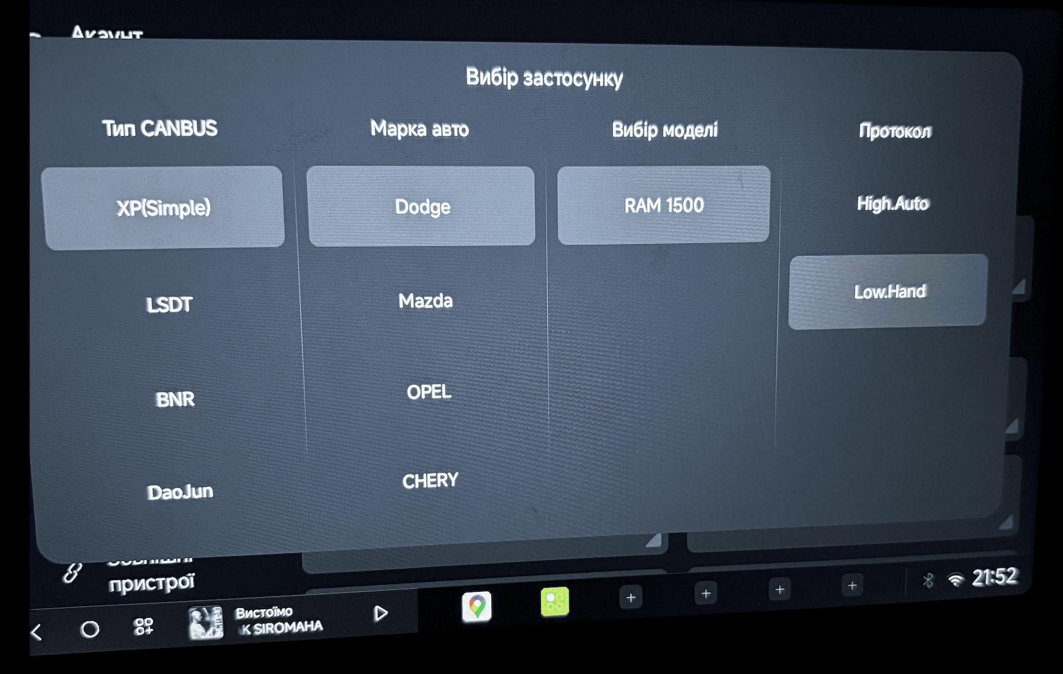

The only configuration that partially works is:
CANBUS type: XP
Brand: Dodge
Model: RAM1500
With this, steering wheel buttons and the factory amp work, but other features don’t.
