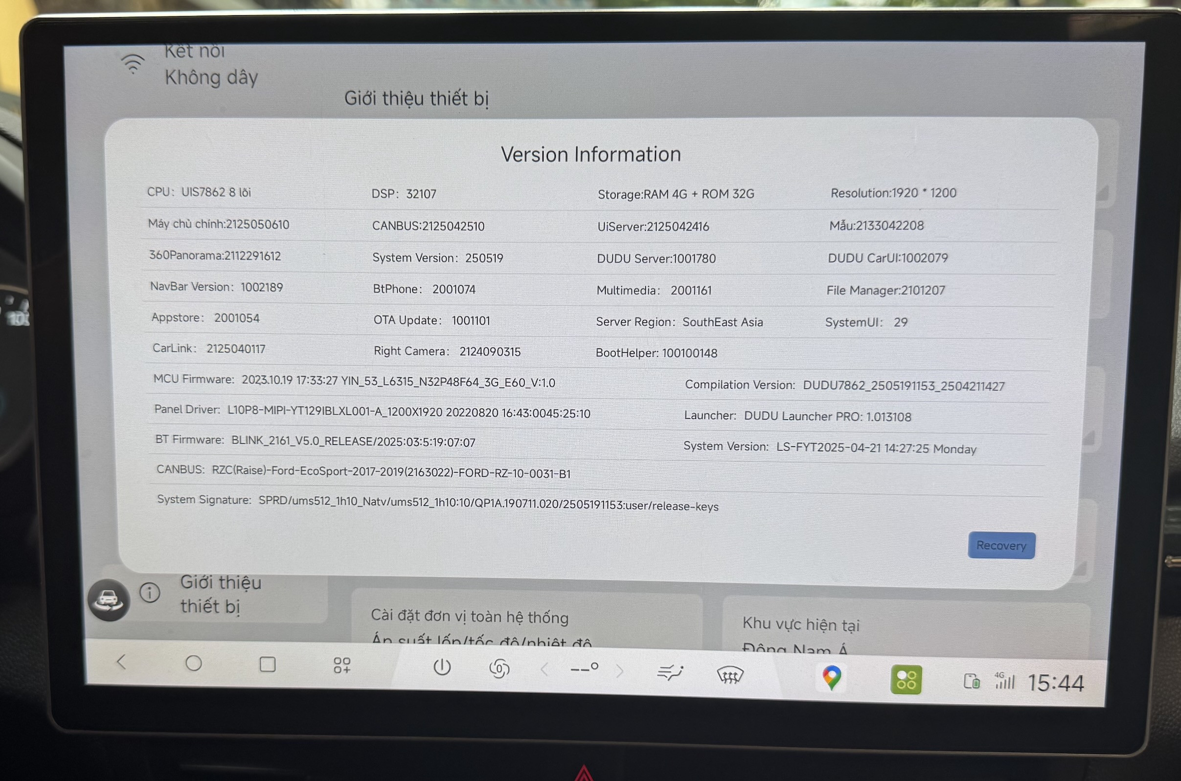

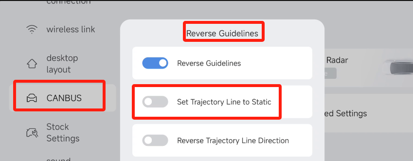

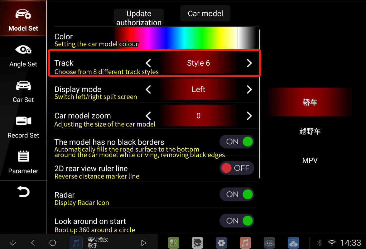

Thank you for your suggestion. I have already checked and confirmed that the setting you mentioned Track Style is enabled.

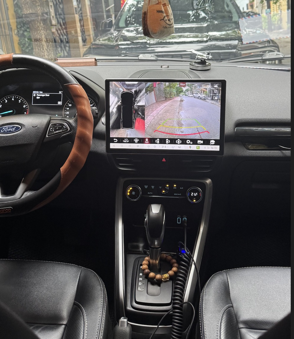

Despite that, the dynamic trajectory lines on the rearview camera are still not moving with the steering wheel.

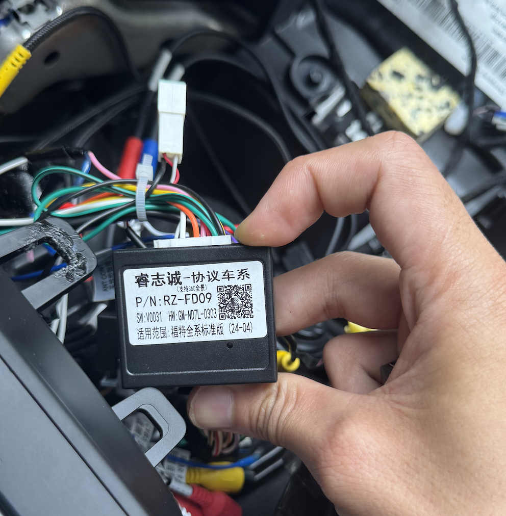

Since all other CANBUS data (like A/C, doors, TPMS, etc.) are working correctly, it seems the connection is fine.
Could there be any other reason or setting that might be causing the dynamic lines to remain static?
