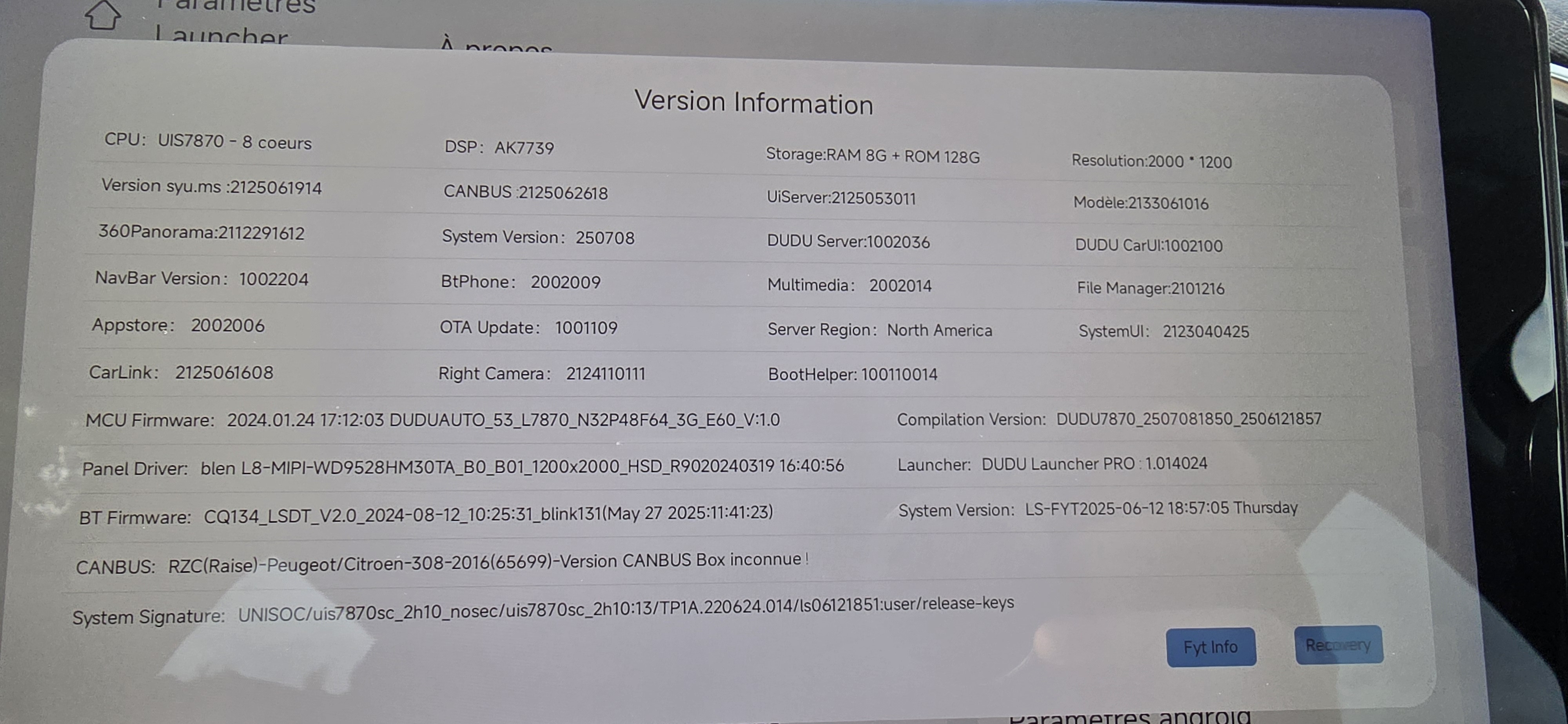

On Latest DUDU OS 3.6E Beta.

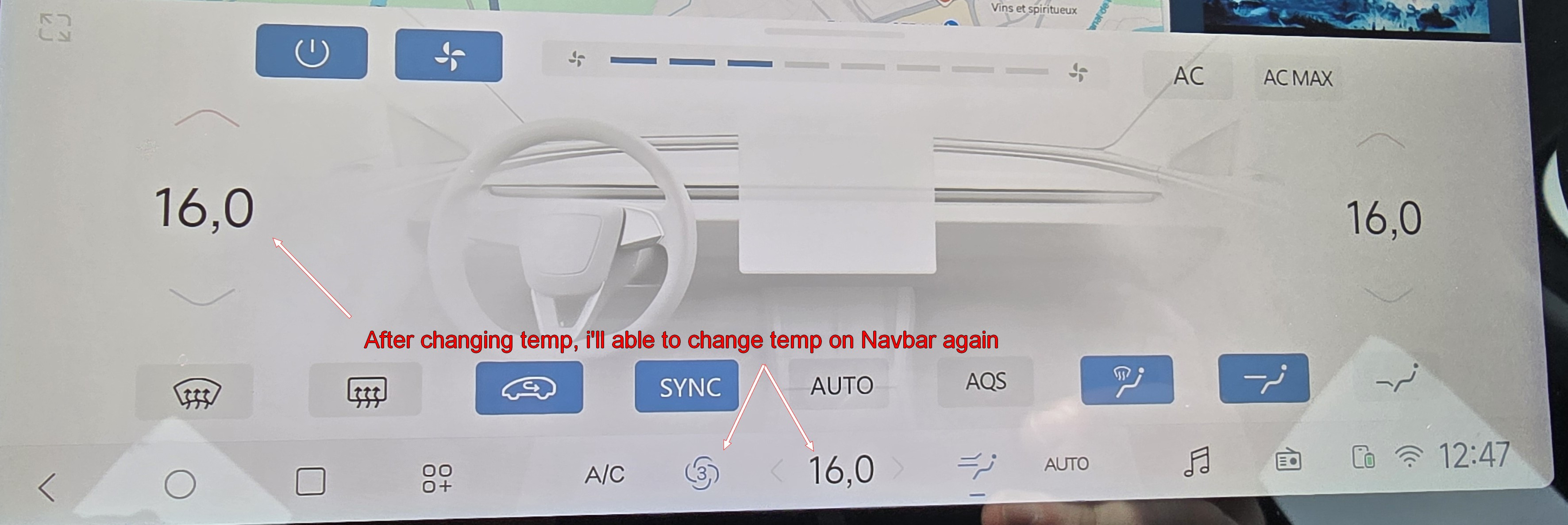

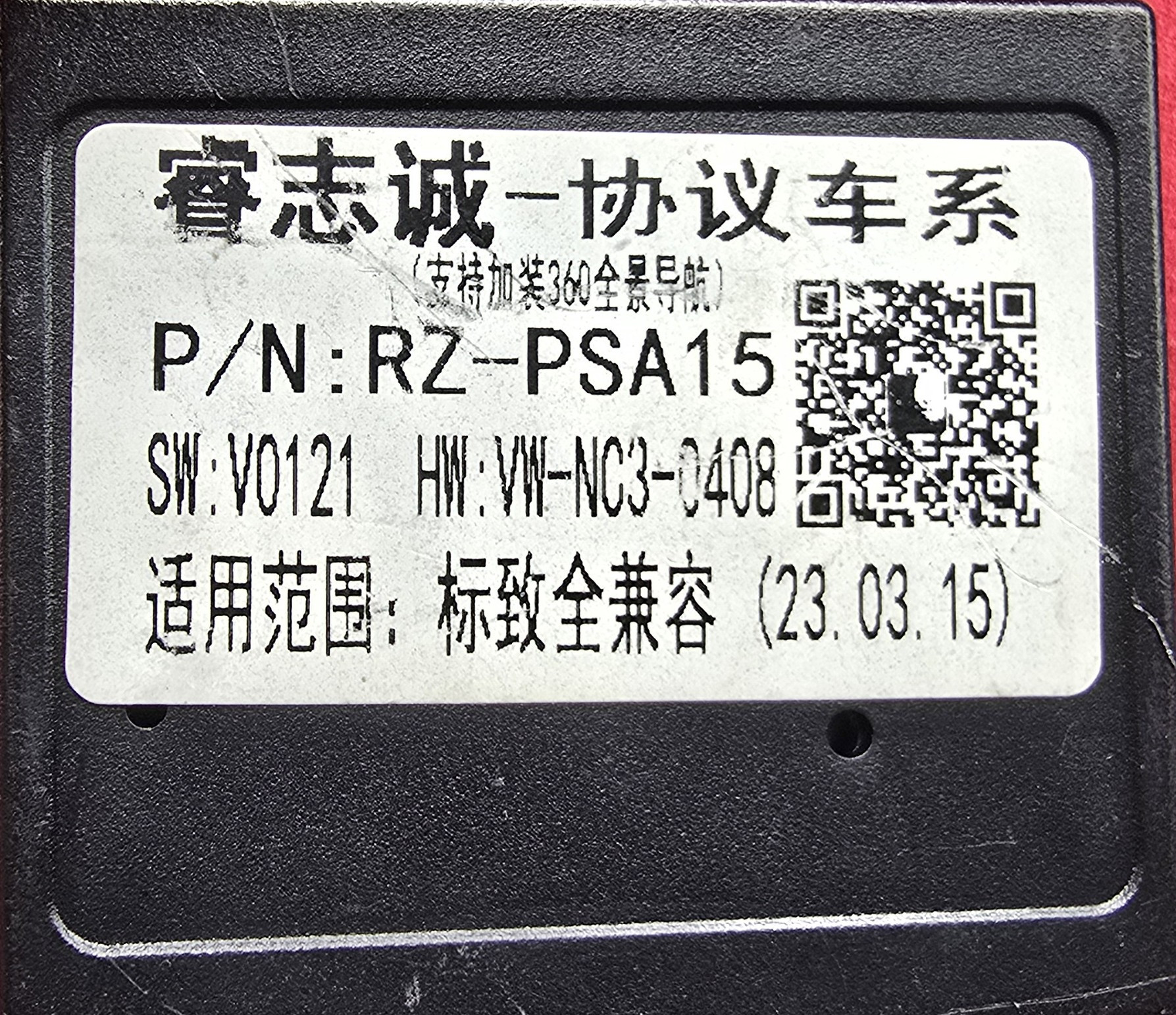

I have an issue with A/C Control on Navbar (Peugeot 308 T9 2014, Raise Canbus Box, RZ-PSA15).

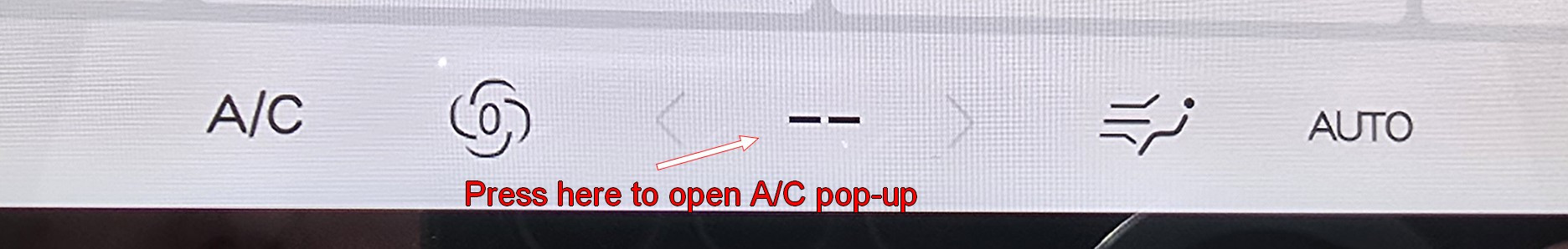

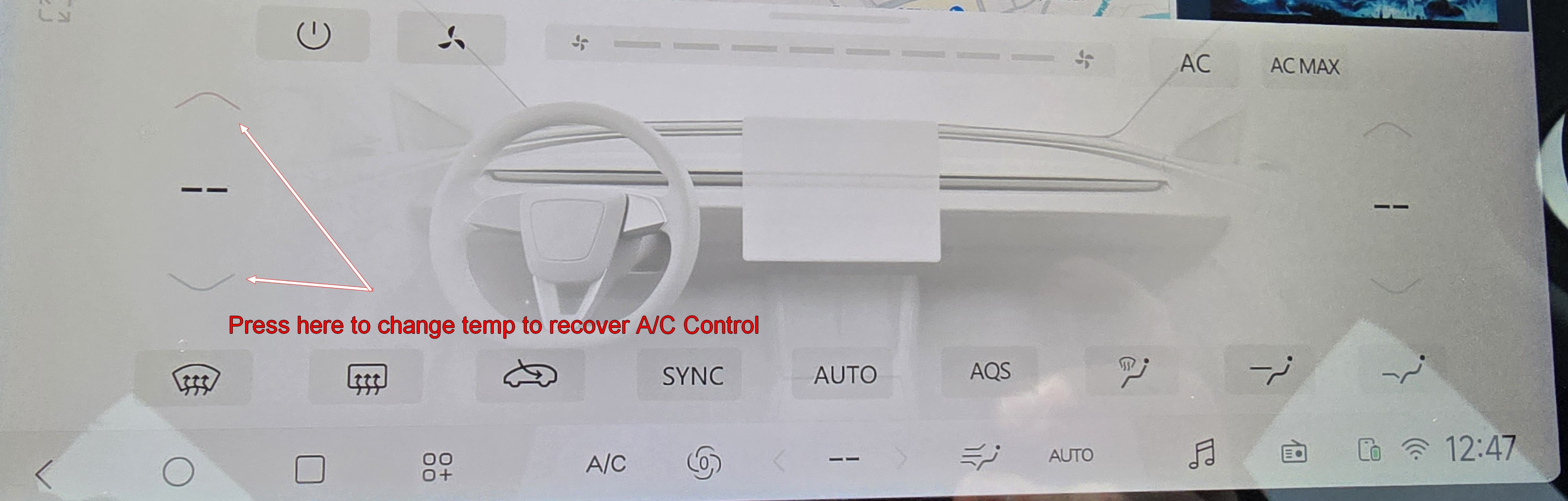

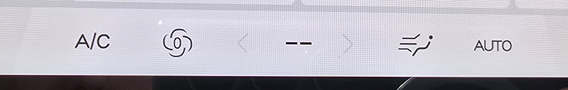

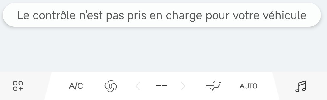

When unit turn in sleep mode and wake up for couple of hours, i can't be able to control A/C with navbar, the button does not respond (and message "A/C Control not supported"):
I have to open A/C Pop-up and change temp to recover control:
After changing temp, A/C Control is recovered and i finally able to control A/C on Navbar again:
If i don't do this, i can't control A/C on Navbar, and message "A/C Control not supported" appears when i try to change values directly on Navbar.
Is it possible to fix this ? Save the state of A/C Control before sleep to quickly recover ?

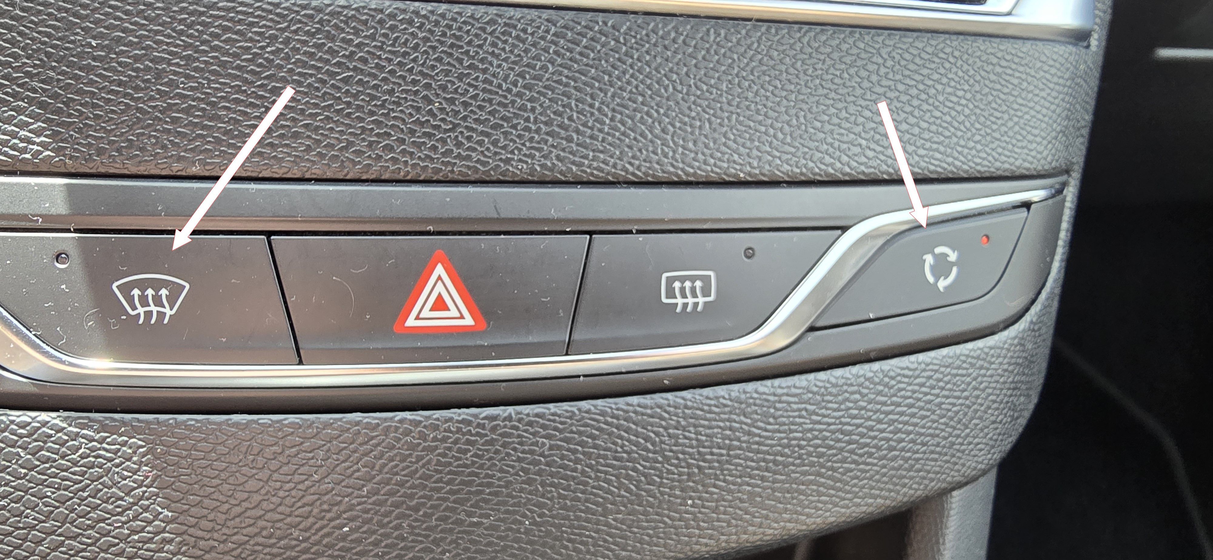

Another question:

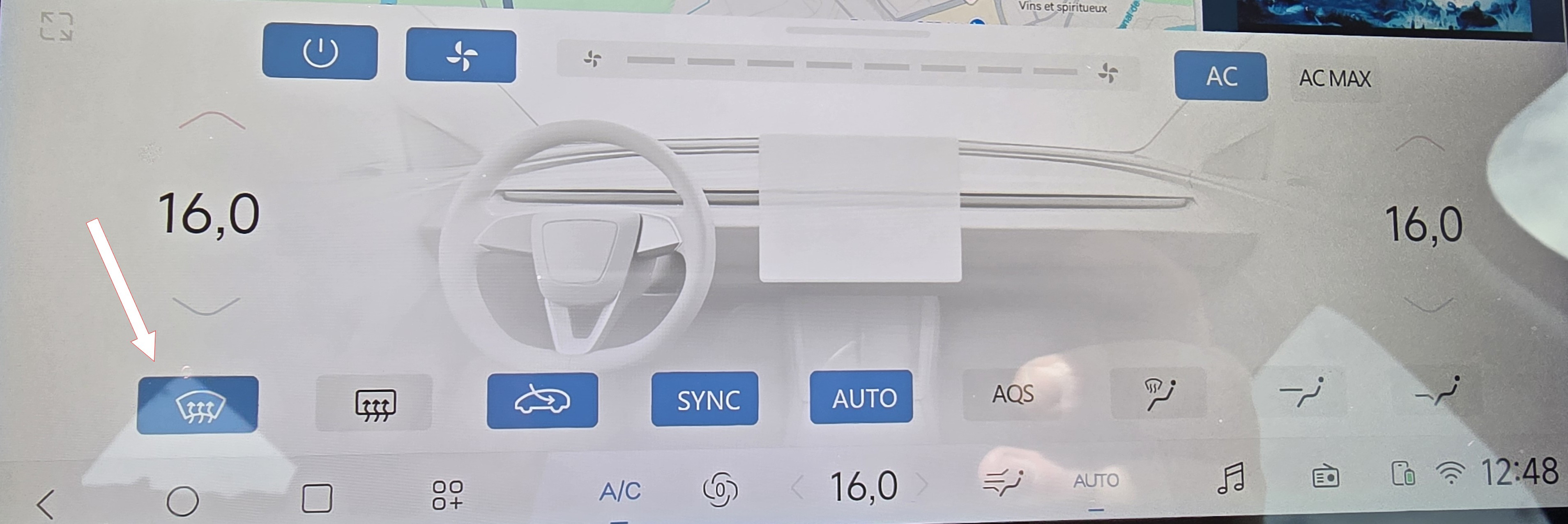

For front defrost, when i press this button:
A/C Pop-up open to show information, which is very good.

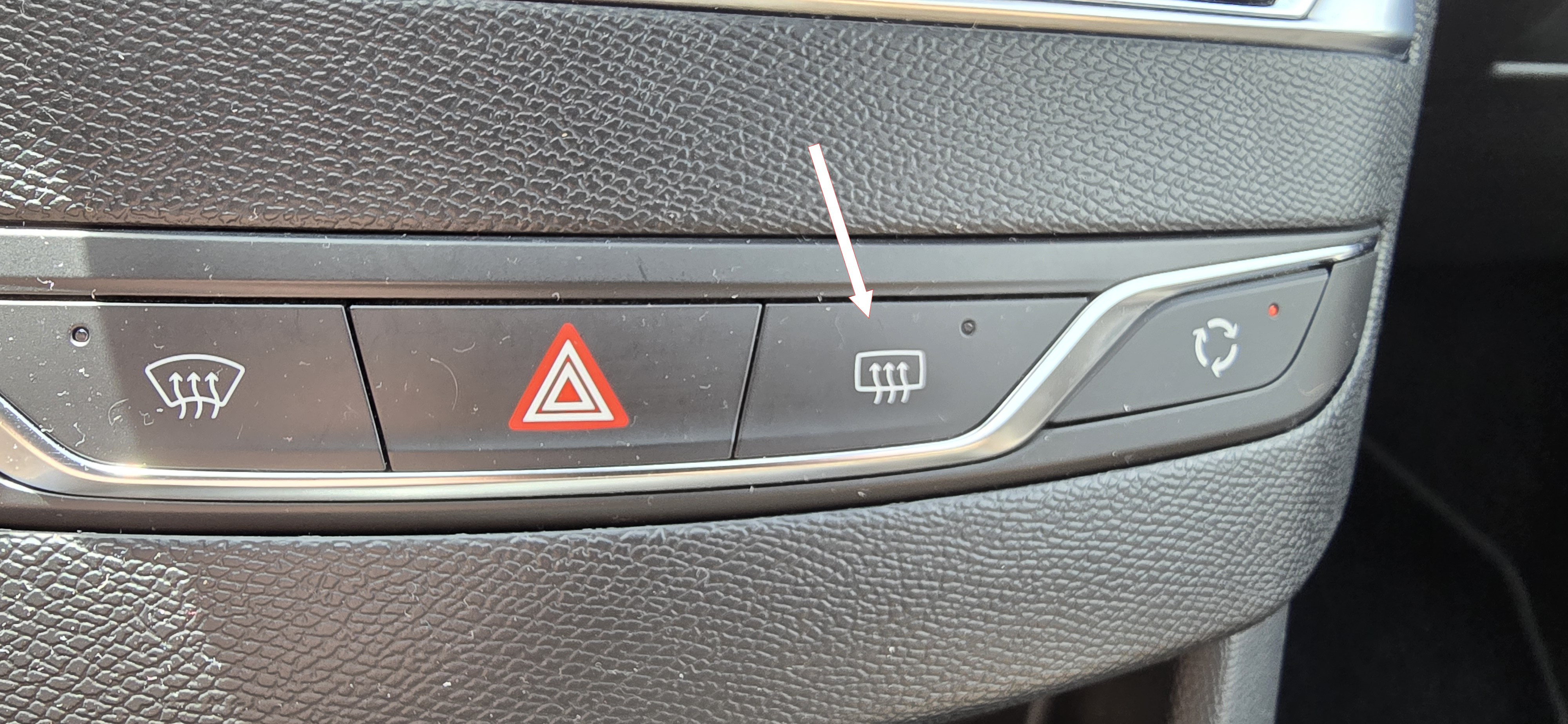

But for Rear defrost, nothing happens:
Rear defrost is activated, but pop-up don't show.
Is it possible to fix that too ?
