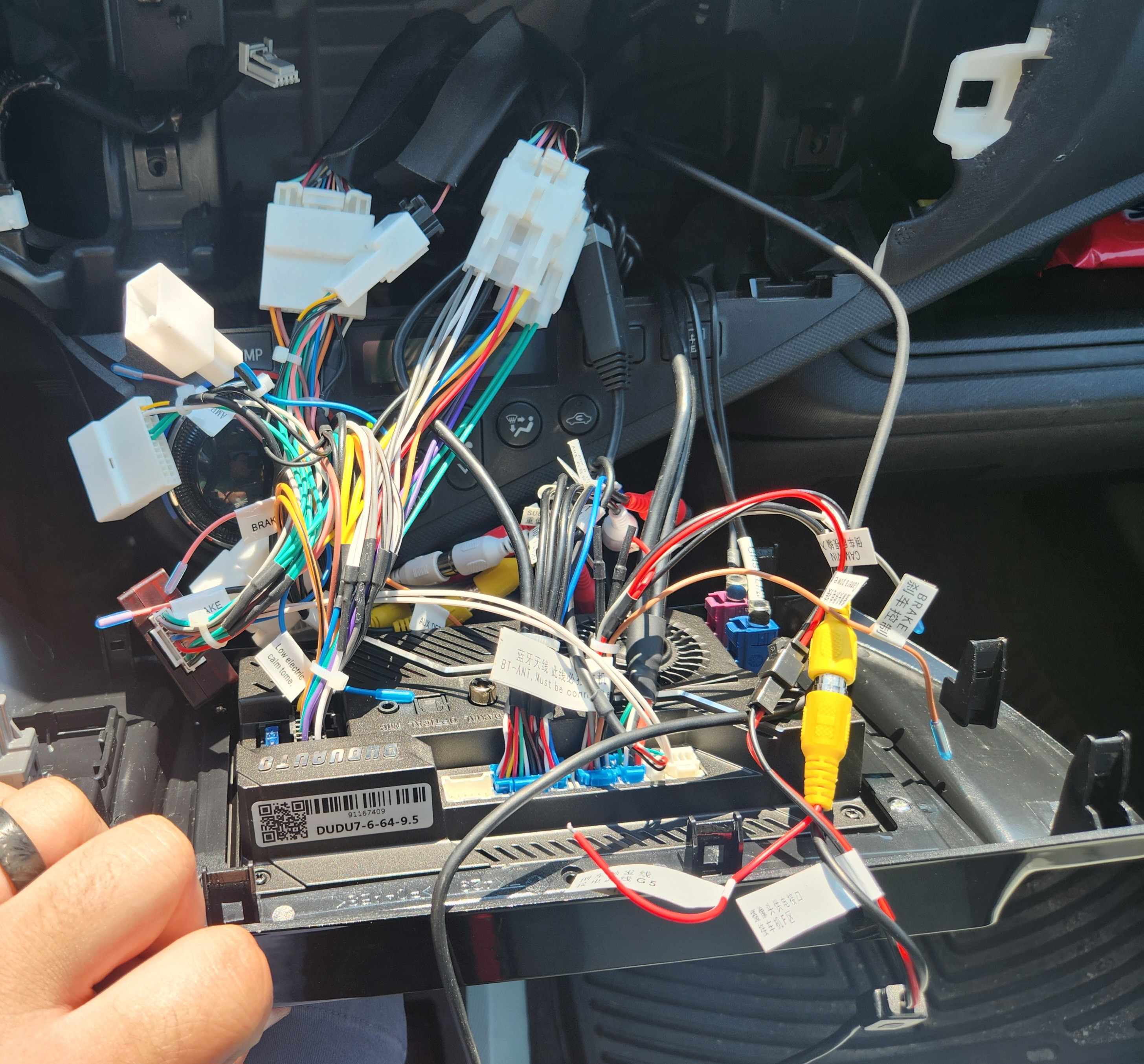

I recently installed the Duduauto reverse camera in my 2013 Toyota Prius C with the Dudu7 HU and am having problems with getting the camera to trigger the software when putting the car in reverse. When I load the standard "Dash Cam" app I can see that the video is working perfectly.

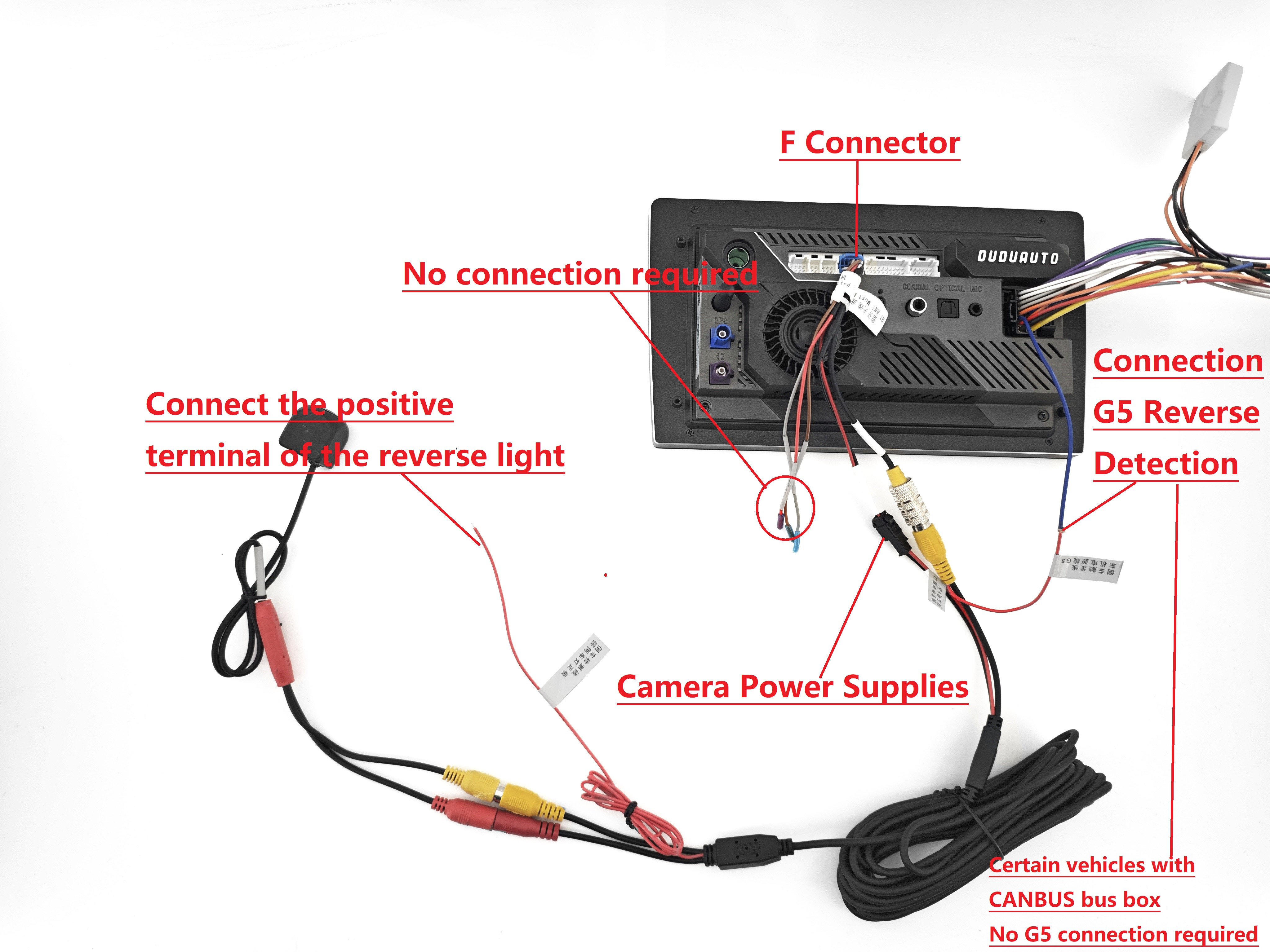

I believe that it's because I don't have the trigger wires wired up. The question is, do I need to wire in both trigger wires (one near HU and one near camera)? Is there just a simple software fix?
Any help would be appreciated, thanks!
