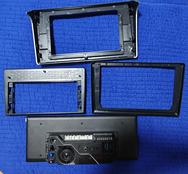

i have a 2025 Rav4…which has brought another level of Toyota changes that Mekede is not familiar with..

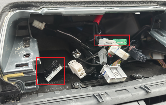

i ordered factory schematics, so i personally understand the wiring changes that we are dealing with …
i bought several older model rav4 headunits, so i could put together my frames…so..fit wise i have complely resolved that part…i now have full SWC canbus integration..including headunit A/C control,
which i was not expecting…only thing missing is the factory reversing integration…
i have a 3rd or 4th harness showing up the next few days that should fix that..fingers crossed…
Actually, correction, i think i purchased over 10 different wiring harnesses, b4 I figure out on my own,
what works with this car .
