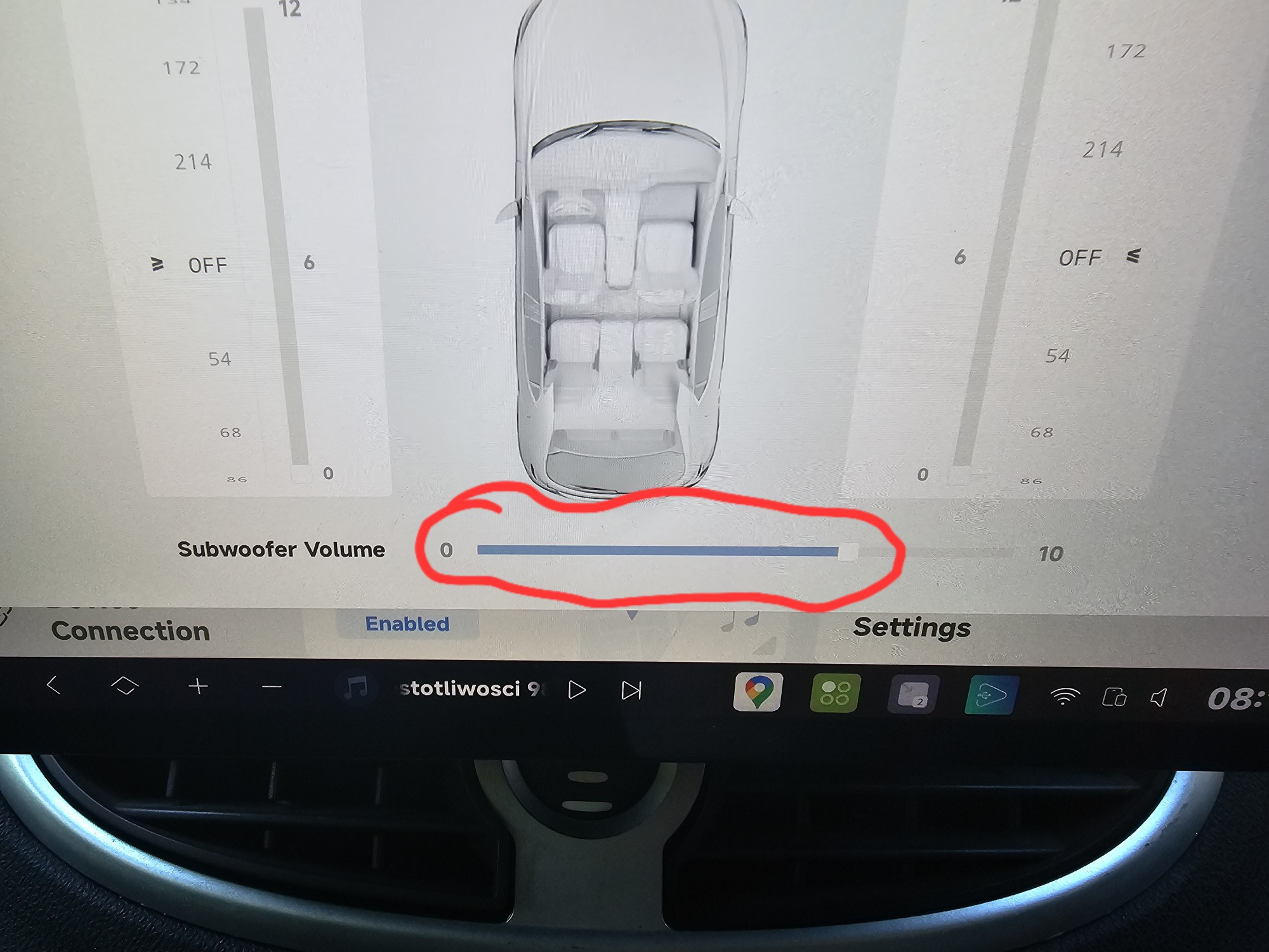

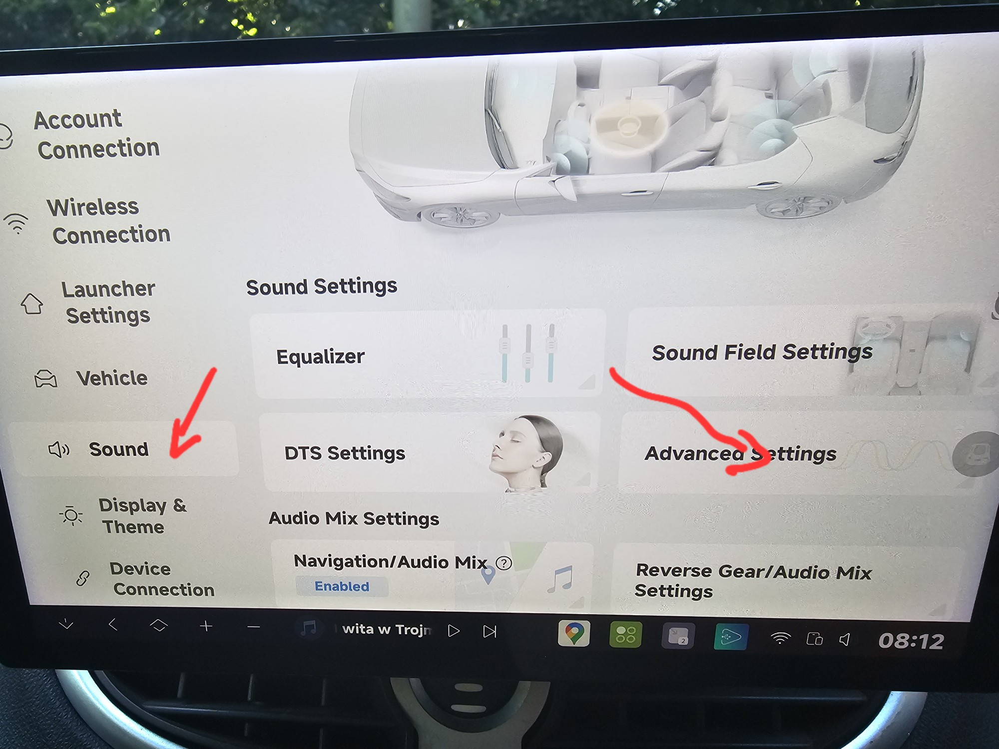

Mikescotland Jetty_88 What is the model of the amplifier? When you have your amplifier in 6 channels mode, connect either left or right channel from Dudu7 to the subwoofer input of you amplifier and check if something comes out of the subwoofer. This is to check if the amplifier works fine in 6 channel mode. If it's fine (if you hear any sound from the subwoofer go to no. 2) Reconnect the subwoofer input from dudu7 to your amplifier. Check settings in Dudu7 like on the pictures I attached.
