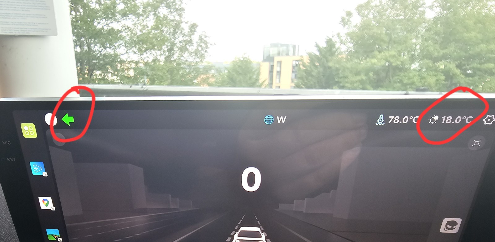

- On DUDU7, I have water temperature available on both - ELM OBD and canbus (Vehicle Info)
- When ELM connected, on the status bar I have water temperature

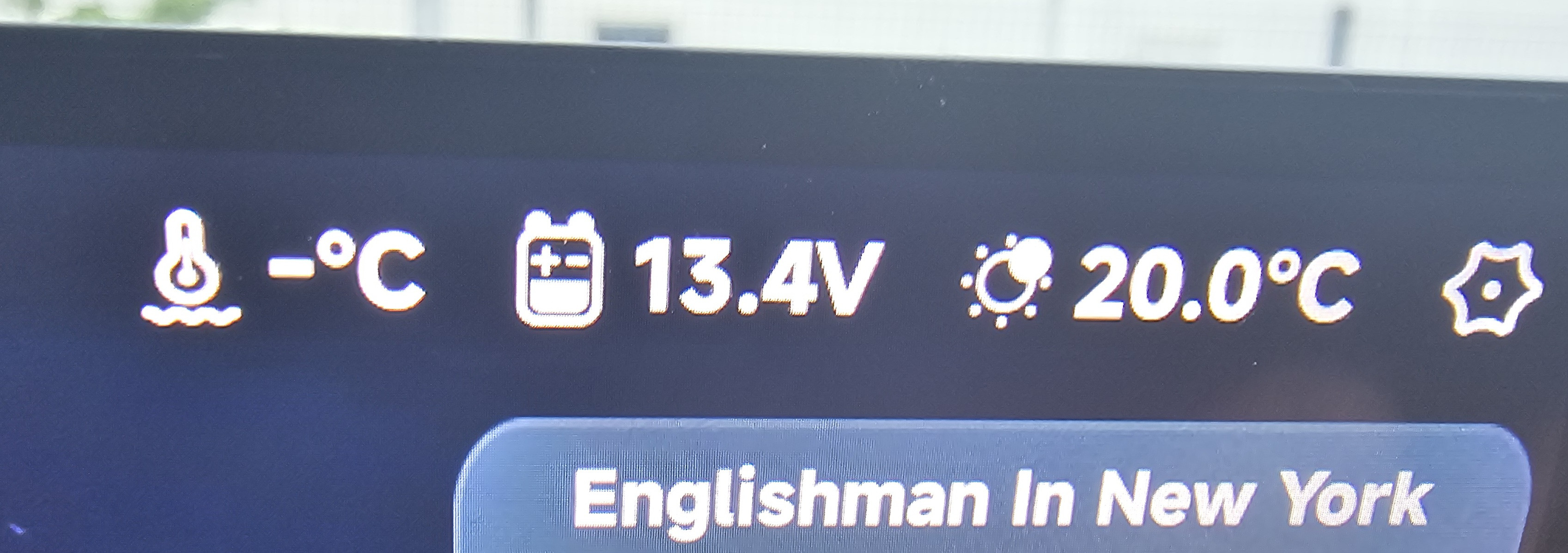

- When ELM disconnected, and in DUDU settings everywhere set to "prefer CANBUS" over GPS and OBD, there is no water temperature on the status bar
- Water temperature is still available over canbus - as shown in the "Vehicle Info" app on DUDU.
Problem: Status bar takes ONLY water temperature from ELM OBD, cannot take from Canbus, even if it's present.
